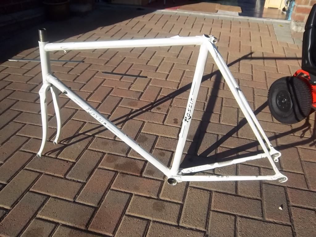

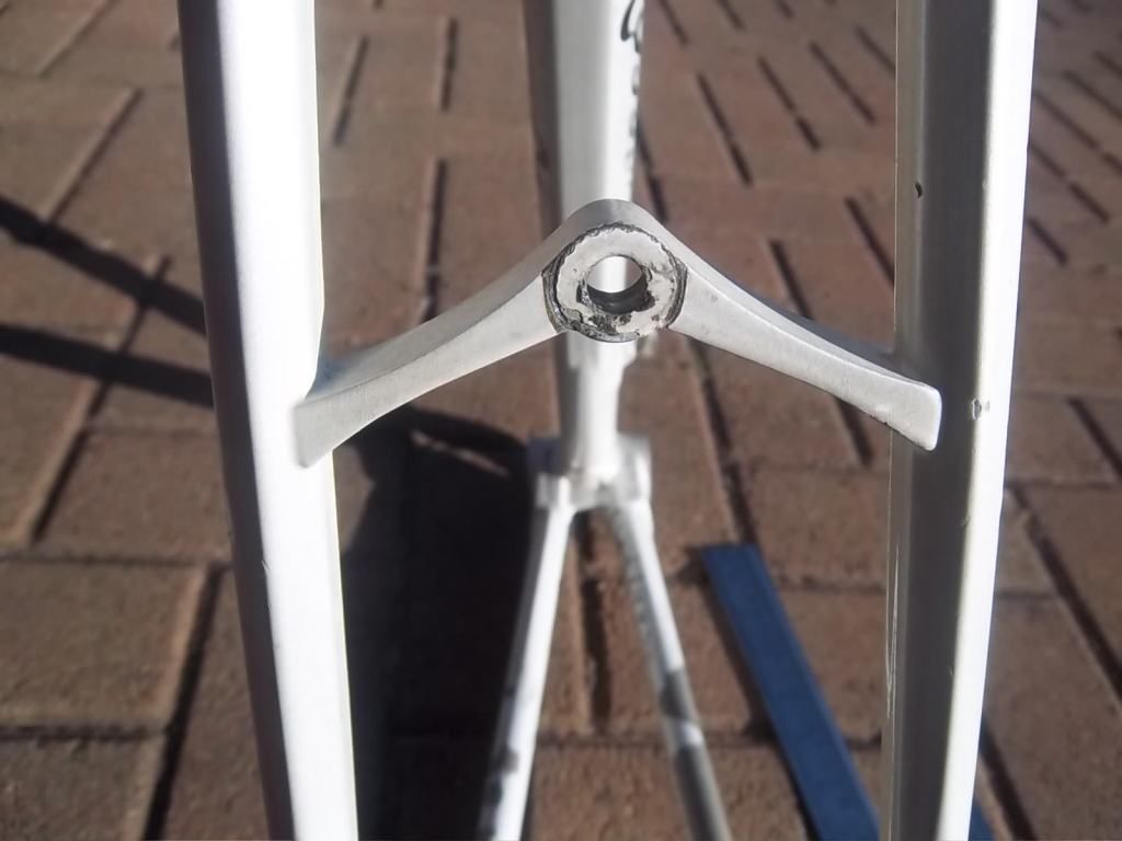

Hi all,

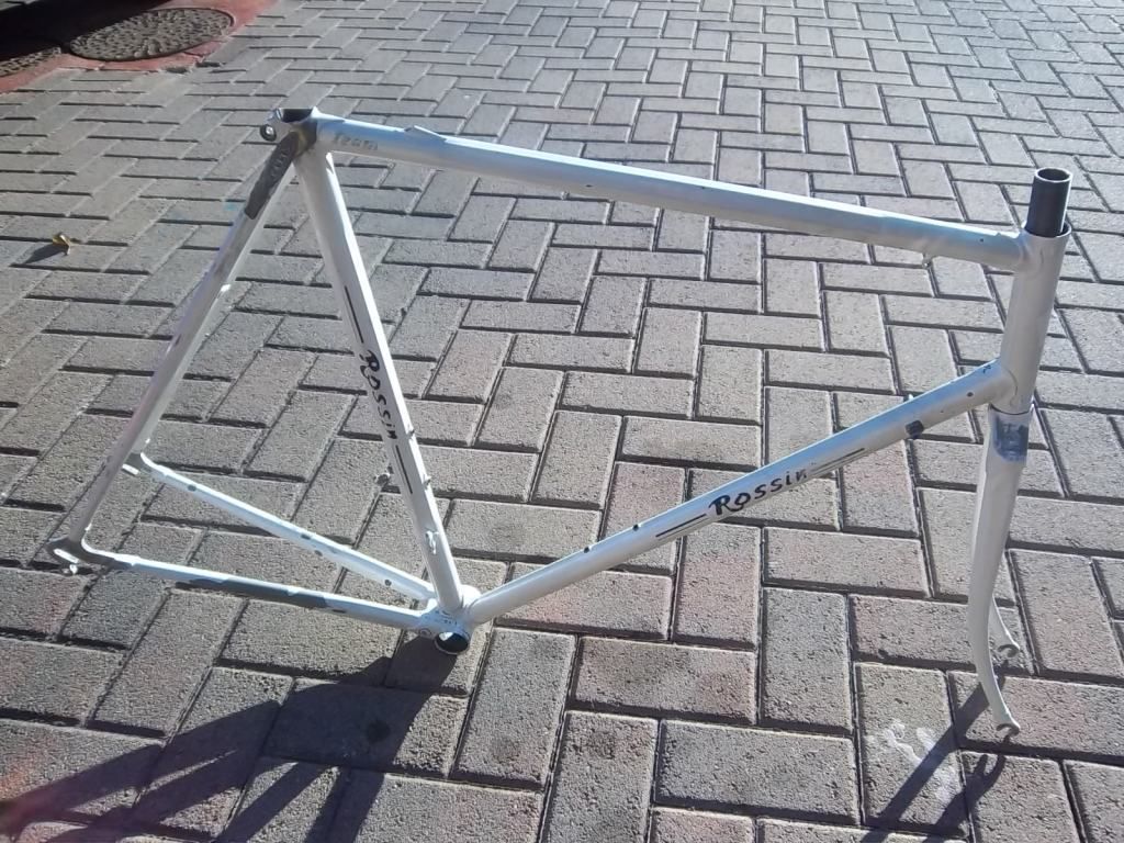

Quite a few of you may know i have a Rossin Prestige Team frame which i acquired from an RB member last year. I have been doing some research in an attempt to date the frame before i commence any restoration. I have gathered up quite a bit of info (thanks to Deax, ScillySuffolk and many others - i better mention Mr Raleigh too!!!).
Here are a few pics to give you the idea what the frame looks like -
It seems Photobucket is acting up - i will post more later.

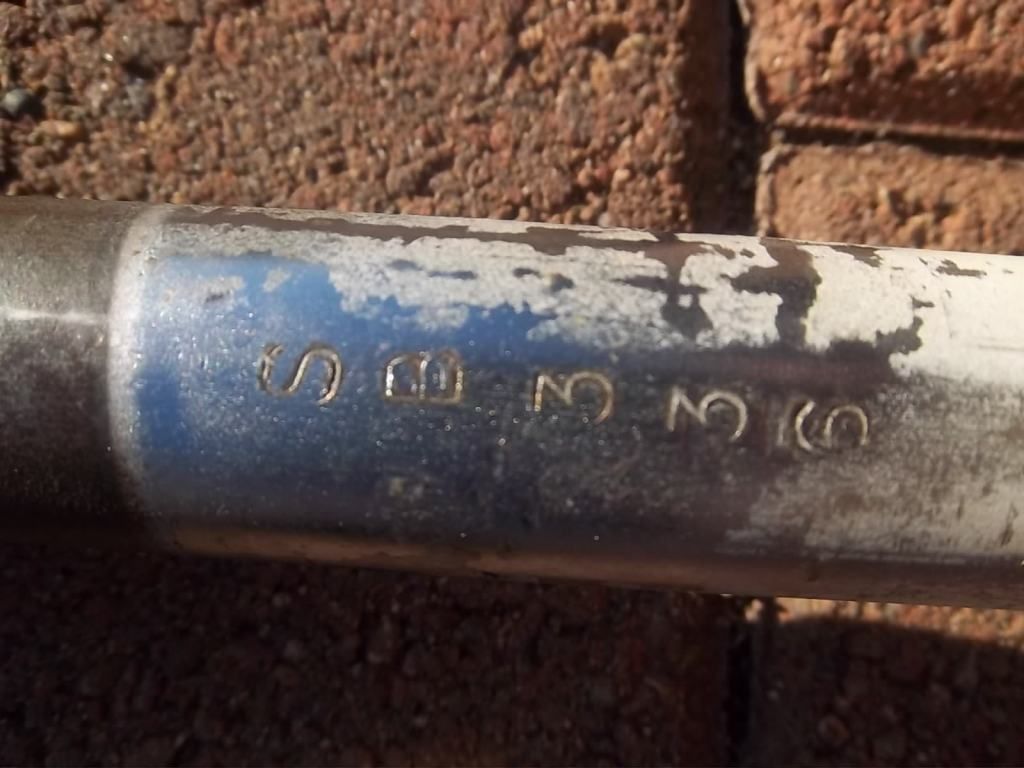

I have spoken to Rossin and they have advised that the frame is a team frame and they believed that -
"I've found a technical person that has been working here for a long time, and he has provided me with more information after having seen the pictures you sent:
a. This is a frame that goes back to the mid 80's, and it is a frame that has belonged to a professional team.

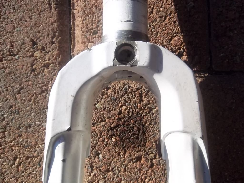

b. The number on the fork proves this: this number used to be inscribed in the forks over the years, until the frames became lighter and therefore the number was moved to beneath the BB.
c. This number may be the initials of the rider or of the team.

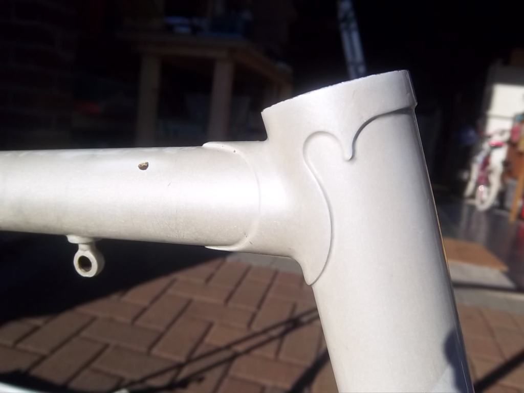

d. Also the little round metal part attached to the TT near the HT proves the team theory, as this is where the racing numbers were attached.
e. The team might have been Murella Rossin"
I have done some research on the teams but came to a standstill as i don't believe that the info is on the net - perhaps (and i stress PERHAPS) the frame was used by a rider called Stefano Bizzoni who rode for the Murella Rossin team in 1984 and 1985. I think i saw a team list for 1987 which he may have been in - but i have lost the links to this. I should add the forks have 'SB 336' stamped on them hence the focus on this rider.
If anyone has any knowledge of the race bike and/or pics etc i would really appreciate it. There are a few on google but the bikes are not the Prestige.
The Prestige is made of Tange Prestige steel with hexagonal tubing and was available to the public in 1992 (maybe 1991). It was available with Campagnolo Chorus RS or Shimano DA -
"Chorus RS is the second generation C-Record era Chorus group, strictly speaking RS is 1992 only: the RS prefix was dropped for '93 and '94." - thanks to Scilly Suffolk for that info.

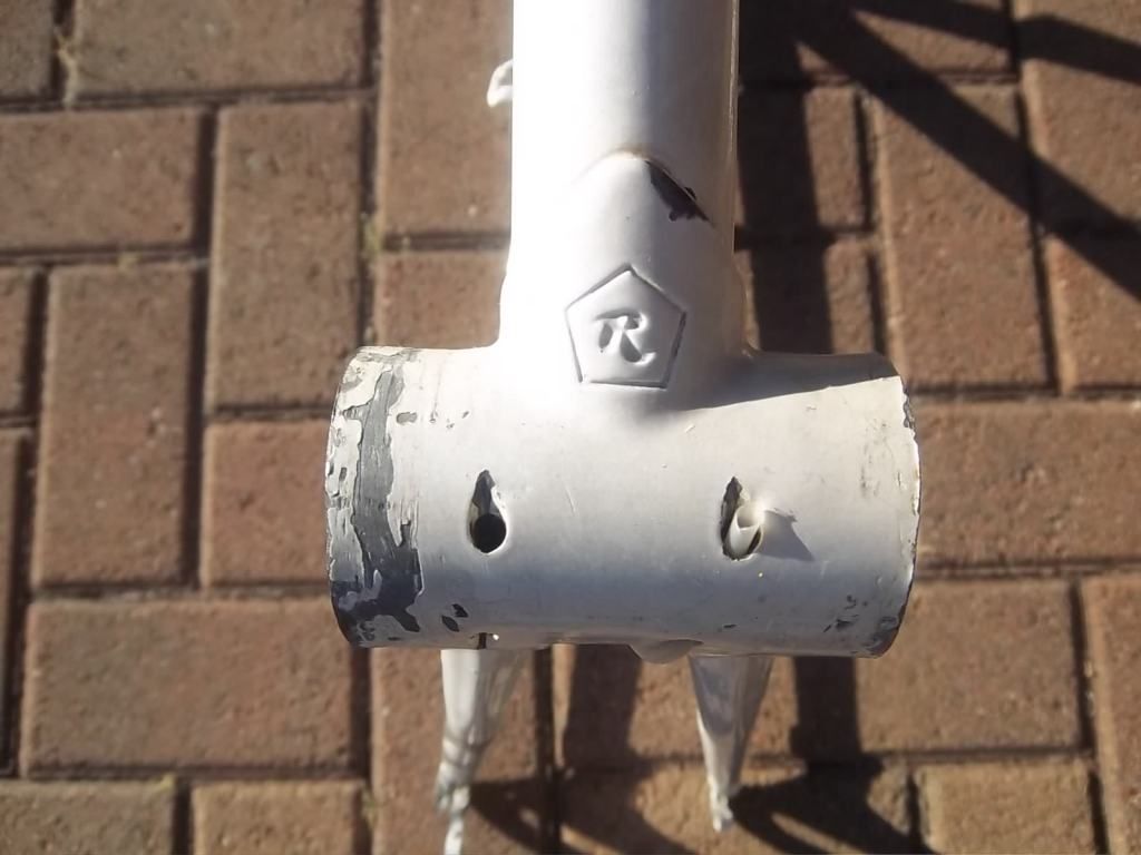

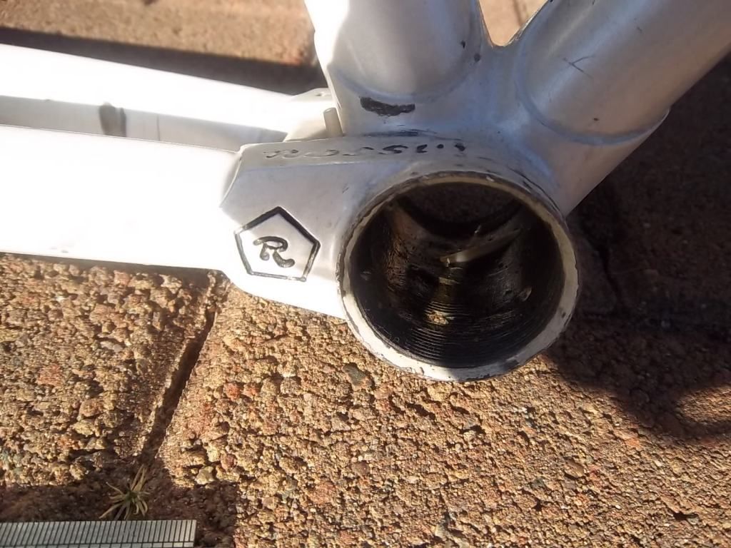

The BB has not got the cut-out Rossin 'R' and the cables go through the BB. I have seen a pic of the Rossin brochure for 1987 - 1988 which shows my style of BB.

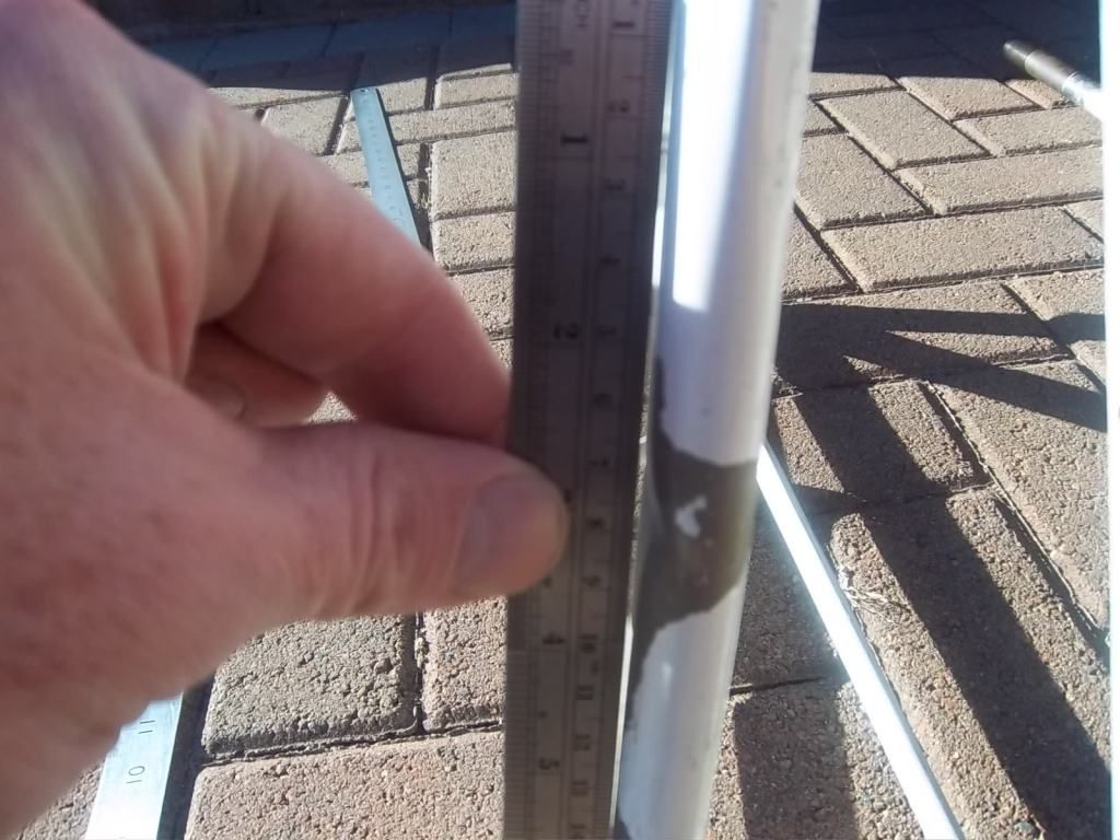

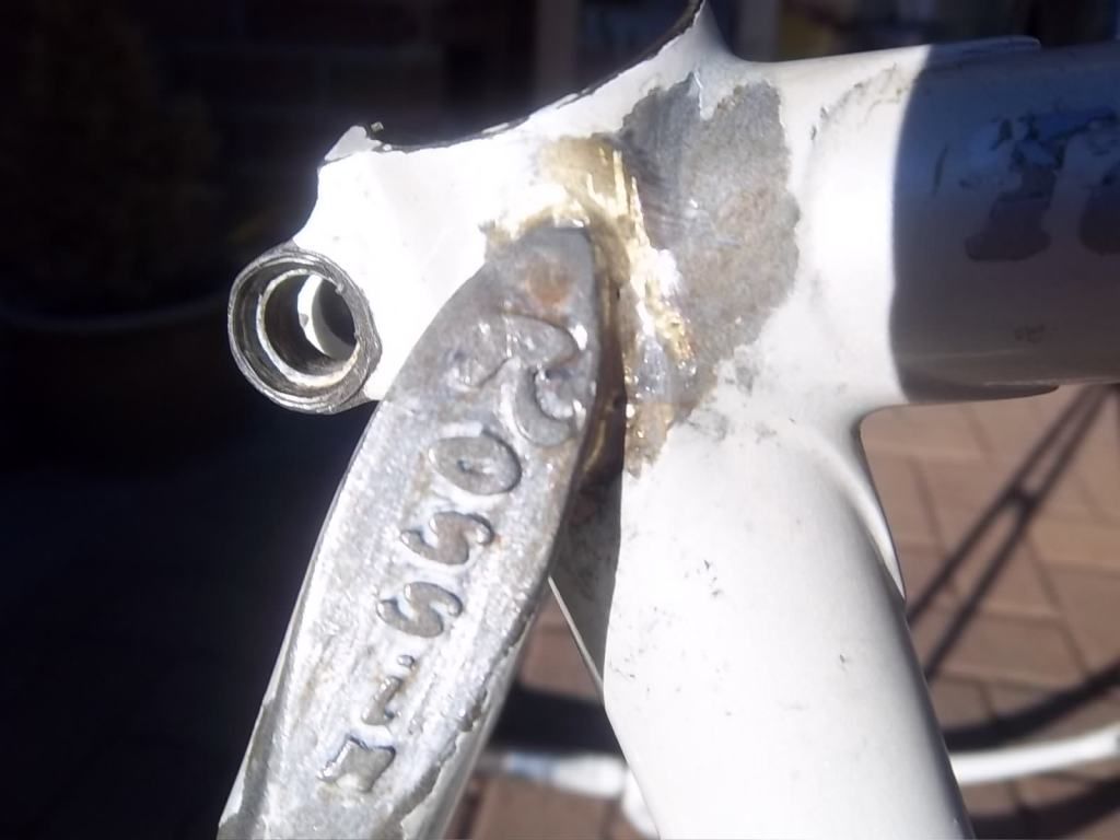

The rear spacing is 130mm exactly but, and here is where it gets odd, there is a dent (not a ding, a dent) in the chainstay and it might be the case that this was done to increase the width. When i decide the fate of the frame, this can be repaired. I doubt that it would be easy to get the chainstay replaced. Rossin were not able to say when they changed their spacing.
My theory is - this is a 1987 Murella Rossin Team bike but the spacing may prove this wrong (provided the dent was made to increase the spacing) - i originally thought it was 1983/84 but that seems too early - if it was raced before public release that would be a 9 year gap which seems excessive. The later Murella in 1987 makes more sense, but i could be completely wrong!!
So here is the plan -
1. Try and find out a date for the frame
2. If it is Murella - restore it in their colours
3. If the above fails, restore in a paint scheme of my choice
The frame has no chrome on it, apparently to keep weight down, i would like some chrome on the build and i have seen some great paintwork on the Mercian site. This is a long (ish) term build, i have a few other projects to complete before i actually begin this. I have gathered up an almost complete Shimano Dura Ace 7400 group set and once painted this will be a quickish build. No doubt there will be many queries from me as this progresses!!!!
Any info or pointers will, as always, be greatly appreciated.
Thanks,
Richard
p.s. more pics to follow when Photobucket works - grrrr

More pics -
This last pic shows the dent in the chainstay.
Like for like? unlikely. At the very least you will need to get that driveside dropout in alignment, judging from picture 5/8, before securing Dura-Ace on it, or between it and it's partner. Take a squint down the seatstays too, (with a camera, if you like).. I'm not intending to discourage, but IMO if that dent was done purposefully to increase rear spacing, it was done in desperation by a distracted person. Choose carefully who you get to straighten it out.. as far as that's possible..

Everything seems fine except for the actual dent; it may be the case that this was just a bad dent, but due to a lack of information i won't know for definite until the frame gets looked at by someone who knows. If the frame had an OLD/OLN of 130mm originally - it is a dent, if the OLD/OLN was less - it has been done deliberately. On a sepapate topic - i still have that item for you if you would PM me. Thanks.

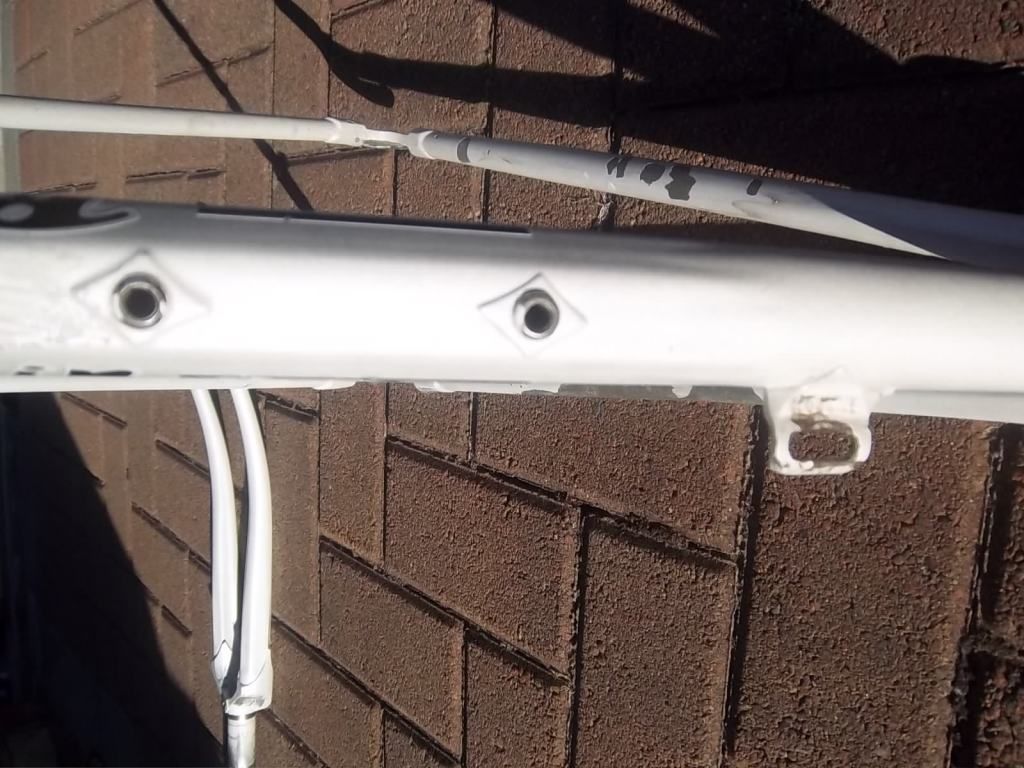

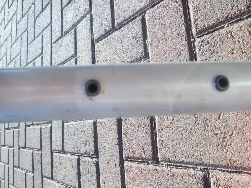

Another odd bit - the last two pics show the bottle mounts - the set on the seat tube are nicely done with a diamond but the down tube mounts look different - cheaper or rushed, if i am honest.

I wondered what had happened to this! It used to be mine - I sold it to someone on here, though perhaps not you TGR?
It certainly is a puzzle. Interesting response you got from Rossin, especially the SB reference. Although as you mention, it would be rather odd if were a mid 80's frame so far in advance of when they became publicly available. (When was Tange Prestige introduced?)
I'd always thought late 80's and did a bit of investigation around the dutch Tulip team who ran these. I gave the chap I sold it to some background that I'd dug up, but it was pics and team lists, nothing conclusive.
I'd say that as it's Japanese steel, a Japanese group would be fitting: my preference was for Suntour Superbe, but I never got round to that. I did briefly build it up with Gipiemme and found it an outstanding ride.
