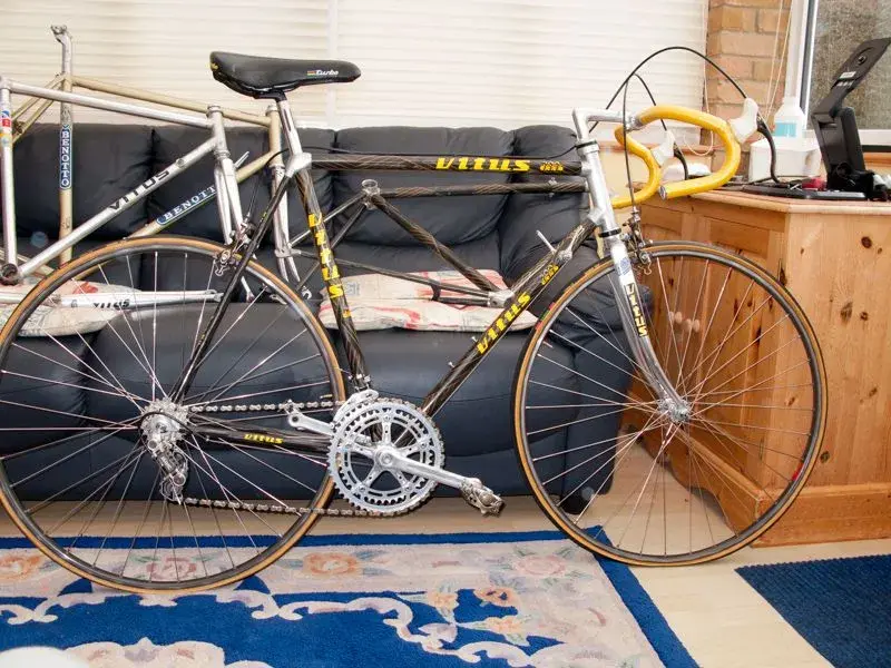

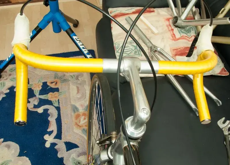

A 9 tube Vitus rebuild with full mavic Groupset.
Sorry for the poor photos but I did this in a real hurry.

Yes indeed he does , I have a composite factory in Australia and that tubing is actually kevlar and carbon fibres filament wound together . why does the seat post grub screw appear to be red ?
what saddle are you going to fit stringfellow ? I am on the lookout for a french reydel but may have to settle for a Hinault branded turbo for my Vitus I think.
The seat post fixing bolt is Rusty. I will be replacing it as & when. NB The seat post came with the bike & its 23mm, I've never seen one that small before on a quality racing bike.

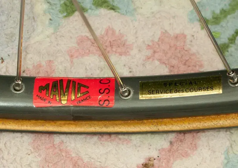

Yes this was a very tatty frame & forks when I bought it. I've very carefully rubbed it down with 800 & 1200 wet & dry removing all the old decals & lacquer. I purchased new decals & refitted them and then had my local car shop respray shop re lacquer the frame with 2 part lacquer.
Its been a long time trying to acquire all the Mavic parts that I need. I have some Mavic Paris Roubaix SSC rims that I've rebuilt onto Mavic 500rd & 550rd Hubs ,& now most other pars i need except for the pedals.

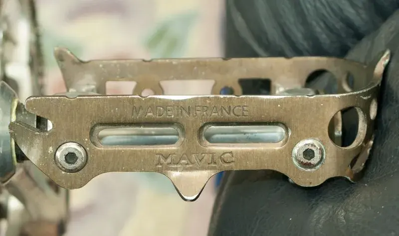

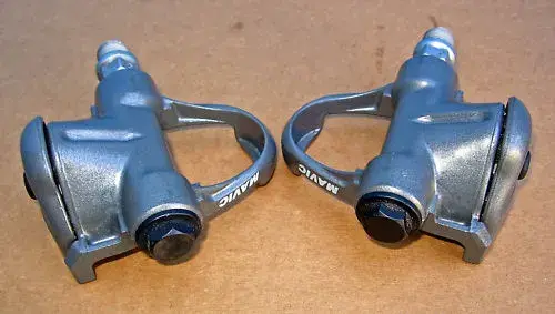

Joined: Mon Jan 15, 2007 12:12 am
Posts: 1600
Location: Gold Coast Australia
I am still trying to buy a nice set of these !
