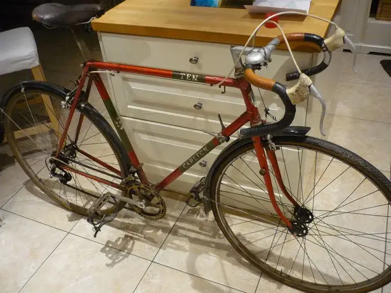

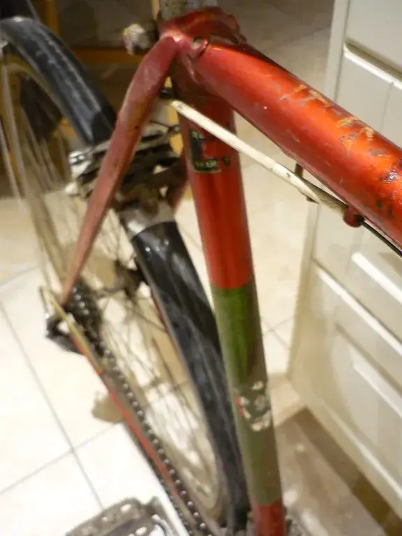

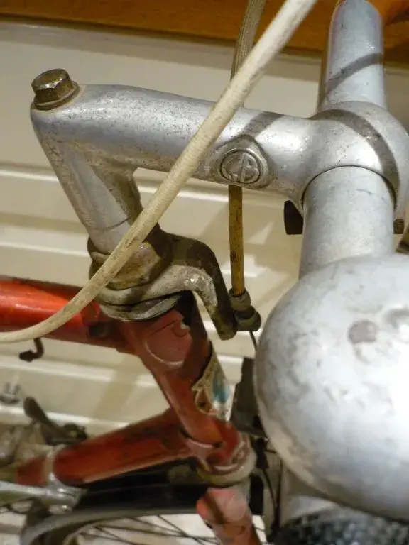

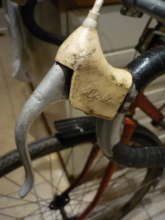

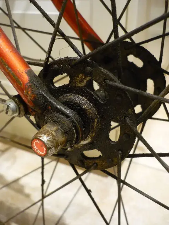

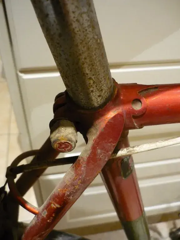

I bought this along with the 1955 F.R. Russell that's in another post. Its not been touched yet as you can see :lol: Seems to be a fairly rare model from around 1970, I've not found a huge amount of info on the net. Some of the components may reveal a better clue to the build date. Reynolds 531 frame and forks all in need of a serious scrub and polish but appears to be all original including the crap! One to bring back from the dead. Here's hoping the Carlton experts are around for a bit of input :)

Looks nice under all that patina.
Will keep an eye on the thread to see how it fares, I imagine it will come up superb.
Whats the plan?

Beautiful!!! I have been looking for something just like that for some time, nothing beats a vintage classic. Love the brooks.

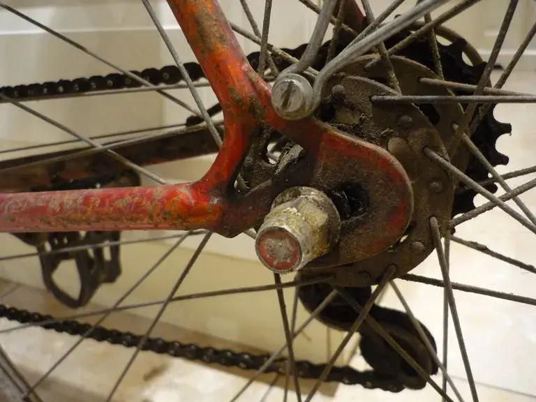

I don't know much about Carlton seems only Raleigh was imported to the States but those lugs are quite pretty. What in the world got on those hubs it looks like axel grease for a commercial truck.

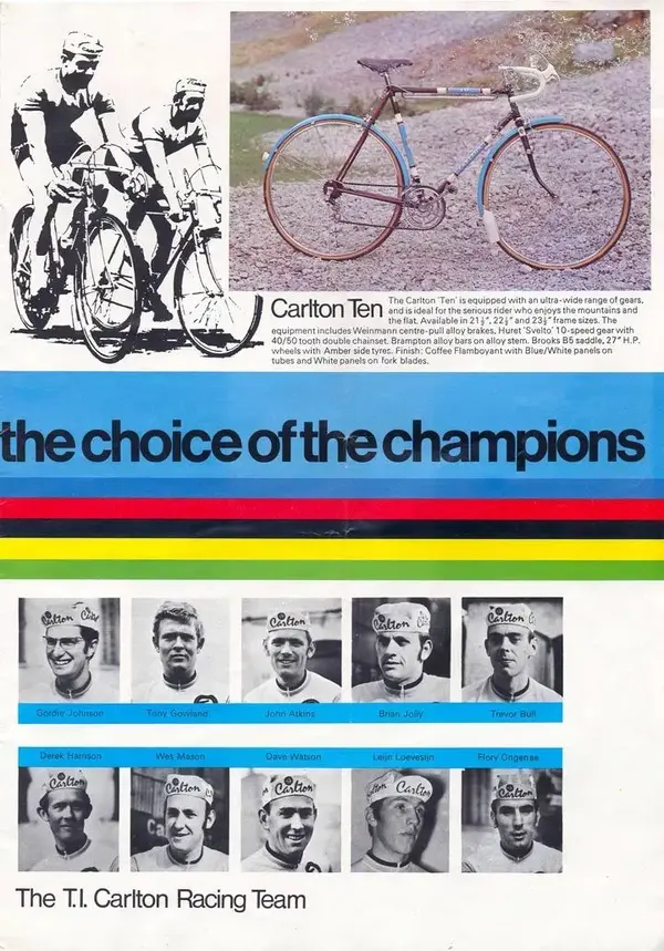

Strange mixture of parts, the 531 Capella lugged frame says on or before 67 or maybe a little later, ie using up old lug sets. The components like the 3-pin crankset say later. Its possibly been updated over the years. Great looking mount though and they do scrub up well. The flam copper paint is very nice. Large flange hubs are a nice touch too!
Here is one from the 1973 Raleigh catalogue...

Yours looks good for about '73, as mine is earlier, and has wrap over rear seat stays, and was not 531. The stem is right for that year, or there abouts. Yours also has a rear brake bridge, while mine was the old type support attached to the seat clamp bolt. The strange thing about yours, as Spokesman points out, is the lug work, which appears earlier, and throws the date into question.

The plan is to completely strip and clean, new bearings, new grease! New chain, tyres, bar tape..... This bike and the 1955 F W Russell came from the same previous owner, I don't think he believed in ever cleaning a bike!
Thanks for the 73 brochure Spokesman its a useful guide as to how it 'should' look. Interesting point about the crankset as well.

(Scroll down a bit) - you can see the more usual form of the frame ie the wrap over seat stays and Crespera lug set.

Lovely old steed. That Brooks should come up like new with a good scrubbin' of Dubbin. Mine was in worse nick and looked great after a good polish :)
