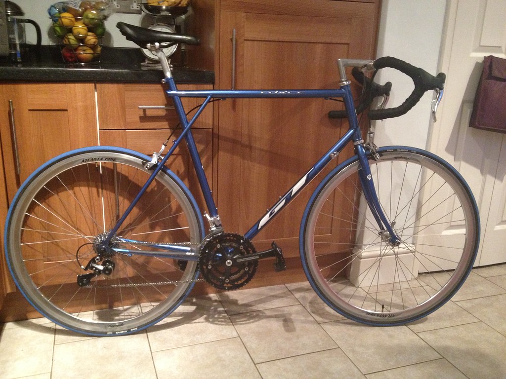

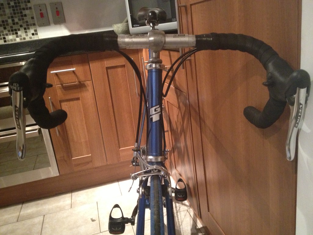

Not the most popular of the GT road line up but now built has found a spot in the Cave with my Edges . This bike came to me without wheels and sporting part of a Shimano RSX groupset which would have been original. Had a nasty alloy GT quill stem, nasty in both looks and the fact it was seized solid in the forks. Even after several nights soaking with wd40 it wouldn't budge. I had to cut it off then drill out the remains, all worked out ok. Needless to say everything has been liberally greased before rebuilding to stop future similar issues. Original plan was to acquire the RSX bits and some wheels to finish it then sell it on. I ended up recycling the parts off a long unused bike on to this frame, giving it a 3x10 speed Campagnolo Race Triple groupset. The Force frame has mudguard and rack eyelets on it, alongside the triple chainset will make it much more versatile than the Joe Waugh frame the parts came off. It's ended up a bit heavier than my other GT road bikes but its steel and the others are aluminium and titanium. The ride is a bit softer but still stiffer than other steel bikes I've ridden. On with the pics -
Before
Untitled by gtpulse78, on Flickr
After
Spec
Year: 1998
Frame (frame & forks): GT Force
Tubing: 4130 Cr-mo
Headset: Cane creek 1" threaded
Stem: Kalloy quill stem
Handlebars: Modolo Anatomic
Bar Tape: Ritchey
Brakes: Campagnolo Veloce skeleton
Gear levers: Campagnolo Veloce 10speed Triple
Front Derailleur: Campagnolo Comp Triple 10speed QS black
Rear Derailleur: Campagnolo Race Triple black
Cranks: Campagnolo Race Triple Black
Chainrings: as above
Bottom Bracket: FSA square taper
Pedals: Look pp337
Cassette: Ambrosio 10speed
Chain: SRAM 10 speed
Rims: Campagnolo Atlanta 1996 clinchers
Hubs: Shimano Exage 32h front 32h rear
Tyres: Vittoria Rubino
Spokes: Sapim stainless double
Butted
Saddle: GT Titanium railed
Seatpost: Campagnolo Chorus
Seat Bolt: GT
If anyone can tell me how to make photos display from Flickr instead of the links I'd be grateful - not been able to do it since the new software!

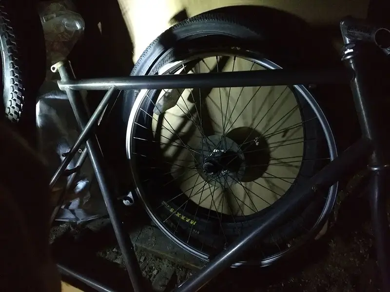

Size info in previous post ^ Here's a pic.
