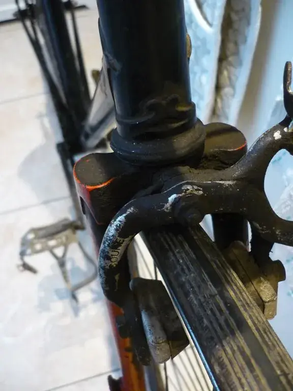

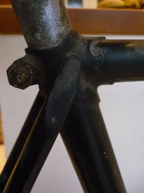

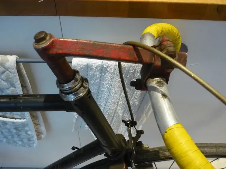

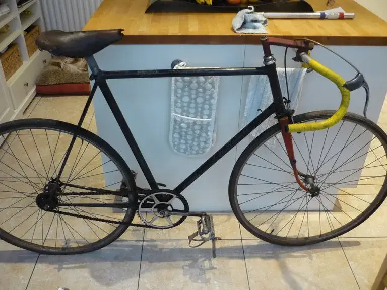

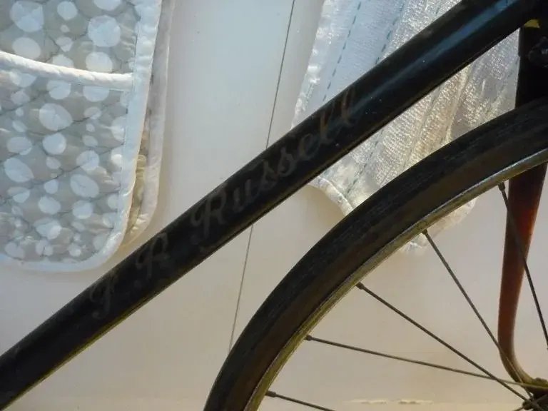

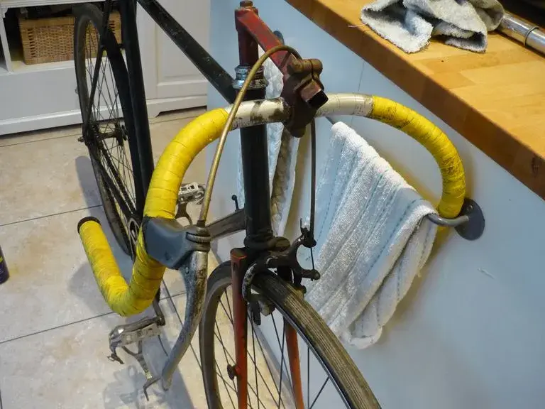

Some pics of the F. R. Russell. Don't worry guys, if I'm off the wagon I'll soon have it back up to 50 bikes :lol:
I've stripped off the Crank tonight and discovered the left crank is dated AU - 1955. Logic would say the drive side may have been changed due to teeth wear and the left side could be original, making it 1955 or thereabouts. The bars are Stratalite Madison - England. Seat post is a Reynolds Hiduminium R4, I've read that R4 denotes the size but can't find what the size should be, the calipers have it about 27.2mm. Not sure if the forks are original, although someone has been out with the red paint, the stem should be chrome.

Oh man that's nice, but wow its huge

Lovely, just the type of restore I enjoy, something aged but in need of restoration ( it looks like it might clean up okay - is that your thinking ), lovely Nervex Legere Series 48 lugs, and complete.The forks are period, original, who knows, once stripped you might find the answer, 1955 looks a possible but I can't help with the russell connetion,sorry, but I will watch out for any info. Keep us up dated. Terry

It is on the big side, I've not checked it yet but I guess 24".
Thanks Terry, that's some useful info about about the Nervex lugs. The killer on most bikes is the condition of the paintwork but fortunately the old black enamel looks in good condition. There are a few chips and scrapes but black is usually one of the most forgiving colours to touch up. The plan is to strip, clean and polish then rebuild, most of the bike is now stripped and I hope to remove the forks tonight. I'll keep updated with photo's.
The old Brooks saddle is unfortunately scrap, it looks to have reached the end of its ability to tighten and its nose has ripped off! Somewhere I have a fairly age appropriate replacement. The wheels are also in a poor condition and not original. Everything else looks to be salvageable, the Williams crank cotters popped off nicely, they usually give me no end of grief!
I'm just getting some quotes on re-plating the stem. There was a great guy just outside of Shrewsbury but he's packed up. Will probably need to be sat down when the quotes come in!
