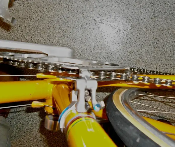

Hi it's a Campag record... cage does look narrow now you mention it...
also it doesn't seem parallel to chain ring, tail is further outboard so maybe I should swivel the mech to get that lined up ...

Apart from what's already mentioned, two additional things which could be influential: a)Whether or not the chainrings run perfectly true. b)Length of chainstays.
P.S. The spacer between the cage-plates at the aft of the cage does look a bit weird (i.e. narrow) in that pic. The cage should be slightly wider at the aft than at the fore?

The mech needs swivelling around a bit so it's parallel to the chainrings or slightly inboard at the rear.
Early Campag Record were notoriously narrow, I'll measure my spacer tomorrow but looks right to me.

maybe I can insert a small bush and longer bolt at the rear of the cage... I check the rings also , many thanks

I agree with Midlife, from the pic it looks like the mech needs twisting into line as it is not parallel to the chain ring.

Fair enough.. that's before my time! The only reference I have to hand is a mid 80s Nuovo Gransport. Distance between insides of cage plates: Fore.. 10mm. Aft.. (widest part, just before the outer plate bends in to meet the spacer).. 12mm. The spacer itself is about 8mm.
