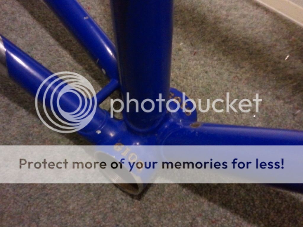

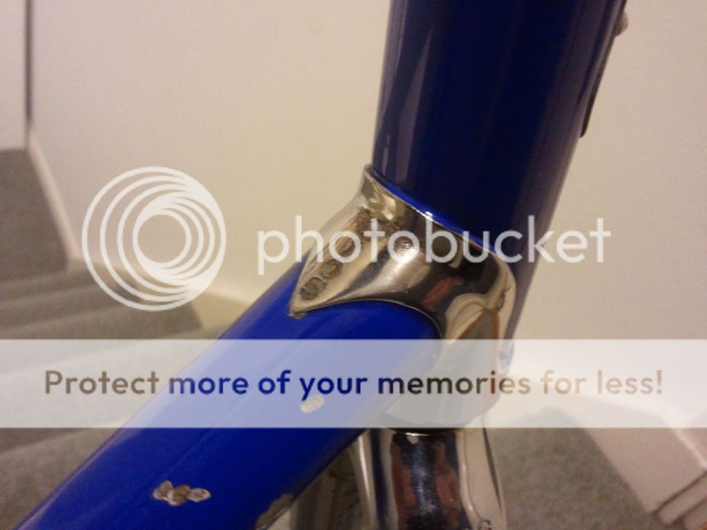

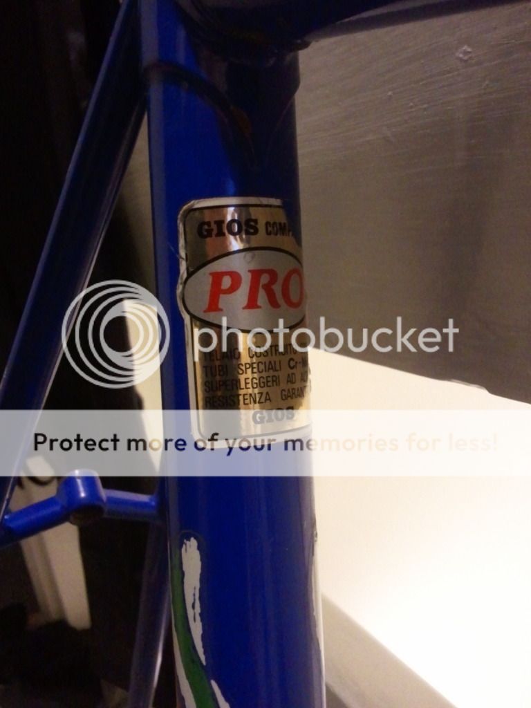

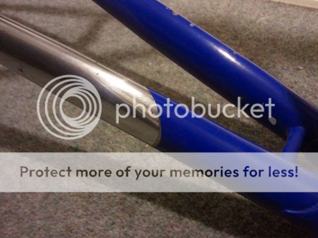

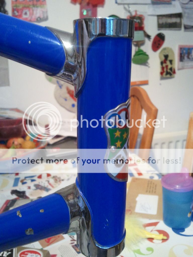

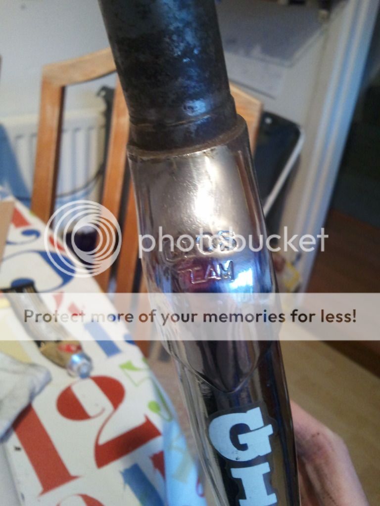

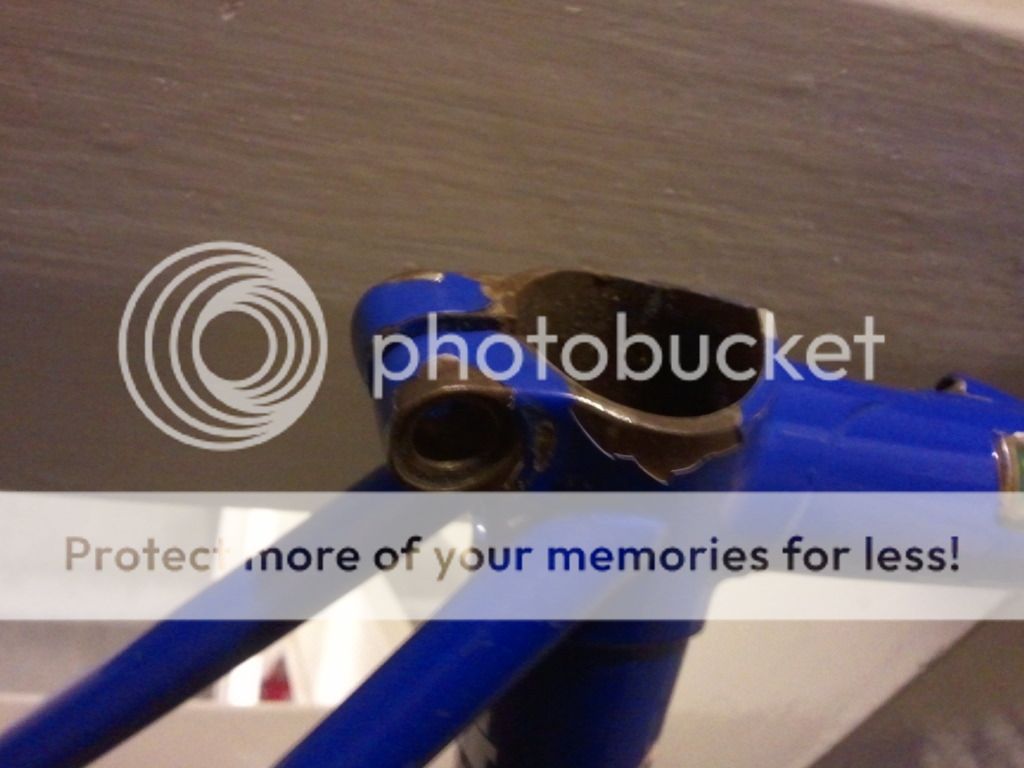

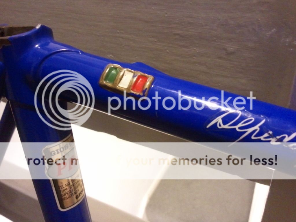

Bit of an impulse buy off evilbay. Whilst trying to reduce the number of bikes in the stable, I felt there was space for a Gios.
All in all, not that bad. I'm tempted to leave as it and just build and ride. However, the seed was sown last night to get it resprayed and finished with new decals. The chrome is in decent nick and would need doing. It appears to have a pretty much full chrome undercoat.
Another option is getting the 'Chips-away' peeps having a crack at touching up the problem areas.
Opinions??

Bring on another Gios 8)
Too many bad chips and some may come off that bit more!

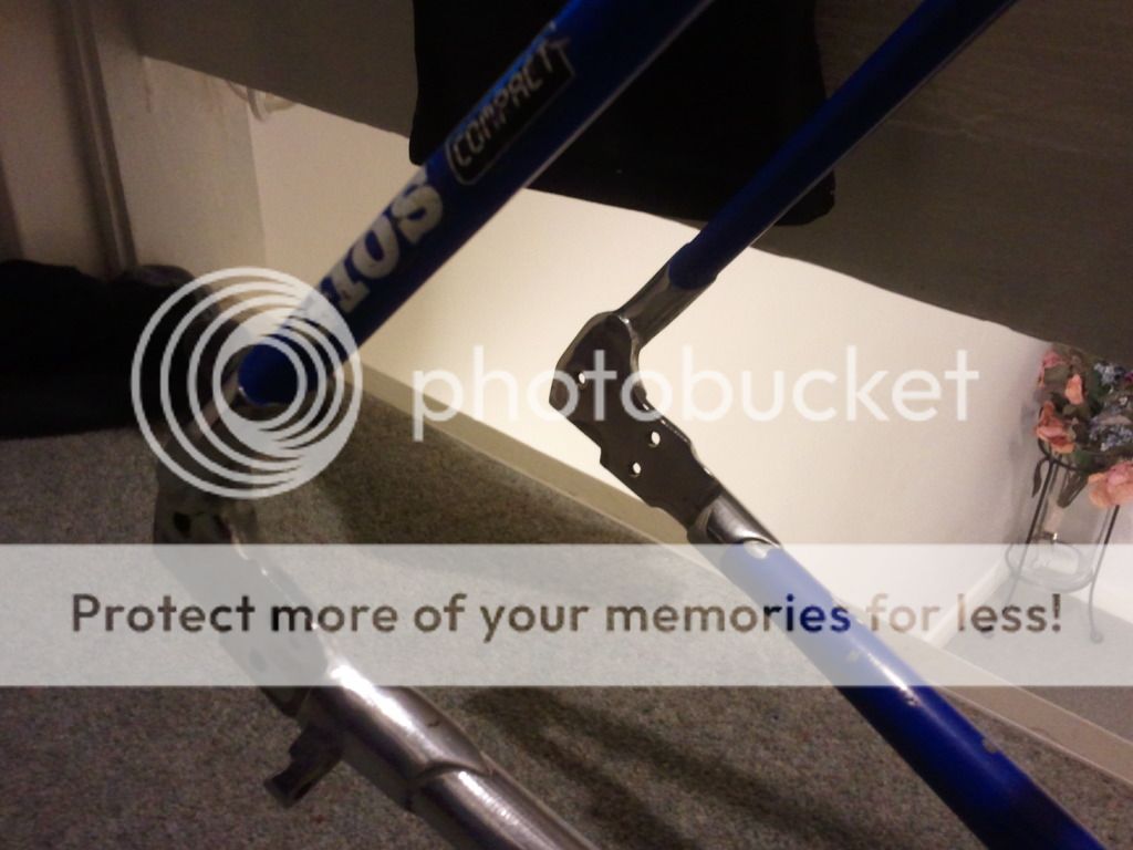

You got the rear drop outs and bolts ? These are very expensive!
1 : Strip.
2 : Respray in Gios blue ONLY.
3 : Go mad on a few bits from the seller below :D

Yeah, got all the bolts etc. They were taken off for cleaning.
I agree with the painting. I think I'm going to build, ride over winter, then renovate in a few months. Bit short of cash at the mo'. I'm going to give C&G in Liverpool a call and see how much they can do it for. If it's not ridiculous, I might be able to just go for it, we'll see...

Actually the paint is quite salvageable unless you want a museum bike that you're afraid to ride :shock:
At least while it's stripped down you can do the following:
1. Take the frame to a car paint supplier and get them to match the blue perfectly.
2. Seal the edges around the seat lug with some clear enamel then build the area up which is exposed to bare metal with aerosol etch primer sprayed into an old cup, wait for some thinners to evaporate (outside!) and use a fine brush to build up a few coats at a time. Then flat with 600 grit strips glued onto coffee strirrers ( geek tip )
3. Then apply colour by same method.
4. When completed, wash, T-Cut and multiple coats of wax polish.
I think you'll be very pleasantly surprised, 200 quid richer ( expensive to paint and mask chrome lugs etc ) AND it'll be original :)
Check out my Mattolini and Pettenella in http://www.classicrendezvous.com/Italy/ ... Matteo.htm
http://www.classicrendezvous.com/Italy/ ... pecial.htm
that's the method I used and am pretty happy
It won't take too long and if you don't like it then at least the metal is protected until you get round to a total renovation?

T cut original is a very fine polishing compound, DONT use T cut scratch remover which is more aggressive, you can use toothpaste as well! just get's rid of all the fine crap on the the surface, it doesn't remove the lacquer, duraglit not much use, for the chrome or alloy use Solvol Autosol, if there is rust on the chrome some aluminium cooking foil soaked in vinegar will shift it ( yep, really! )
It's all about the accumulation of small improvements and the final multiple waxing makes it look very shiny-bling without losing the original character 8)
