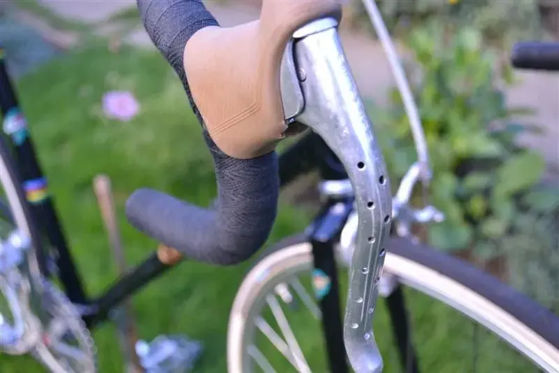

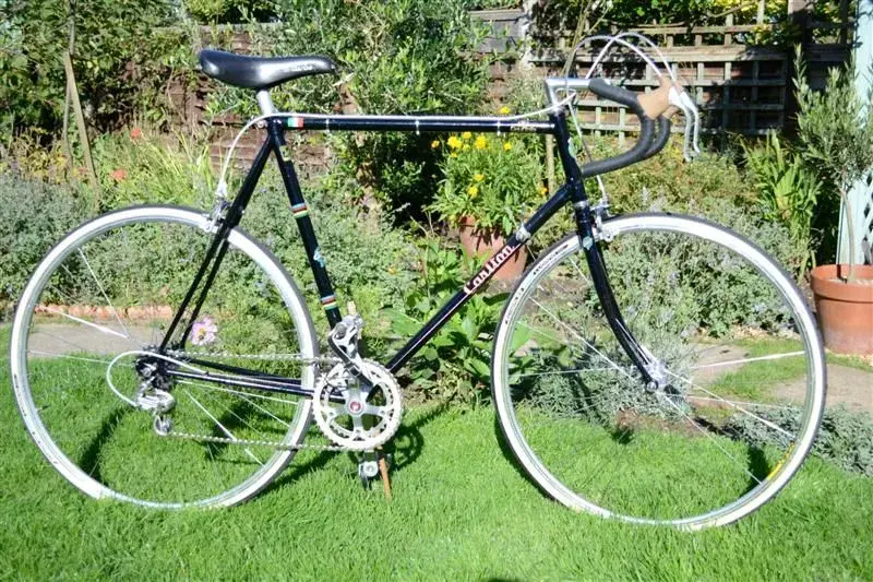

Frame:Carlton Giro d'Italia 1969 531 DB
Fork:Carlton 531 Italian Line
Headset: Original Carlton
Stem: 3ttt
Handlebar: 3ttt
Bar Tape: Black Cotton Bound with Green Garden Twine!!
Brake Levers: Weinmann Drilled
Brake Calipers: Weinmann 501's
Brake Pads: Weinmann Originals
Brake Cables: Braided Silver
Shifters:Sachs Downtube
Front Derailleur: Suntor
Rear Derailleur: Dura Ace 7200
Derailleur Cables: Braided Silver
Freewheel: Gold Star 14 - 24 NOS
Chain: Wipperman Silver
Cranks: Shimano RSX
Chainrings: Sakae 52/36
Bottom Bracket: Campagnolo
Pedals: KKT Pro
Rims: Mavivc Open Sport Silver rims 36h rear, 32h Front
Hubs: Campagnolo Record
Hub Skewers: Campagnolo
Nipples: ACI
Spokes: ACI DB
Tyres: Schwalbe Lugano 700 23c
Tubes:Giant
Saddle:Selle Italia Turbo Black Leather
Seatpost: SR Custom
Seatpost Binder: Carton
Bottle Cage: Silver Retro
Extras:
Weight:22.5 lbs

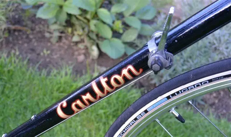

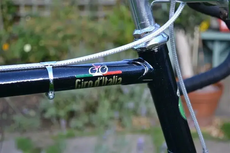

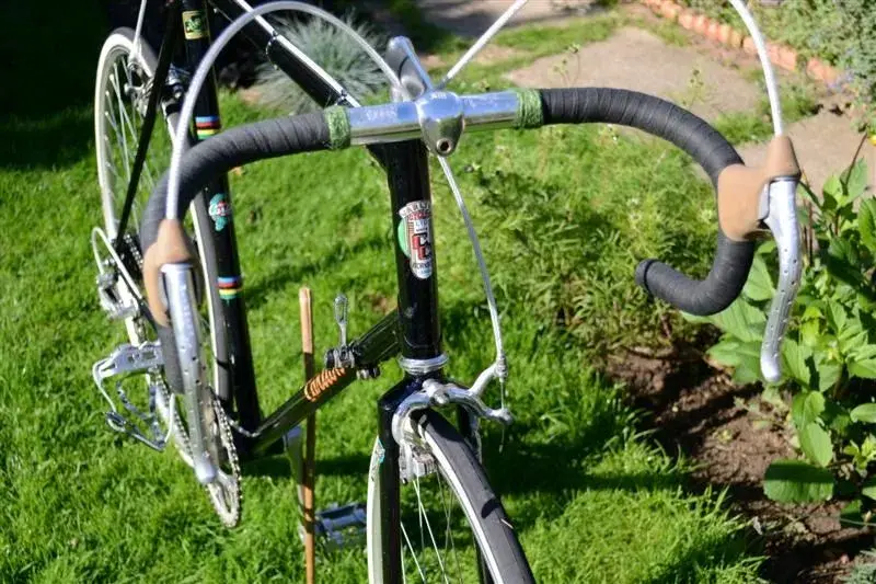

Not quite finished, but first ride today.
Rescued from a frame set that near ready for the skip, a £4 paint job and home made decals and airbrushed logos. Paint job used materials already left over from previous projects and is in Midnight Black Metal flake, (Black flake with a hint of blue flake) over a black base coat and then lacquered. Aim was for a retro look rather than recreation of the original, as no idea what original build was, as frame came in a shabby blue!, decals are non original, Giro logo based on the modern logo of the race

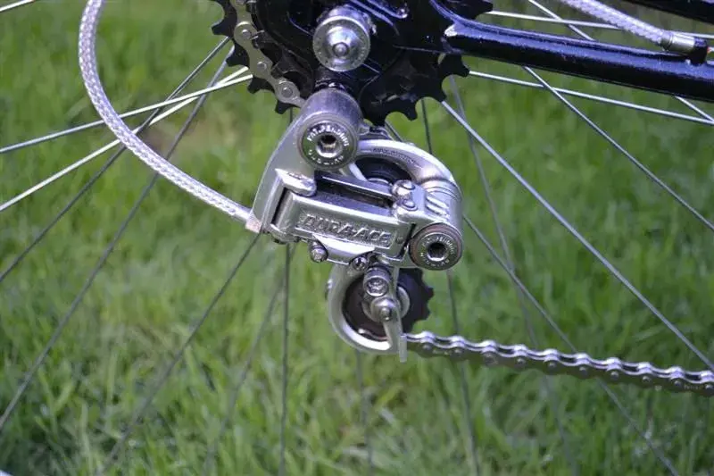

Chainset was originally a Campanolo Strada, but the tapers are too worn and it fowls the chain stay, so its got a later Shimano RSX, I have a 52T Ring for it the 46T on it was ex cross bike and far to low for road use, still to fit the front gears and set chain length.
No back brake (missing a suitable cable!), retro style bottle cage in silver still to be fitted.
Weight at just over 22lbs pretty respectable, not trying to be a weight weinie.
