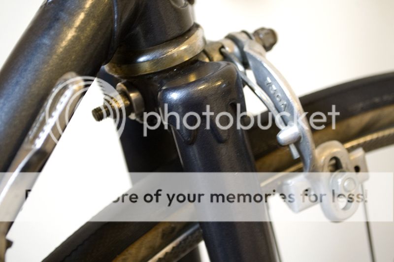

As of yet, I don't know what make the frame is,.. the only give away that i may have found is the fork tops have a pronged design.. i can only find a photo of these on Schwinn Bikes,.. but I'm doubtful that my frame is a Schwinn (hopeful though!) any thoughts? Spec is as follows:

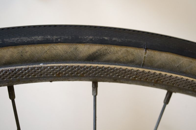

Nooooow then, the trouble begins! I have had to halt to consider options,.. The rims themselves have seen better days but I quite like them, and the noise the brakes made when operated thanks to the rigida rim surface is.. nostalgic i guess. After stripping cleaning and rebuilding the hubs up (which are very smooth!) I noticed the rear wheel was bent, so I have had it trued... perfect now however something would appear to be wrong on the rear wheel! :cry:

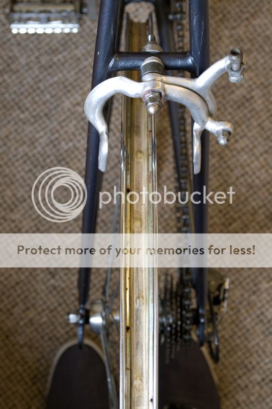

When fitting the rear wheel the wrong way round it fits between the seat stays perfectly and the chainstays. However when fitted correctly it will not line up in-between the seat stays! Is this symptomatic of an incorrectly dished wheel? I have adjusted the rim as far as i can using the spokes but there is not enough adjustment there. My chain line would appear slightly suspect too... >? hmmm.

Is there a stack of chunky washers on the drive side axle? If so, does taking one off the drive side and moving it over to the non drive side move the wheel into the correct position?
Don't worry too much about the chainline - it looks like you're on the inner front ring and the outermost rear ring, which will always give a fairly steep angle. To keep the drive train happy, you could stick to only using the two smallest rear cogs when you're on the big ring at the front.

thanks for the reply, There are no removable washers on either side of the hub, just the cones and locknuts. As you can see, the drive side spokes are practically flat whilst the other side is nicely bowl shaped, i don't think i have any adjustment left.
My concern is that if I purchase some new wheels would the same happen? would they need to be dished aftersales?

Knew i had seen this type of fork before. The bike fits the bill for a Fuji Sports 10 apart from the 3 braze on cable guide..... Can we have a pic of the front of the head tube?

There looks to be a big gap between the 5th cog and the frame. I would say there's a spacer in there that's to wide. Fitting a smaller one looks like you could shift the wheel centre over 1/4+"
The fact that its so far out would suggest they are not the original wheels.

I've seen that fork crown style on many Peugeot's, which would also fit with some of the components :)

I really like the rigida braking pattern on these rims, but i think these wheels have seen too many bumps scrapes and use in the wet to really be used confidently so some new ones are on the cards,... is there anything i need to watch out for since it's a 5 speed? can i re-use the cassette/freewheel/whatever it is or will it need re-newing?
So the frame maybe a peugeot or fuji then? excuse my ignorance of bike terminoligy,.. someone asked for a photo of the head tube,.. would this be the tube that the handlebar stem is inserted into?
i think i might have found it!
thoughts?
