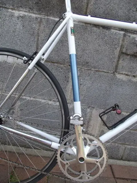

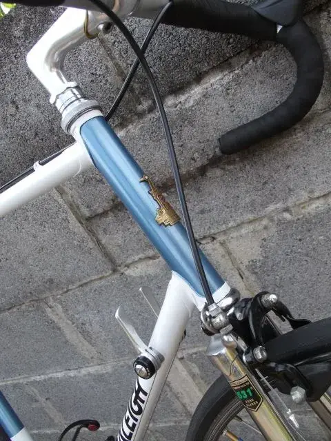

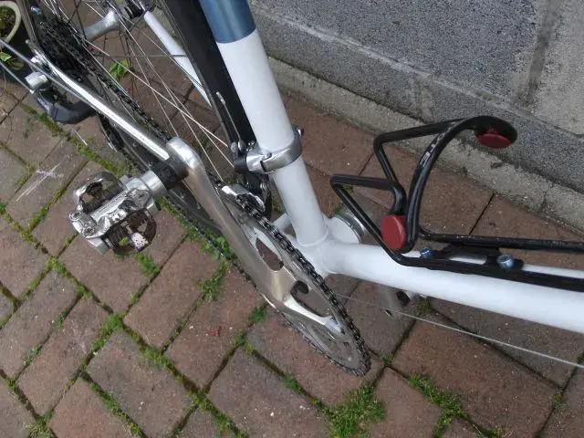

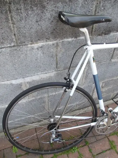

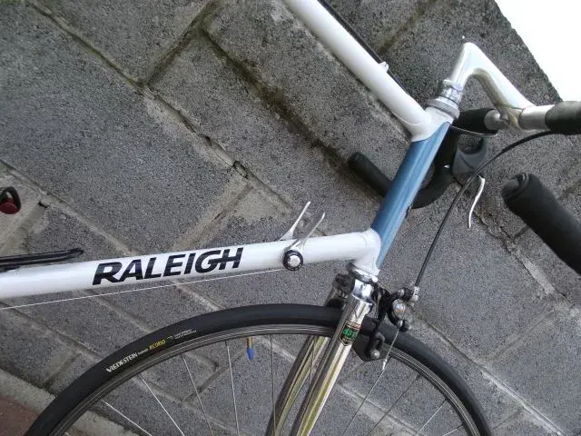

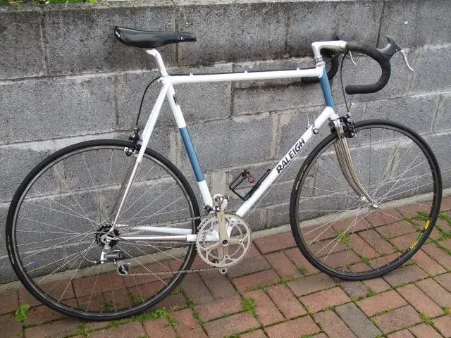

Some of you may be cursing me for what iv'e done to this quite rare Raleigh Gran Sport from 1983
I thought of restoring this to it's former glory,same colour/components etc. The whole bike was in a state,components shot,seat post stuck.
So carried out a restoration project of my own.
Removed the seat post,caustic soda method,dissolved all the alloy post away. Rubbed all the frame with fine paper and wire wool,removed all the rust spots,2 Coats of primer,etching primer on the exposed steel area.
Chose a nice Olympic White top coat,kept the decals simple.Raleigh DT decal and new Reynolds 531c frame and forks decals. Breeze Blue Headstock and seat post panel. Final coat of clear laquer. I seem to recall some of the gran sport models did actually have this colour scheme at some point
Anyway my plan is to use this over the winter months,waiting for delivery of Salmon profil aero alloy guards (close clearance)
The components are a mix of Campagnolo aero seat post,Shimano 600 tricolor chainset,300EX Front/Rear mechs,Modolo Corsa Brake calipers and levers,Cinelli bar and stem,Campagnolo chorus hubs with mavic rims. Hope you like it.
Any comments greatly accepted,Good or Bad

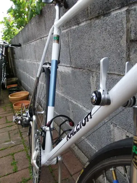

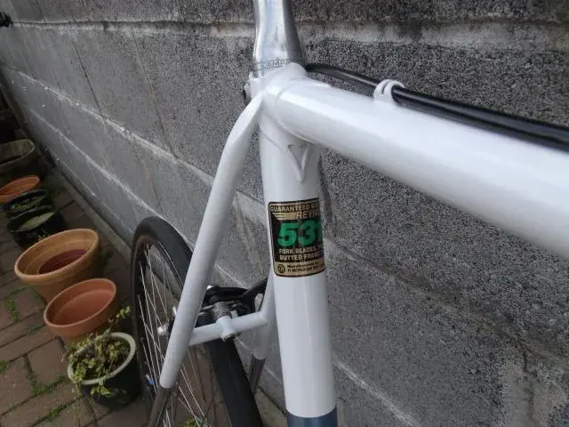

Some more pictures

PostPosted: Sun Aug 26, 2012 9:32 pm
Newbie
Joined: Sun Aug 26, 2012 8:38 pm
Posts: 8
I for one really like what you`ve done, looks very cool.
PostPosted: Sun Aug 26, 2012 10:12 pm
Joined: Sat Aug 29, 2009 12:15 pm
Posts: 659
Location: Aberdeenshire
I like it too. Very clean and fresh looking.
We'll done to you, very nice indeed.
 Post subject: Smart
PostPosted: Sun Aug 26, 2012 11:09 pm
Gold Trader / MacRetro rider
Joined: Mon Feb 11, 2008 12:03 pm
Posts: 6127
Location: held captive by baby haggis in a cave in Scotland
Looks pretty smart to me 8)
Well done :wink:
Jamie
PostPosted: Mon Aug 27, 2012 6:12 pm
Joined: Mon Aug 27, 2012 5:22 pm
Posts: 22
Location: UK
ooof! that's clean!
PostPosted: Thu Aug 30, 2012 2:44 pm
Newbie
Joined: Tue Dec 07, 2010 2:43 pm
Posts: 3
That's a really impressive finish.
If you ever get another, I'd love to see what you could do with an original restoration. (Mine being an unrestored 1963 GT250, which was the Gran Sport frame but with straight alloy bars and an optional 3-speed. I've had it since new.)
PostPosted: Thu Aug 30, 2012 4:33 pm
retrobike rider
retrobike rider
Joined: Mon Sep 21, 2009 10:17 am
Posts: 1303
Location: Lewes, East Sussex
:D I think it looks cool!
Nice work.
I LOVE mine and am undergoing a full 'spring clean' on her.
It's my favourite bike...
PostPosted: Thu Aug 30, 2012 4:47 pm
Joined: Mon Sep 28, 2009 8:16 pm
Posts: 3631
Location: north wales
Fitted some nice Salmon low profile alloy guards,quite a challenge
But look the part.
Took it for a midweek club run yesterday teatime,rode about 30 miles
I absolutely loved the quality of ride,responsive,quick aswell as comfortable.Ok the ratios are not suitable for the hills here in North Wales.
A good leg workout nevertheless.
Don't know what the rage is for Carbon Race bikes
Stick to steel for a memorable experience.
Maybe change the rear freewheel for a 12-28 or 13-25 7 or 8-Speed
Anyone have one lying around
Cipo
PostPosted: Thu Aug 30, 2012 4:52 pm
Old School Hero
Joined: Wed Apr 02, 2008 7:22 pm
Posts: 209
Location: Midlands, UK
Really smart, I love the simple colour scheme. Plus it's getting used which is always good I think.
