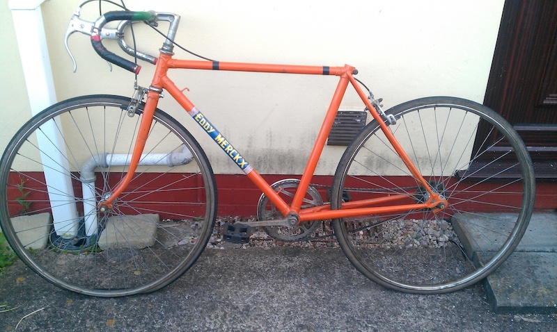

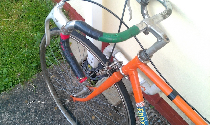

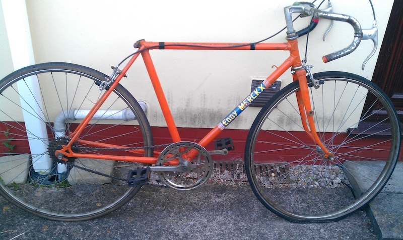

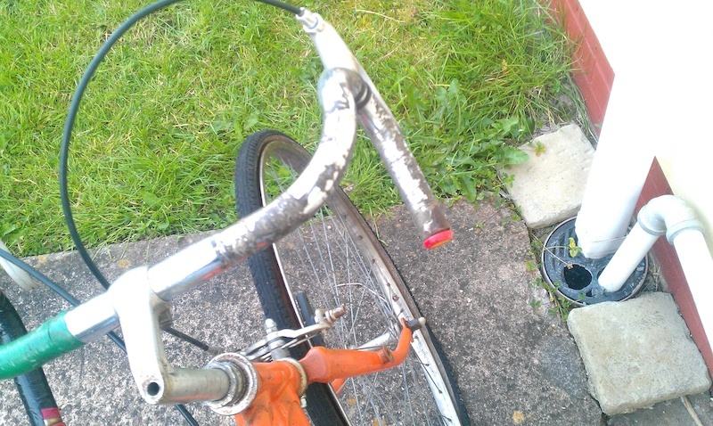

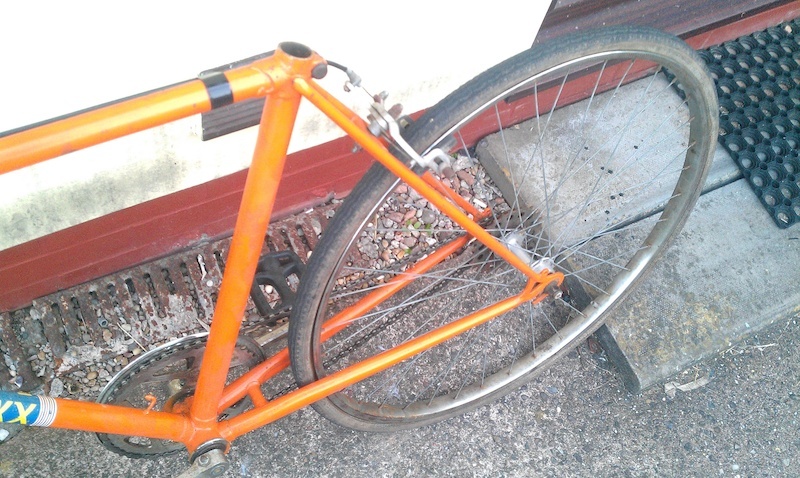

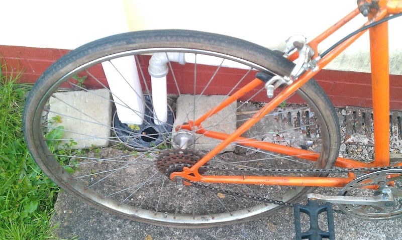

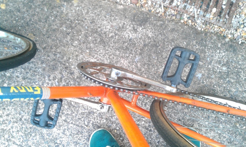

I acquired this for free and am wondering if it's worth restoring? Not much info on it either, but I was told it could be a E.M replica by my bike shop friend.
Anyway. Is it worth restoring to originality?
Any help would be appreciated.
Thanks.
Pics:

No it's a cheap supermarket job. Would be worth £100'ish max in great condition. I'd single speed or convert to fixed in the style of the original if I was to do anything at all.

Cheers Tel, thought it was too good to be true :wink: Not bad for free though.
I'll get it single speed'd and keep it as a commuter.

Falcon built Eddy Mercx bikes back in the 70's at their South Humberside site and a Google search will show what they look like.
Eddy Mercx also sold his name to other countries.....
Don't recognise that though ..

Clearances you could chuck a wellie through...

Also, will 700c wheels fit, and will the brakeset need changing if 700c do fit?

If they're not 700c already then you will never get a brake with a long enough drop to fit 'em!

Damn :? They're 27" at the moment.
Do you know how I can put a single cog on the rear wheel, to make it single speed? (not fixed)
I'm getting a new wheelset from bike shop but will go 27" now, but all 27" wheels are freewheel - are there any single speed kits or something I can use?
EDIT:
Would the below cog work? And would I need anything else to put on it to make it stay? Or spacers?

Yes thats all you need; a single speed freewheel. I'm sure that one is great quality but I'd be looking for one a third of that price!
