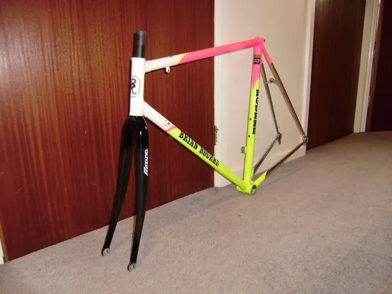

Arrived last week and all is as expected.
Frame and forks are in very good condition for the age, no dings, dents or cracks.
Paintwork is a very bright pink and yellow affair! Condition not so good with a fair few chips and scrapes. Chrome is good with only a mild amount of rust spots that will polish out but some has chipped off the rear dropouts.
I'm still waiting to hear back from 'BR' regarding the age and full dims/angles but so far she's very close to my own custom build. Five mill. shorter in the seat tube, same top tube, shorter headtube (lower bbk?) and a slightly tighter rear end.
Plan is a retro/modern build, trying to keep the weight down without being silly but using modern good components from various manufacturers.

Just recieved from 'BR'...
It was originally shown as a yellow bike with pink and white flashes. The date of build was 10th December 1991.
The seat tube is 22"
Top tube 22.25"
Head tube 5.4
Head angle 74
Seat angle 74
Rear drop out made for a 7 speed but no width listed.
Now to check against my red one.

Are oh so good, seat and top tube are a prefect match!!! Total headtube length is 10mm shorter, 5mm is accounted for by the top lug being a lttle shorter than on my red 'BR' and the rest is likely to be due to a lower BB. The rear end has been built tighter so this one will be super responsive.
First part bought is...a very light set of Mizuno carbon/carbon forks, nice and slender.

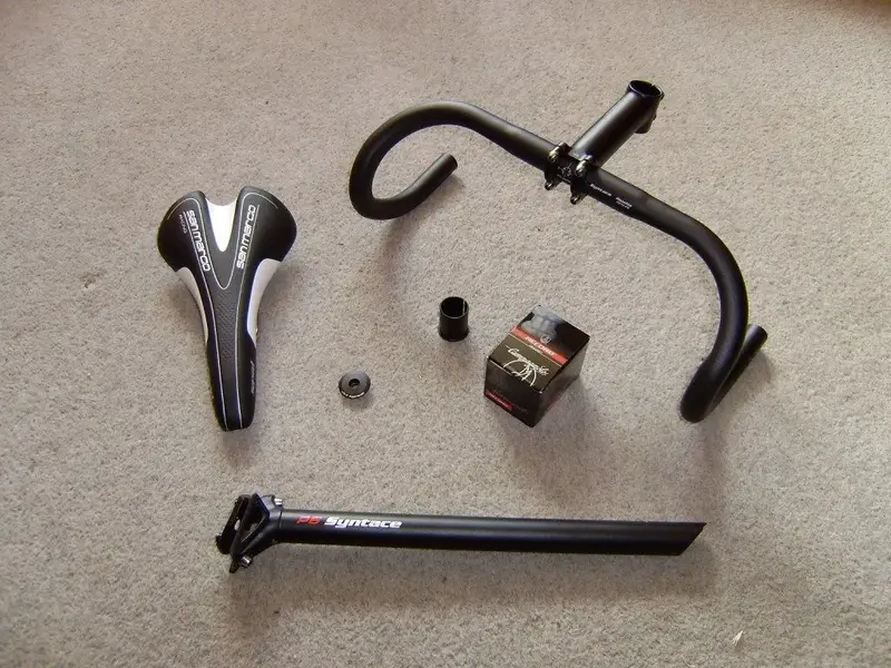

First of the components...Syntace and San Marco.
The seat post is way too long so will be cut down at a later date.

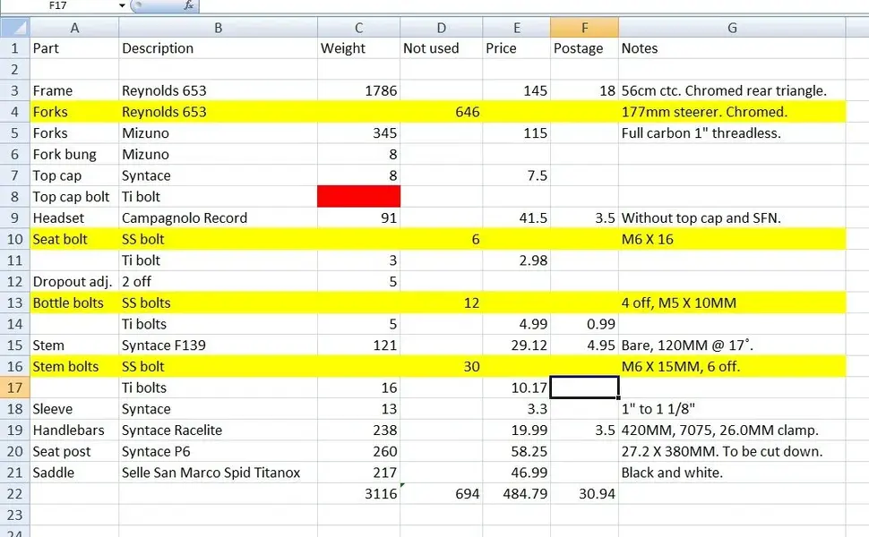

...and the figures look like this:-
