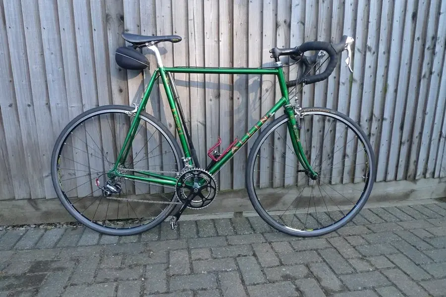

ANd this is my other bike...
This one is mostly retro (RD-7900 being the most obvious anomaly) and I think most of it falls within the pre 1998 vibe. Despite my dislike of funereal black componentry, I clearly thought it was cool once upon a time, but in hindsight, the black stuff looks dull and uninteresting but it serves this feller admirable (actually, now I come to look at a photo of it, it does look kinda cool).
The frame is an 531c Allin and was built for me by Cliff Shrubb in 1986. It has had three paint jobs, has carried me in endless time trials throught the 80s, has had racks and panniers (difficult without mounts by not impossible) mounted and been touring around the Massif Centrale, Has been converted to fixed for one winter, and in 92 was snapped in two (along with my collarbone), repaired and refinished in this rather sultry flamboyant green. The Cannondate chainset was a triple that has been converted to a double with a dremmel and lots of patience. The Mavic wheels have needed zero attention in well over 10 years. Rest of drivetrain is Shimano (new DA rear mech, Old DA front mech, 600 brifters, and a mongrel cassette made by butchering several knackered ones (including some IG or UG sprockets) but it seems to work fine). Brakes are Dura Ace 7400 and are the oldest thing on here dating back to 1985. Campag seatpin. Fairly modern Deda bars and stem (great shape), with two layers of gel tape to protect my deliacte musicians hands. Stem is runnign with a quill adapter as I couldn't get a Cinelli 1A to grip the deda bars. An original Flite saddle rounds off the whole thing.
So, an old, dear friend that has seen more of my arse than anyone has any need to...

Very nice indeed. Looks like it would be lively - I guess the big frame always makes the wheelbase look shorter.
I've been considering, in my modernising my trusty old 1985 Raleigh Gran Tour for use as my only mudguard bike (or, in Scotland, known as one's main bike!), getting a quill to Ahead converter, but can't find one outside of the US. Where did you get yours?

........Fastback seat stays always make for a class look :)
Shaun
Shot in bro, shot in.
Fastback stays don't meet the binder bolt. For example, the SBDU would generally only use shot-in stays for a light(ish) rider on a TT frameset.
I have a Geoffrey Butler built by Cliff Shrubb, I didn't think he built for Allin after the business was sold; the last"true"Allins were built in 1980/81(by Peter Cobb). Then the business was sold.
Cliff built frames in Whitehorse Road BITD (60s) near Allin Cycles, and then he moved away. Jenson were also in Whitehorse Road, Croydon, Allin were the favoured builders and hangout of the Norwood Paragon CC.
Very nice though - especially with the"fairground"style lettering.
