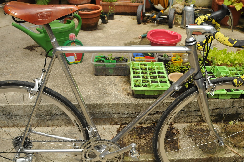

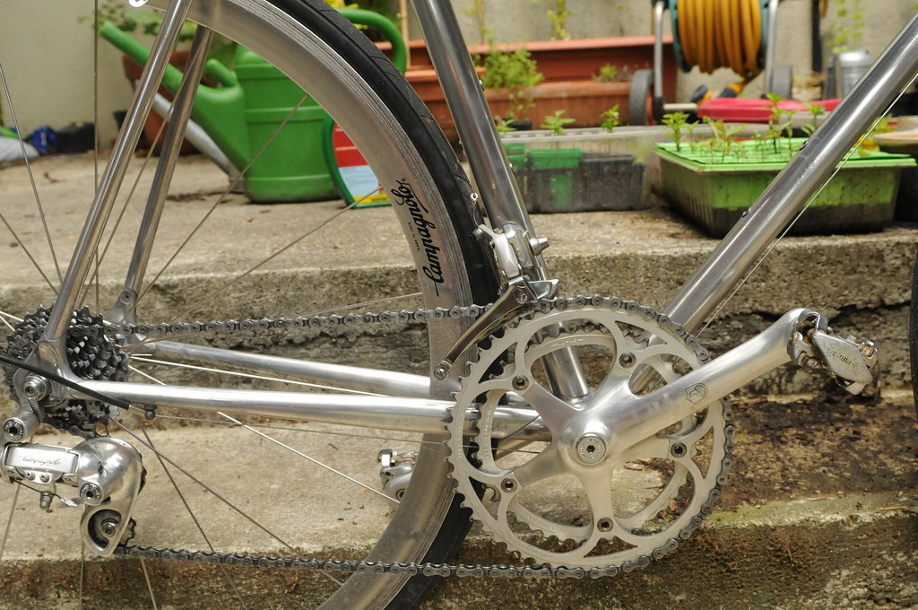

Been thinking about doing this for a while. Rumor had it that you could remove the coloured anodizing from alloy tubes with oven cleaner and I always wondered what the glorious Vitus 992 frame would look like in a sort of all-alloy livery.

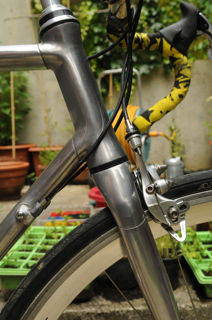

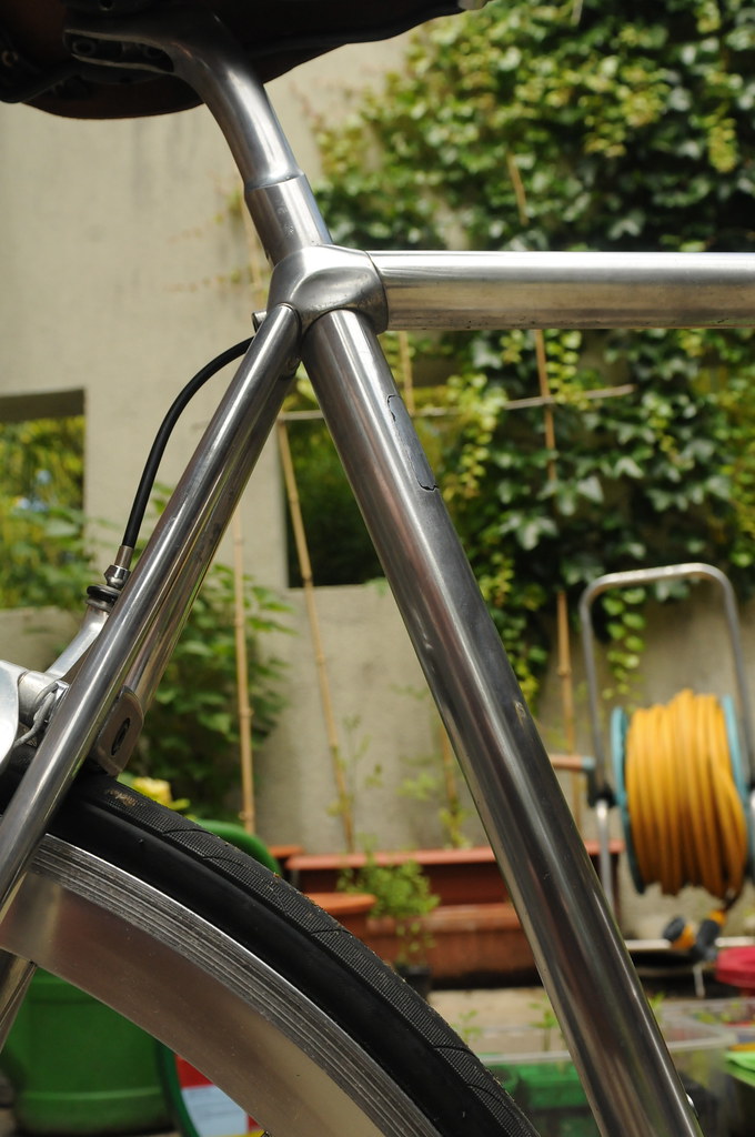

A couple of blasts on the oven cleaner gel plus a lot of wet and dry sand 500 then 800 followed by a crazed session on the Autosol this was the result. I removed the black anodizing from the main tubes plus the chromed anodizing from the stays. I couldn't get such a good finish on the alloy lugs due to the raw nature of their castings. The tubes had their fair share of dings and sadly these show up more with the mirrored surface.

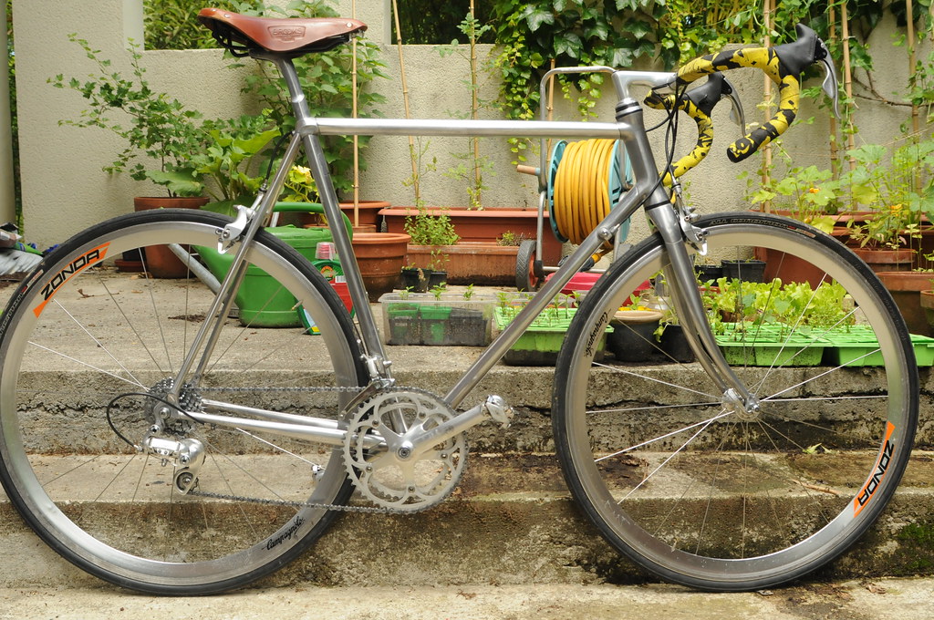

Anyway, just put it together and here is the result. I might get some Vitus decals die cut to match the 'Zonda' orange on the rims. Overall I'm quite pleased. I need to change the bar tape though...

Hi RockyRidge, believe me, I tried various combinations of wet and dry on an old seatpost first, the 500 was as course as I wanted as there was a lot of resedue left over from the oven cleaner that just wasn't going anywhere with 800. Yes, the 500 caused scratching but nothing that couldn't then be removed with 800. The fine compound in the Autosol did the rest.
The Vitus frames are superb, they are quite common and cheap in France, mine came free with a Mavic bottom bracket I bought locally from a seller that just didn't have the tool to remove it so the frame came free. You can pick up clean 992 frames in France for around 100 quid but sadly they require specific seat-tube sizes (25.4) and equally anoyingly specific bottom brackets with tapered cups, don't buy a frame unless it has these with it. I'd imagine a replacement headset would be impossible to find too. Carbon TVT and Alan frames (same company) are nice too but they do have a habit of splitting internally.
The 992 was the last of the classic Vitus frames, it's essentially the same as the earlier 979 (last two digits denote year of design) but has the ovalized main tubes plus the superb internal Mavic headset. I love the design, it was way ahead of it's time with equally as modern geometry. There are lots of scare stories regarding the bonded build of the frame but I've yet to hear from anyone who's had one fail on them.
For me, no other frame works as nicely with the curvacious castings of the Campagnolo C-Record era parts as well as the Vitus, hence the complementary chromed look frame. I love the design of the woefully useless Athena calipers, the pointlessly over engineered Chorus rear mech and the organically sculptured Chorus chainset.

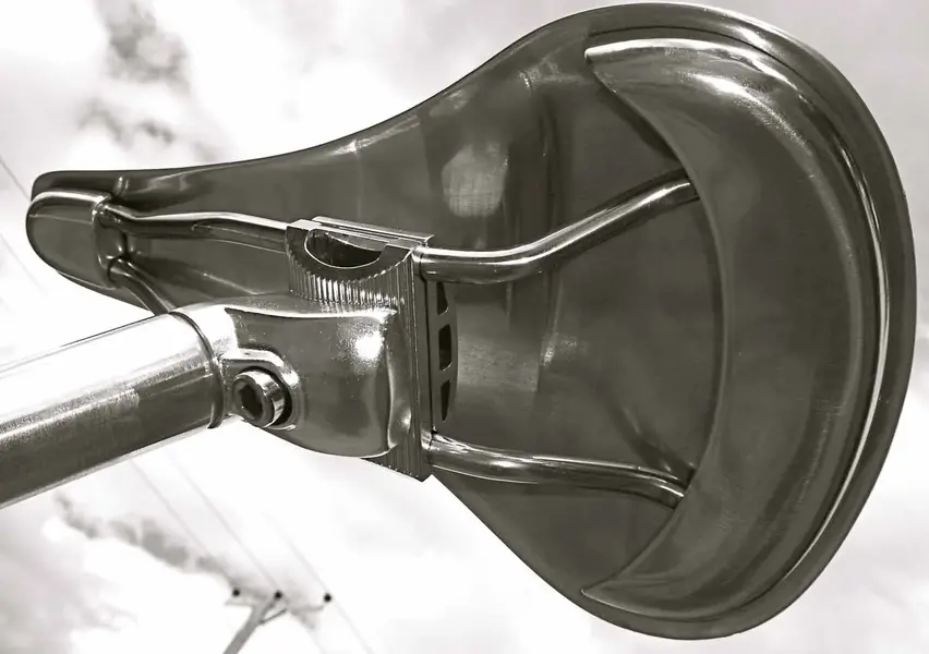

I made this seat out of aluminium which would look perfect on that!!
sorry for the huge photos i can never sus out putting photos on here
