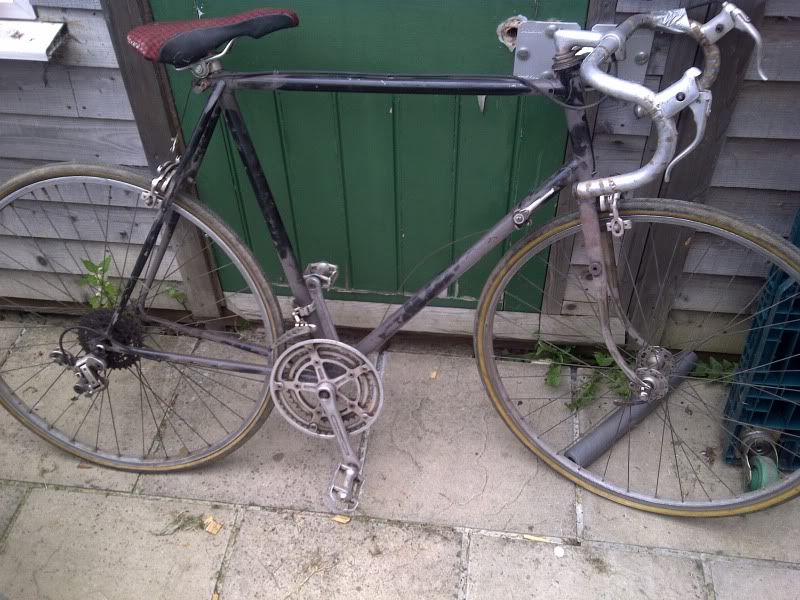

So i have been given a old raleigh road racer he told me it was a raleigh carlton but since looking at some of the pics of carltons they look different
the serial number is WA1004468 which i think is either a worksop 71 or 81 it has all raleigh componenents and 10 speed both quick release wheels with wide flange hubs half chrome forks and is very light
The only trouble i got is the frame has been sprayed in its life with rattle cans so dont know what model it is i will get some pics up tomorrow but if you need detailed pics of certain bits please let me know and i will sort

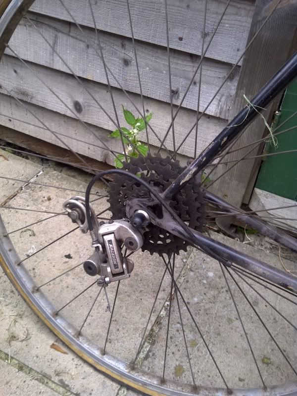

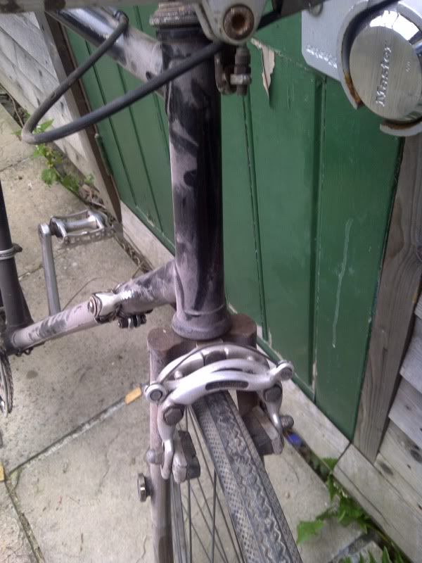

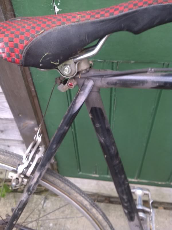

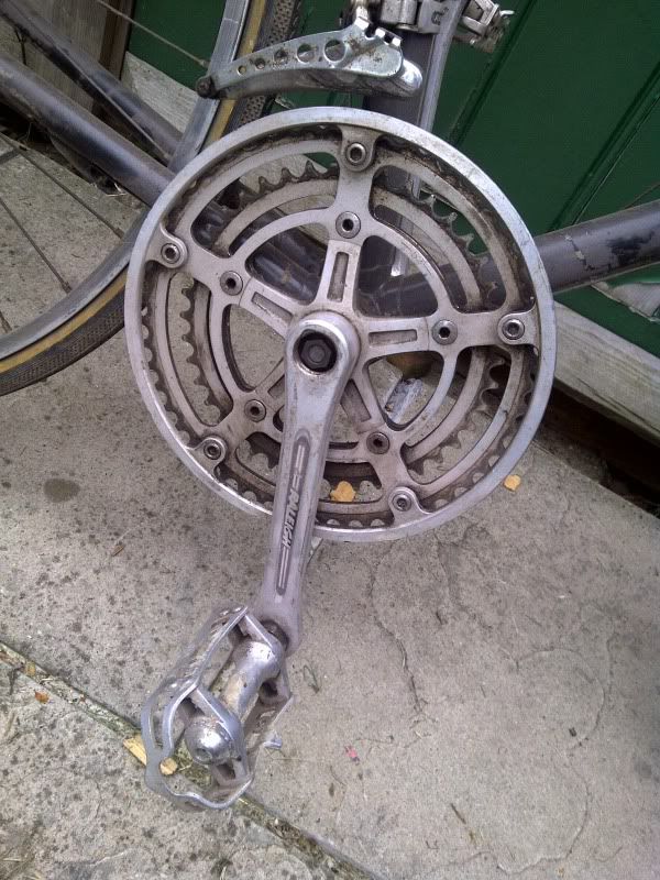

looks like a 1980
here a few pics
PostPosted: Thu May 31, 2012 1:35 pm
Joined: Mon Mar 02, 2009 4:22 pm
Posts: 1548
The brakes, fork tops and rear stay tops are identical to those on a Raleigh Richmond. If it's a Richmond it should be 531 tubing. Only real way to tell is to measure the seat post. If it's 27.2mm then it's 531. Anything smaller and it is not.
