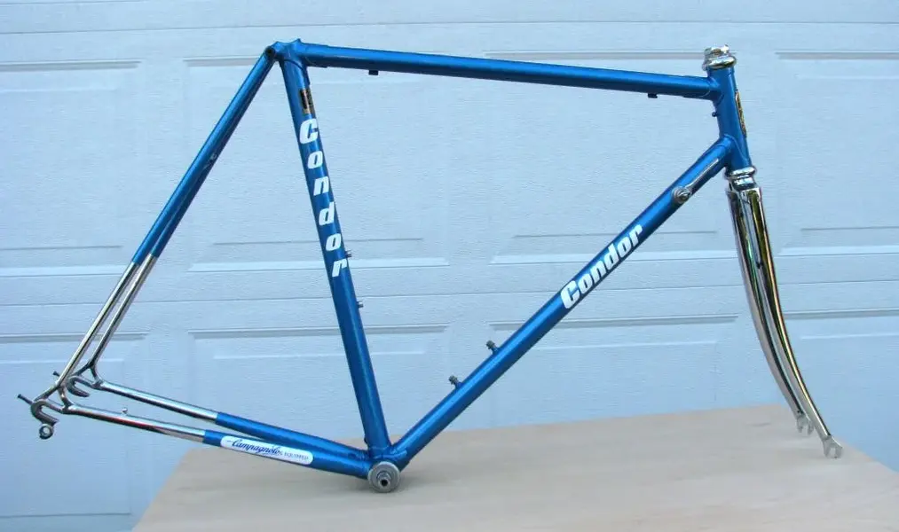

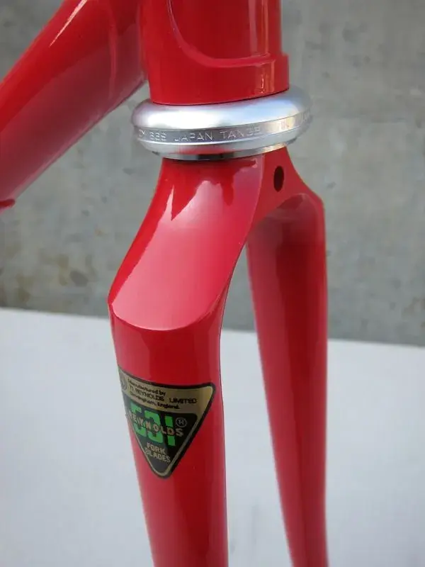

This is a 1979 Condor Italia of Reynolds 531 w/ Campagnolo dropouts. The fork is not original; it is a very nice Ishiwata fork with Suntour Superbe dropouts. I'd like to find one some day of Reynolds 531 with a full sloping crown like the red one in the attached photo. I think the fork crown is Prugnat; the same one was used on a lot of Raleighs, Holdsworths, Condors, and Bob Jacksons, and I'm sure others back in the day. If anybody has one I'd like to buy it. Otherwise, I'm very happy with this old bike. It turned out really nice.
Frame: '79 Condor Italia, Reynolds 531, Campagnolo Dropouts
Fork: Ishiwata Steel Fully Chromed, Suntour Superbe Dropouts

File comment: Before I Started...

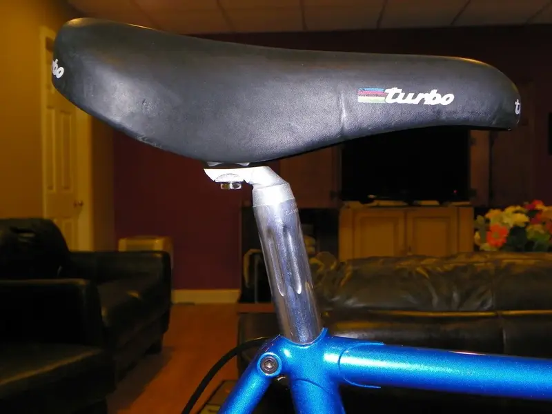

File comment: You can see I changed the saddle to a white one but here also you can see the seat stay treatment which was one of the details I really liked.

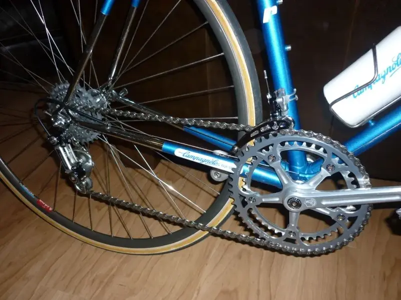

File comment: Super Record Drivetrain w/ Suntour New Winner 7-Speed Ultra 12-30 Freewheel. It's all hills where I live!

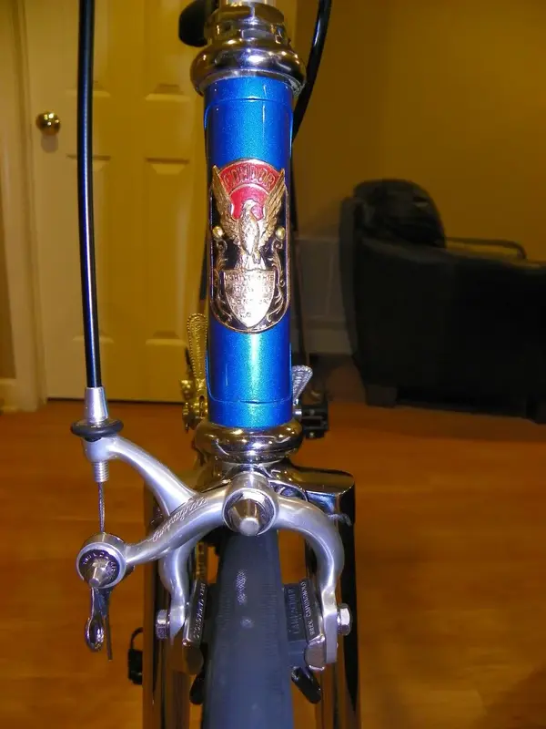

File comment: Head Badge
File comment: I want a fork for my Condor like this one!

Nice bike - but - how do you get your Super Record rear mech to handle the very wide ratios?
And move onto a 30t sprocket?
In my experience there isn't enough 'spring' in the cage to take up the chain slack on wide ratios without removing the cage 'stop screw' which then makes it difficult to remove the rear wheel without the cage and chain wrapping itself in knots. 28 tooth is the largest sprocket I've managed - and Campag say a 26 is largest.

The Super Record is actually rated to 28 teeth according to the references I've seen. I believe the cage is slightly longer than the Nuovo Record which is rated to 26 teeth. The SR easily does the 30 tooth sprocket. And a Nuovo Record will do 28 also with no problem. In both cases, running the 42-52T chainrings. I couldn't vouch for any other setup, personally. Proper chain length is required. Thanks for the compliment.

When I get some time later I'll post a new close-up photo with the SR mech on the big sprocket. FYI.

Love those shot-in seatstays. Why the mismatched tyres though?

Agree about the seatstays being sweet, as is the whole bike. Love the chainstay Campagnolo sticker - is it all original then ?
Those red forks are amazing aren't they - good luck finding them.
I actually have some of these, unfortunately though, they are attached to a front wheel, headset and frame that I ride every day :wink:
