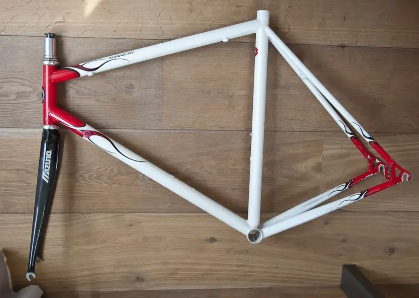

I just acquired this titanium frame from Raleigh, with mizuno fork.

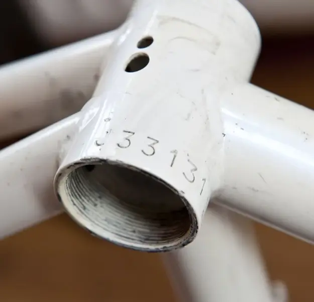

The frame number is
Does anybody know what year it is and quality?
It has one problem that I have found and that is the screw for the bottle holder. the inner screw attached to the frame is loose. Is there a way to fix this, glue maybe, or do I have to go to a really goo d frame builder?
I needed a new project after I have ridden my steel Duell bike.
And I have always liked the sights of titanium bikes.
So If I want to make in natural looking how would i get rid of the paint?
Kind regards,
Maarten

File comment: raleigh frame nr : J33131

Just having a quick glance here at work but judging by the paintjob it looks about 97 - 99 vintage and I think these were some of the last to come out of the RSP division. (Raleigh Special Products)
Very nice 8) Lovely paintjob.

Correctly answered. It is 1999, and the solution is a new rivnut (or a bit of glue).

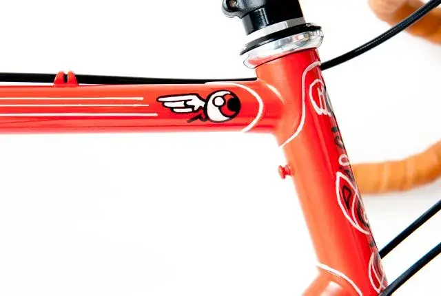

I had my old steel Duell sanded before giving it the orange colour, can that be done with titanium as well? It would save me a lot of work and it costs only € 25 at a frame paintshop.
The special paint was done by a graphic artist, and I really love the flying eye. I think I'd like to do the same with this one but with a clear frame and keep the flames as a black outline, as a tribute to how it was.
