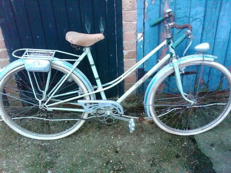

Our garden was burgled last Summer and my wife's Specialized Hybrid bike is one of the victim.
Instead of buying similar safe option (=boring), I have found this French mixte frame bike as cheap project.
Frame: 510mm, Mixte, Steel
Fork: Steel
Headset: Unbranded, French Size
Stem: Alloy, French Size
Handlebar: Steel, 25mm@clamp, French Size?
Bar Grip: Black Rubber
Brake Levers: Unbranded Alloy, nice curve
Brake Calipers: Mafac Racer (F/R)
Shifters: Huret, Down Tube Double
Front Derailleur: Huret
Rear Derailleur: Huret
FreeWheel: 5 Speed Unknown
Chain: Unknown
Cranks: Solida Steel Cotter
Chainrings: Steel, 48T, 40T
Bottom Bracket: Probably French
Pedals: Unknown Brand Steel Touring Pedal
Rims: Ridgida Steel 700c, 36H
Hubs: Unbranded Alloy, Solid Axle with wing nut fixing
Nipples: Steel
Spokes: Steel
Tyres: Michelin World Tour 700 x 28c
Saddle: Unknown Plastic
Seatpost: Steel, 24.5mm(!) dia.
Seatpost Binder: Steel Bolt/nut
Extras: TA Front Rack, Soubitez Front Lamp, Dynamo and Rear Light
Weight: 13.8kg
My aim is to tidy up this bike with minimum expense and make it look like this Rene Herse :lol:

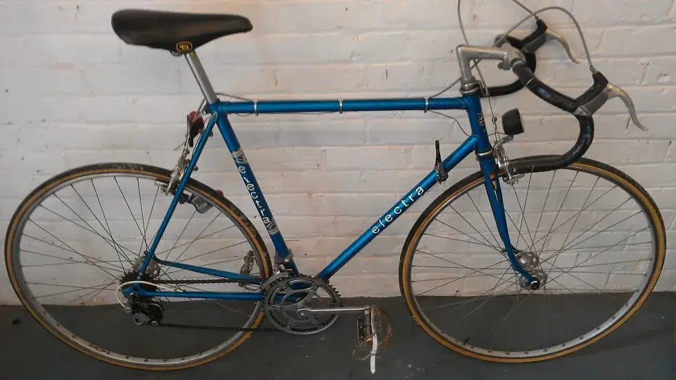

I import quite a few french bicycles and have had alot of these mixte style of frame by mercier,peugeot,gitane,motobecane or le jeune. They all seem very similar and are generally kitted out with the same simplex/mafac groups. nice to see a few original touches like the front rack with the dynamo light. I'm currently renovating a mixte electra frame, can't seem to find anything about it though, which is annoying as i've just had a 70's racer delivered by the same brand, where it looks pretty average the frame is pretty well made and it would be nice to know its pedigree..

hurin76, that mixte electra is amazing, has astonishing colour scheme even for today's standard!
Thanks for the info re French bike brand - I knew only a couple of French brands so it is nice to know.
Although this Mercier doesn't look like expensive bike, it is well made for daily use with nice charming touch I thought and your explanation really make sense to me.

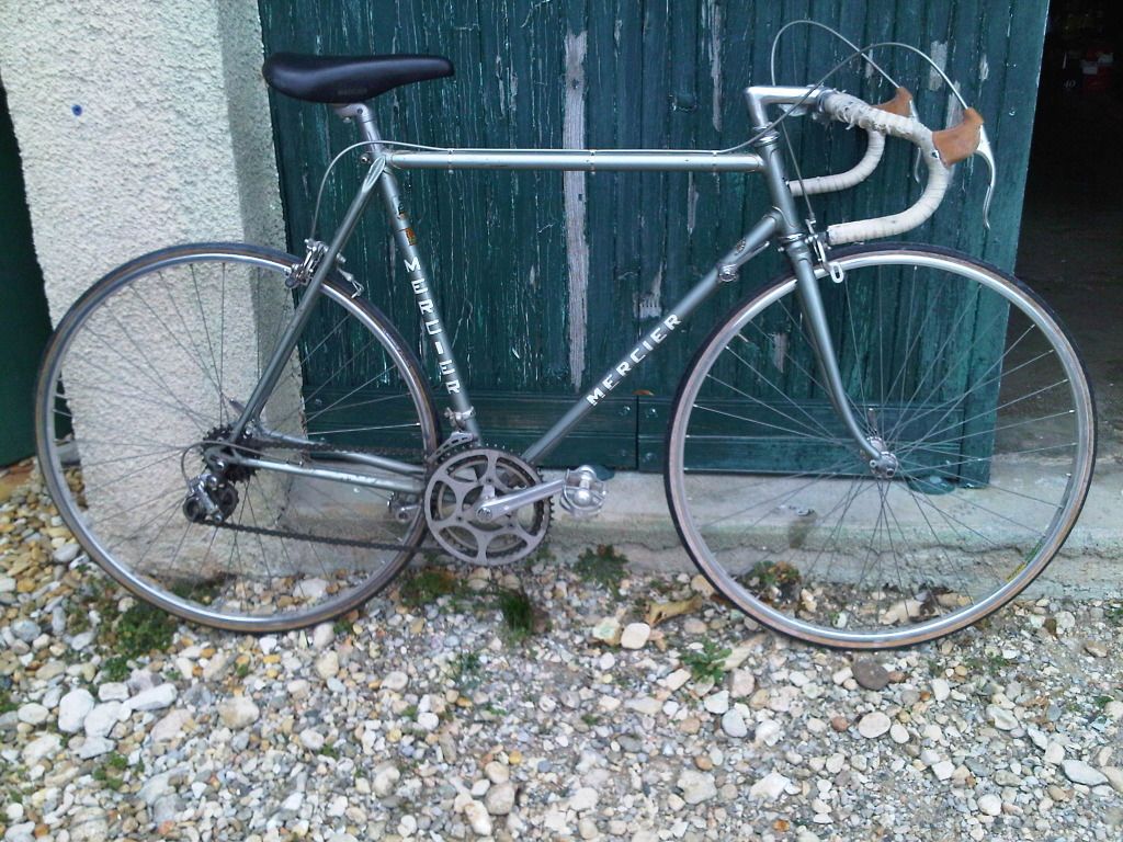

You see a few Merciers on French eBay and also on Leboncoin (similar to Gumtree) - they were an important brand once. The Poulidor pink 531 racing bikes are a popular choice for restorers, and they did a nice blue one too. I have a grey one:
It has the similar decal style to yours. At some point I'll find the time to strip and restore it, it's complete and original. I think mine is from '76 based on the Shimano 600 components, but I could be out by a year or two. If you want to see more restored Merciers have a look at this French site:
