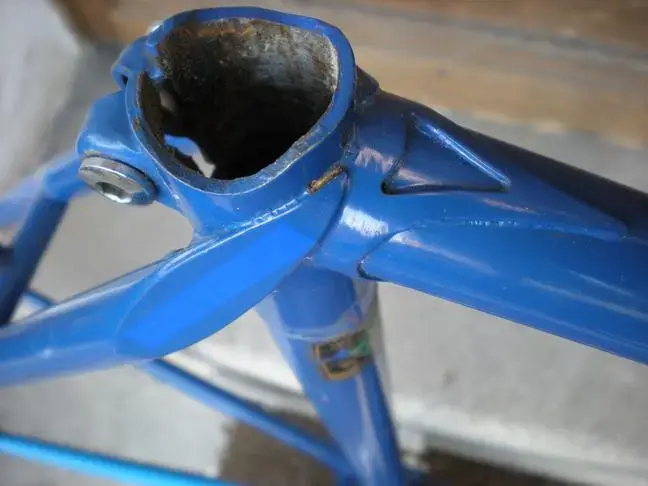

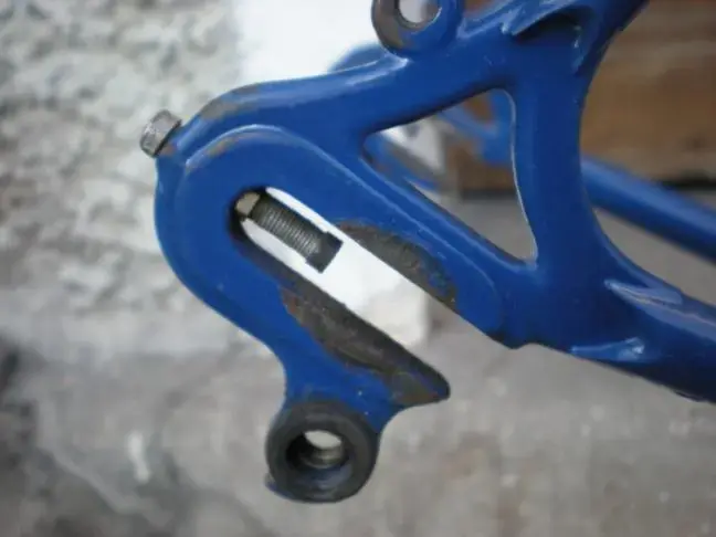

I got this bike on ebay, intended as a donor for my peugeot build. However it looks to be a rather nice frame. Full 531, campag dropouts, wraparound stays. I found one reference to Bosdure on a french forum, which claimed that they re-badged and built up frames from elsewhere. Apparently cycles Bosdure still exists in Puy (France), so I will get in contact with them to see if they can give me more info. Present plan is to take it apart (already done), clean & grease it, and put it together again.

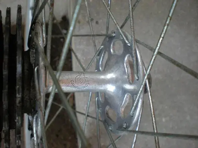

It came with simplex deraillers, 3ttt stem and bars, CLB brakeset, mavic rims on large flange campag hubs. Can anyone identify which campag model the hubs are?

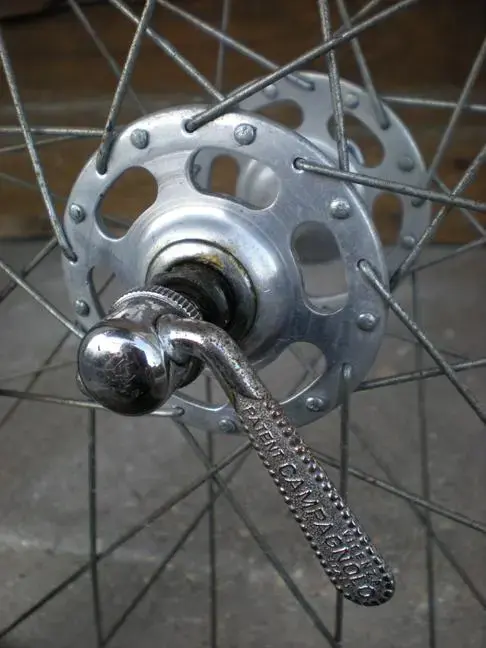

pics of the wheels
unfortunately the rear QR skewer is cross-threaded, and the nut has pieces missing...
can anyone identify which model the hubs are?

Looks like a neat frame to me, HQDP
Intended for touring? I spot the triple and eyelets.
I am afraid I do not know what hubs you have there.

Well, they look like Records but don't have the centre grease port and clip and they have straight lever QR's which are early-ish. They also have the 'flying wheel logo' rather than the 'globe' one. Nothing to match on Velobase website. A puzzle?
Stronglight crank removers are available and I have a contact who can supply them. Don't be tempted to try anything else as you might damage the threads.
The triple is 51-42-32, with a 6spd 14-22 block, so not inconsistent with light touring, but not enough for fully laden alpine climbs (at least for my legs!). I believe that many french bikes of the period had mudguard eyes (see for example the top of the range peugeot 1979 PY10 here) so I don't think we can conclude much from the eyes.
I also looked for the hub model on velobase and campag catalogues, and didn't spot anything similar.
