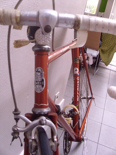

Bought this one today,

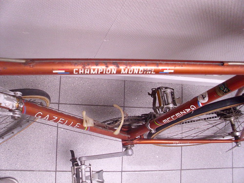

paint is still good except on the topbar it is in bad shape (has lots of rust spots.. see picture)
Would RX-5 and enamel paint be able to restore it?
(ill post pictures soon)

Looking forward to see it
Carpotec RX-5 with enamal from the model build shop is exactly what I use in chipped areas/areas with paint off. Sometimes I even go with RX-5 only if I want to preserve a patina and/or want to avoid a bike looking touched up. A spray silicone spray when I park away a bike for a longer period.
RX-5 is great stuff. Easy to work with. It is very liquid, it flows to everywhere within the chipped area and the result is a thin layer you won't notice. Normally I use pencils 00, but also 0, 1, 2 in case the spot is (very) large.

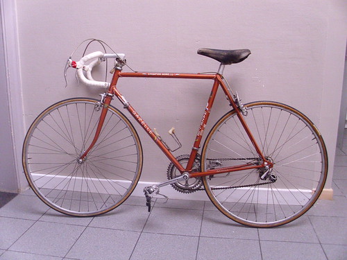

it has a strange mix of components by the way,
Front mech = campagnolo,
rear mech = shimano 600
brakes (claws and levers) and headset are dura ace,
Is this the original set up?
Ill have to check the catolog of 1978 i guess...
