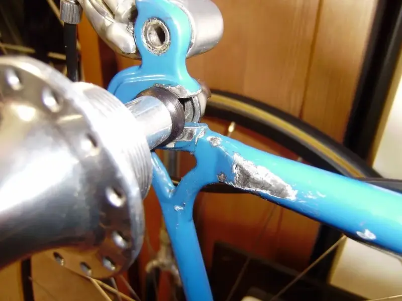

Just gave my training bike a check over...found a crack all the way through the rear drive side dropout!
Oh booger...looks like i'm on the lookout for a new frame?

I think he's still on the go, must be getting on a bit though as I remember the name from the dim and distant past LOL
Shouldn't be too difficult to re-braze back in a new rear dropout.... unless you are looking for an excuse to buy something else :D

Just found his card frame price list with phone number...guess i'll find out on Monday when i call?
Here's the damage. :(
Very nice frame too.

Nasty. Glad you found it before it broke in the middle of nowhere.

Any competent welder should be able to vee that out and weld it.

Spoke with 'Charlie' yesterday...still doing repairs but not building anymore.
Should hopefully be back on the road in fortnight.
P.S. you mean brazed dont you not welded...too much heat and all that.

No, you should be able to weld that without putting enough heat in to melt the braze or affect the strength. The dropout is higher carbon steel, so I'd use MIG with CO2, because it'll be harder a harder weld than with argoshield. File it to a vee, weld it as a series of penetrating tacks letting it cool in between each, dress it back, job done. You could wrap a wet rag round the frame ends if you wanted to stop the heat getting into the braze, but I doubt you'd have to.

Ahhh, just twigged (I think), you mean cut out the fractured segment of dropout and weld in a new fillet of metal keeping the dropout.
I was under the impression that you had to replace the entire dropout by melting all the original brazing and fitting a brand new dropout..

Precisely...know any in Glotershire?

I had a similar looking break in one of my frames - and I just had the drop-outs replaced, rather than trying to weld back together. Steve Goff, Skelmersdale, Lancs (just off the M6/M58) did mine 'cos he's local to me, and did a truely excellent job.
