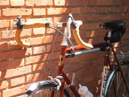

1983 Trek 600
Frame: Reynolds 531C double-butted manganese molybdenum main tubes, Tange alloy stays
Fork: Tange alloy
Headset: Specialized sealed bearing
Stem: Nitto Technomic
Handlebar: Nitto Randonneur
Bar Tape: Soma Thick ‘n Zesty brown
Brake Levers: Dia-Compe Royal Gran Compe RGC200
Brake Calipers: Dia-Compe Royal Gran Compe RGC500
Brake Pads: Shimano 105 road pads
Brake Cables: Shimano Dura Ace cables and housing
Shifters: Suntour Superbe LD-2000
Front Derailleur: Suntour Cyclone MK-II
Rear Derailleur: Suntour Cyclone MK-II GT
Derailleur Cables: Suntour Superbe
Cassette: Suntour Winner 13-14-16-18-21-26-34
Chain: KMC Z7
Cranks: Sugino XD2 Triple
Chainrings: 26-36-48
Bottom Bracket: SKF square-taper
Pedals: Suntour Superbe PL-4000
Toe Clips: MKS chrome
Toe Straps: Ale leather
Rims: Sun CR-18 700C
Hubs: Suntour Sprint
Hub Skewers: Suntour Superbe
Nipples: Brass
Spokes: Sapim Race
Tyres: Vittoria Randonneur Cross 700x28
Tubes: Kenda
Note: wheels beautifully hand built by Jude Kirstein of Sugar Wheelworks in Portland, Oregon
Saddle: Brooks Team Professional
Seatpost: SR Laprade
Seatpost Binder: SR
Bottle Cage: Specialized
Extras: Blackburn Expedition Rear Rack, Blackburn frame pump, Velo Orange Stainless Steel Fenders
Weight: 25.9 lbs.

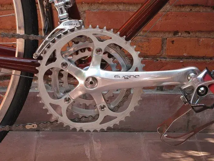

Very nice, however the positioning of the front mech looks incorrect if you want to use the big ring.

Thanks. In the photo it does look like the front mech won't reach the top ring. However, it shifts perfectly. While on the top ring there is just enough clearance.
