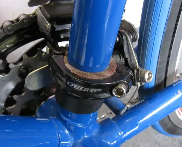

The front mech gave the most headaches, designed for a 50mm chainline. I'd got the cranks down to 46mm with the shortest bottom bracket I could find. The answer was a purpose made eccentic collar made from tuffnol on my lathe (see pic).

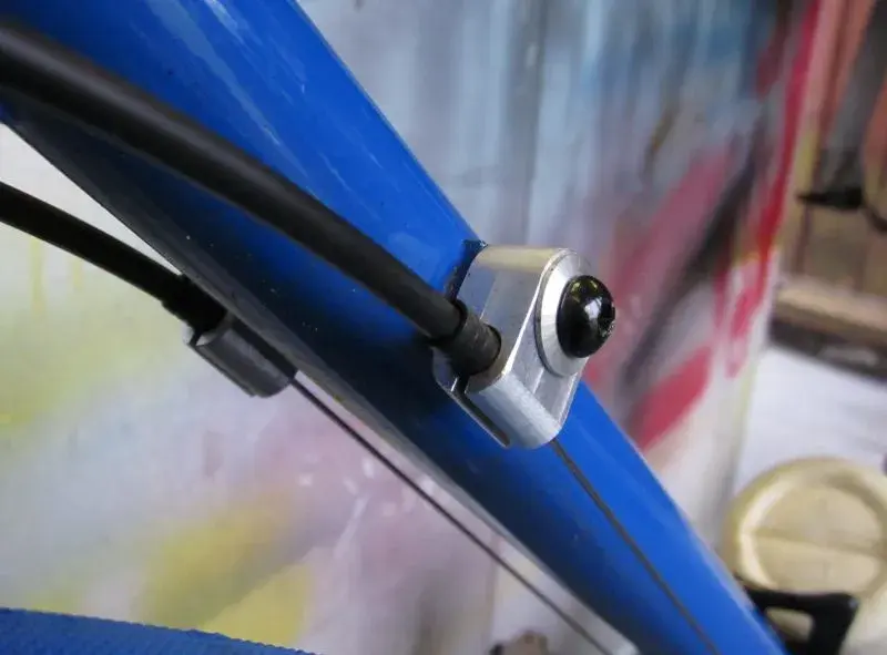

Othe bits made to measure are the cable stops for the gear cables on the downtube braze-ons and rear chainstay.

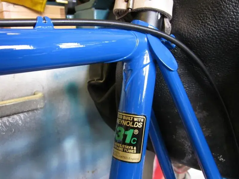

BTW Frame No. WM4001667 and given the detail in the pics, can anyone help me put a model name to the frame? It used to have "Raleigh" in hollow vinyl cut letters on the downtube an has a Campagnolo transfer at the base of the seat tube. It was bought as a frame, not a bike.

Another pic
