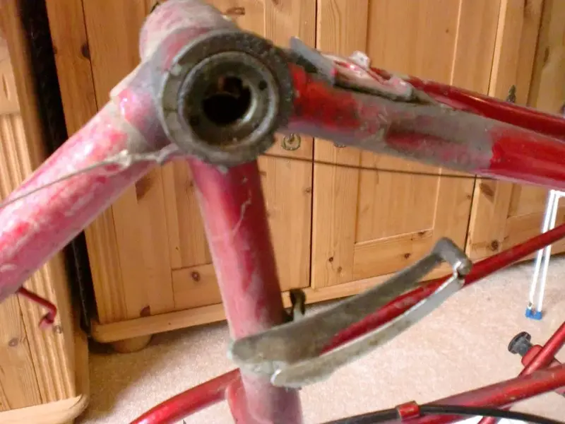

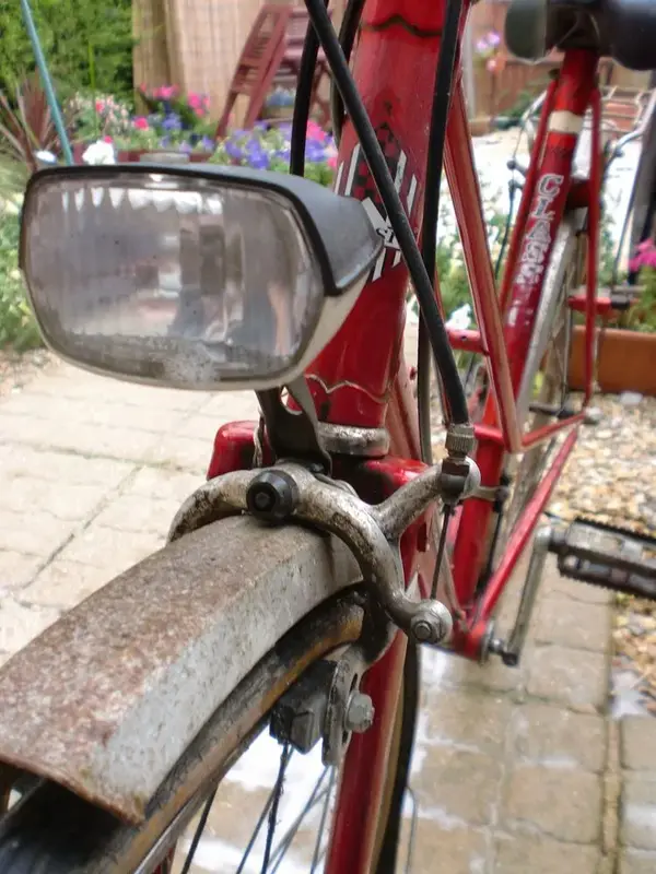

Following on from my last 1991 Specialized Hardrock restoration http://www.retrobike.co.uk/forum/viewtopic.php?t=163607 I opted for a new challenge
This time a circa 1980's "classic" touring cycle 27inch wheeler, I know its a non descript bike in fact I know, I know very little about it, but it belonged to my Wife when she was kid and therefore worth giving a go.
What initially looked like huge challenge has actually turned out not to bad during the strip down stage, only problems were with the crank arm cotter pins (need new ones) and the aluminium quill "welded" in to the steerer, a big bashing and applying boiling then freezing water helped the stem contract and break its 30 year bond (26 years since this bike last saw daylight) again a new stem is now required.
new tyres & tubes ordered, mudguards and old lamp kit stripped off and thrown away. now just giving deep consideration as to if to try and save the wheels or try and find a new set? also looking forward to lots & lots of metal polishing....:)
File comment: before I start just a quick wash

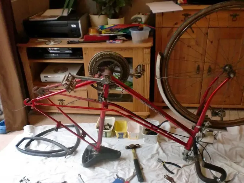

‎3.5 hours of sweat & tears and an Epic fight with two cotter pins and a seized Alloy Quill stem and now the frame is fully stripped and almost ready for paint prep

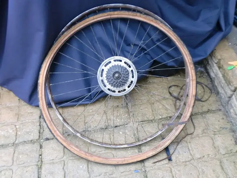

Budget is small on cash big on hard work, so far a pair of Schwalbe 27 inch amber walls have been had for £10, new cotter pins £3.00 and a Quill stem £12 add another £30 for cables/nuts/bolts/paint & grease plus a set of brake blocks & bar tape and possibly another £40 for wheels if these don't clean up and should just about be it?
(although I might be entitled to shares from the makers of wire wool by the time I'm finished)
PostPosted: Sun Sep 04, 2011 11:09 pm
Joined: Mon Mar 02, 2009 4:22 pm
Posts: 1604
Those rims look a bit past it, but if they're straight with no dents (and you don't mind the crusty look) they will brake ok with a set of old style brake blocks. I keep my eye out on eBay for chrome rims in good condition, but they don't turn up very often. Like you say, if you're desperate, a pair of new alloy ones is about £40. There is a seller on there doing polished alloy ones if you don't want the satin anodised look.
PostPosted: Mon Sep 05, 2011 6:37 am
Joined: Sun Aug 28, 2011 9:34 pm
Posts: 29
Location: Haverhill UK
Thanks for the advice, as far as I can see there is very little pitting and the rust is just surface rust, I will test a section of the front wheel with chemical rust remover, metal polish and elbow grease, depending on the result, it's either new wheels or strip the wheel down to the bare rim and carry on treating these to some loving care and attention, along with a good dose of wire wool.....more pics to come once the frame is painted, as new parts arrive & the old metal bits get a spit & polish....

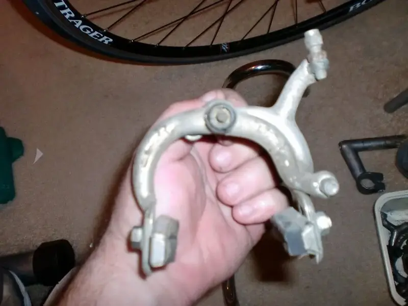

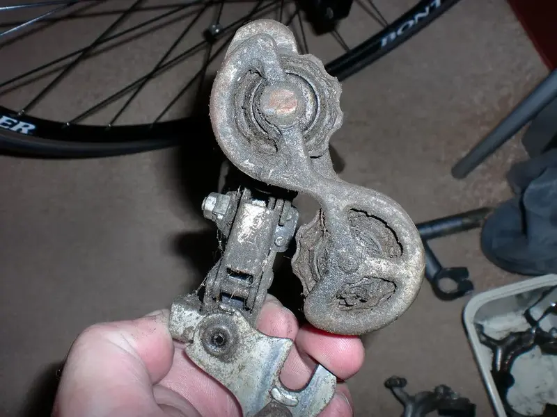

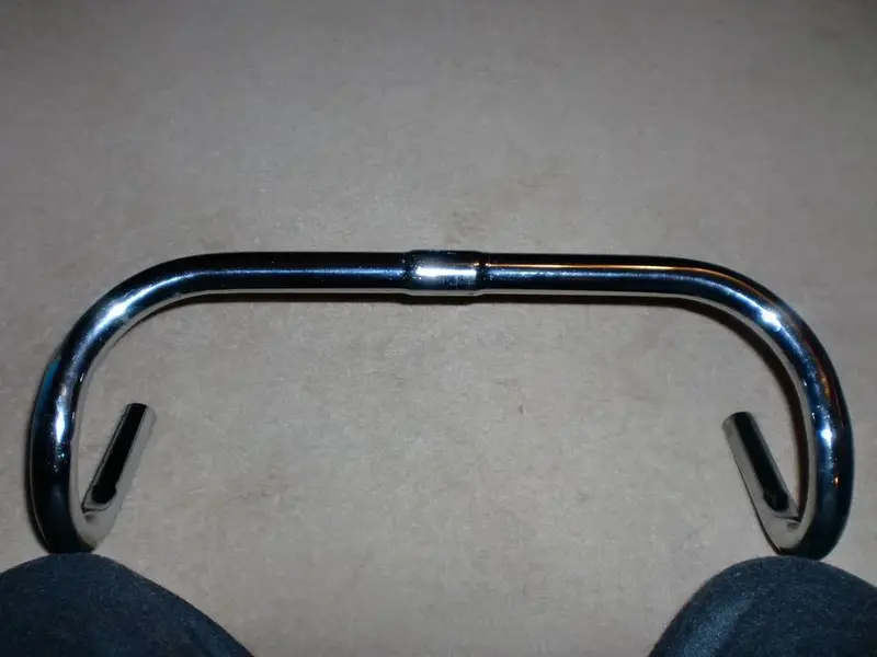

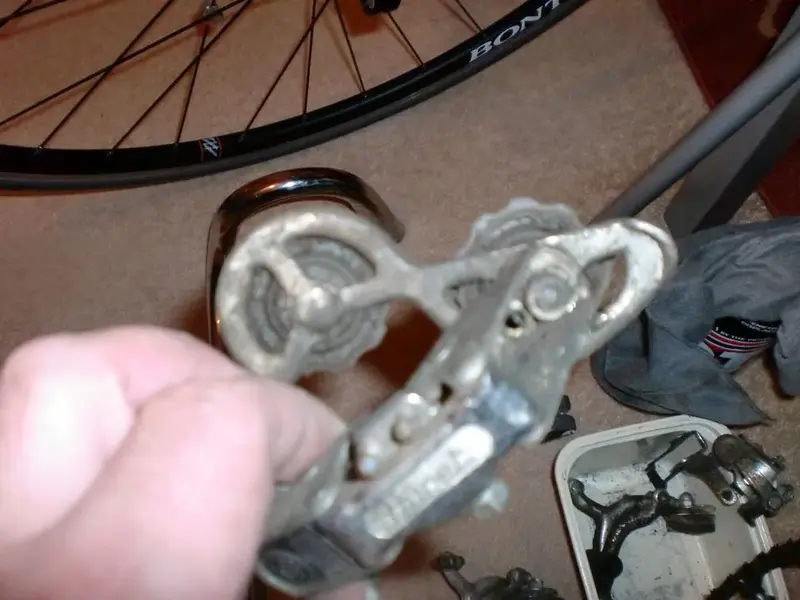

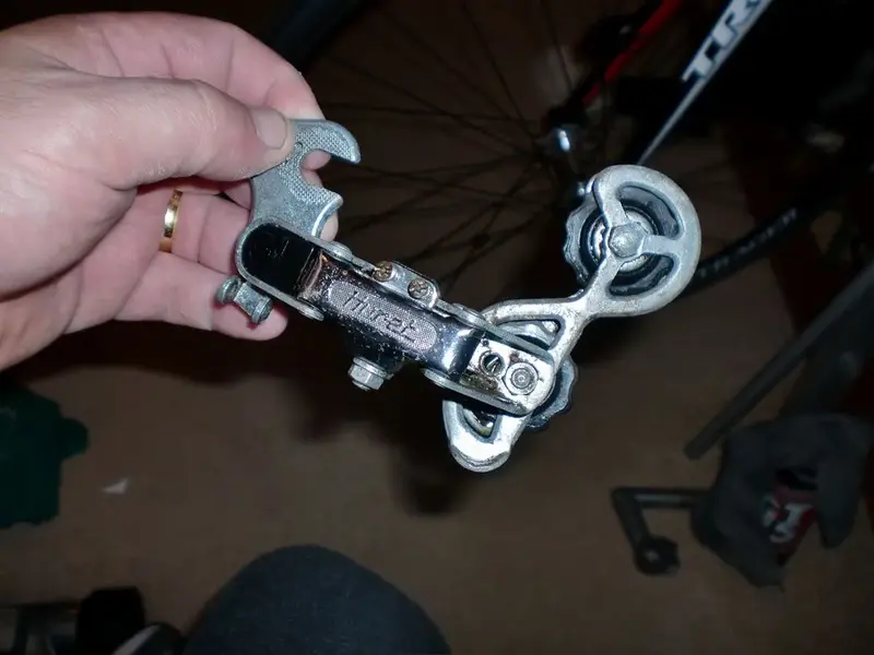

so one to the metal work, gave it all a good thorough clean, probably shaved half a pound of weight in old grease & yuk alone, next job before painting the frame will be a polish of the detailers and brakes to bring them up all nice and shiny

more metal work
