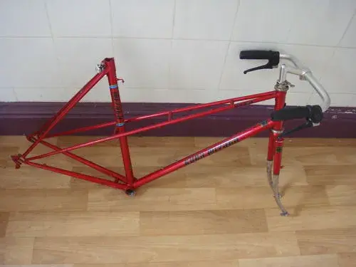

I have the pleasure of completing a rebuild of a koga miyata. Not sure what model the frame is, but hey this going to be fun to rebuild.
Sorry but not completing a full retro rebuild, but you have fun in rebuilding a bike that will last a lifetime.
The frame has been taken to Bob Jacksons and have been completing a number or changes to make the bike workable as a full touring bike.
The frame is 130oln, but take 27inch wheels, but will be kitted out with 700 wheels.
I will have some new weld points to take cantis and a full loaded front and rear rack.
I got the frame for 37 off ebay and will update the page as I complete the rebuild.

Thought I would recap on the weld points that I have having put on:
- brakes on for a front a rear rack
- taking off the existing front brake-on, which would not take any weight
- cantilever points for the front and rear
- seat stay bridge for the cantilever cabling
- I was thinking of putting down tube braze-ons, but have followed the advice of Jackson's and having them placed on the head-tube - this appears to be their favoured position
- the chain stay - I am removing the existing cable stop, which is the top and then having on placed on the underneath
The frame will then be sprayed a mealtice burgundy/red. Unfortunately the crome has to go. I found at the whole for was chromed, but only the bottom 3rd showing. Having looked at the price of rechroming, as the bottom 3rd is in poor condition, I have decided it is uneconomical.

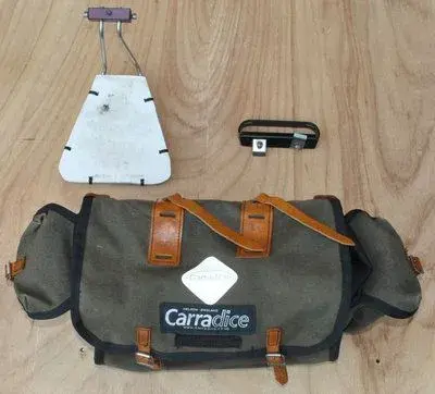

starting to get the gear for the bike, first a saddlebag:

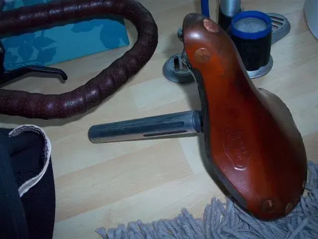

Now finished the trecking bars, with brooks tape and 7 speed bar ends and adapter. Found a nice brooks handle bar bag that is age(ish) appropriate.
The seat post is original 26.2 and a nice books professional s.
