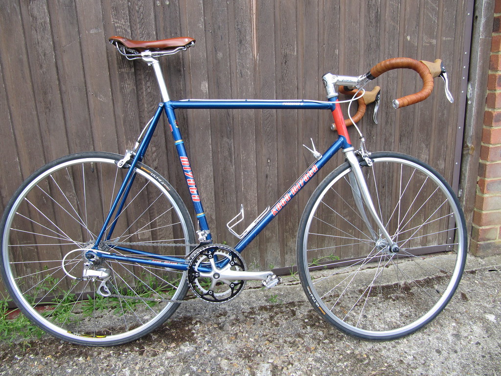

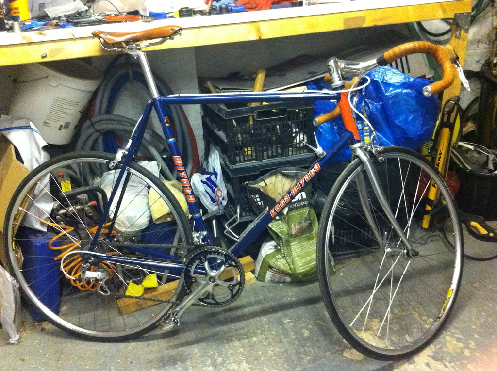

This is my first go at building an old school road bike
1981 (so I was told) Koga Miyata Proracer S with a mix of mainly Dura Ace 7700 bits and modern parts. I'll post up better pics when I get some done in the daylight and I'll add a spec sheet (still need to source some 7700 cranks and a better seatpost)

Thanks for the info on the catologues. From those mine looks like 1984 frame. Certainly not an 1981 as I was told when I bought it
I planned to build a bike that looks retroesque but has some of the functionality of a newer bike hence the 9 speed gearing and better brakes
IIRC The forks are a pair of Kinesis aluminium ones. Nothing too fancy but a lot lighter than the originals. And these don't have a stem stuck in the steerer :)
You are quiteg correct as it does ride very nicely

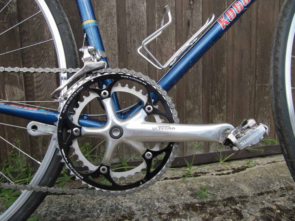

Spec list
Frame: Koga Miyata Proracer S (60cm)
Fork: Kinesis aluminium - 1" ahead
Headset: Campag Chorus
Stem: Synchros 1" ahead 120mm road stem
Handlebar: Nitto Grand Raundoneur
Bar Tape: Brooks
Brake Levers/Brifters: Cane Creek SCR5
Brake Calipers: Campag Veloce 2010
Brake Pads: Standard Campag
Brake Cables: Shimano inner with white Demolition BMX outer
Shifters: Shimano 600 Aero
Front Derailleur: Shimano Dura Ace 7700
Rear Derailleur: Shimano Dura Ace 7700
Derailleur Cables: ?????
Cassette: Shimano Dura Ace 7700
Chain: SRAM PC951
Cranks: Shimano Ultegra
Chainrings: Specialities Alize
Bottom Bracket: Shimano Ultegra
Pedals: Shimano SPD,s
Rims: Mavic Open Sport 32 hole
Hubs: 2010 Shimano Tiagra
Hub Skewers: 2010 Shimano Tiagra
Nipples: Don't know
Spokes: DT Swiss
Tyres: Continental Ultrasport
Tubes: Continental
Saddle: Brooks Swallow
Seatpost: cheap aluminium till I finalise the seating position
Seatpost Binder: Standard
Bottle Cage: Spesh Aluminium
Extras: Polished Hope bar plugs
Weight: no scales
[/img]

The frame uses Miyatas own Hardtlite FM-1 tubing, the top set for that year. A year later spline butting was added to the FM-1 specification. Another great feature with the frame is the paint: beautifull deep and durable quality.
