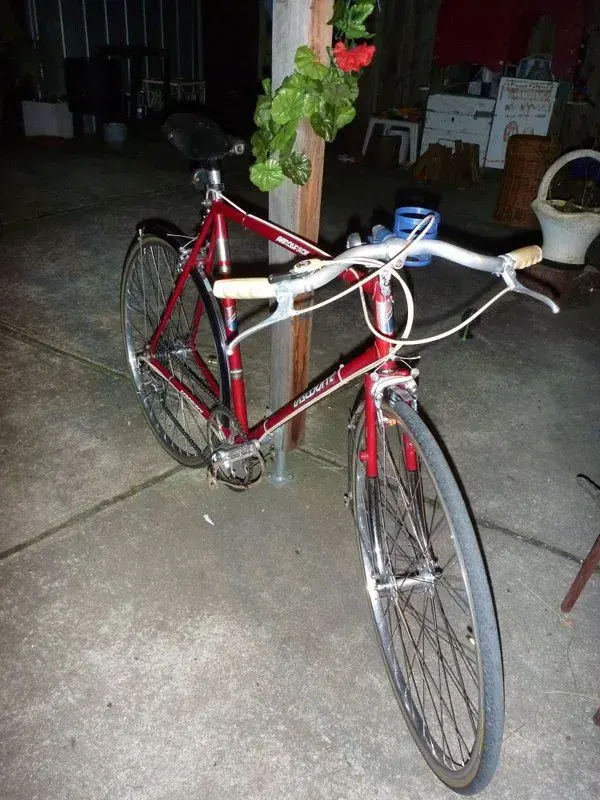

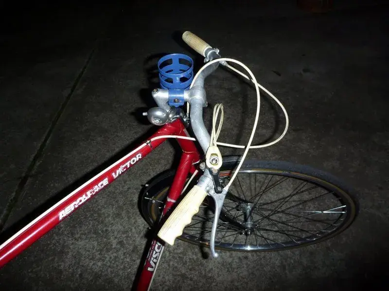

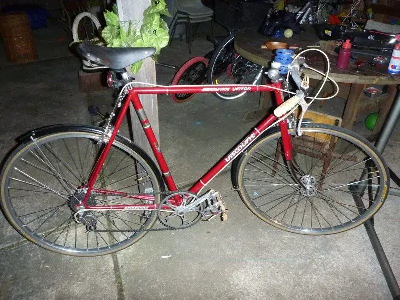

Hi all
Newbie here. Probably can't post any pics yet but I'll try. Here are some of my Viscount Aerospace Victor. Recently flipped its original bars and am finding the position really good: lower than hoods but higher than drops, with good width for stability.
The cup holder is also important. :D b

thats a nice viscount , are the forks alloy or steel ? if alloy consider replacing them as very prone to break without warning

thanks Biggs. The forks are cromoly. The aluminium fork is plain silver and has a sloping crown, and it was only ever sold on the top spec Aerospace Pro.
The actual number of reported failures of this fork were few, but the replacement program by Yamaha in the US (Viscount's US distrib) helped to fuel speculation. Oh, and it was nicknamed the "deathfork" which is something that sticks in people's minds. In recent years both Cervelo and Giant have both had fork recalls as a result of failures during normal use, but neither of those companies' forks got the nickname.
Seems it's a name that can only be used once. b :?

nice bike and an interesting set up
thats an odd bottle holder!

Thanks Bowser. The bottle holder's odd because it's a cup holder... for cups of coffee! b

if that cup holder is the right size for a can of boddingtons and a large straw you could patent it

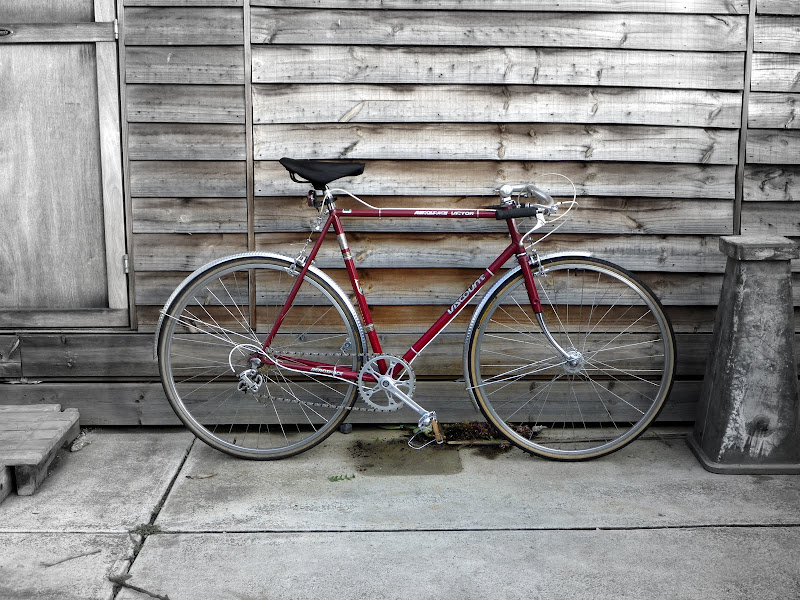

Here's a pic of the new "iteration". The DA gear shifter was adapted to work with a Velo Orange thumb shifter mount. Other changes: smaller ring (47T instead of 53T), VO seat cover, Honjo hammered mudguards, Nitto Dove bars, CR18 rims on Viscount hubs with DA Oro 5-speed cluster. Cup-holder not pictured. b
