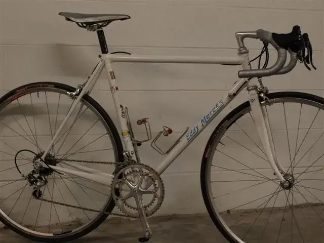

It originally wore neutrons and an ibis stem
Then it had a crack, inspection and repaint
Now it sits like this - found a 10 rise nitto stem and a concor saddle.
Heavy, solid. Great handling.
File comment: Current
File comment: AFter repaint
File comment: original

Yeah this bike seems to wear old components or new components well - it's quite timeless. Due to the repair issue I've had it two years now but really only put less than 1000km on it probably.
I do think the bike is slightly over-hyped. I think the handling is really dialed but I wouldn't say it was a fun bike to ride at my weight of 155lbs in season. I don't ride particularly rough roads here in Vancouver Canada so don't benefit from the tank like properties as much. I do think larger riders would probably see more benefits from the tubing.
While I do love this bike I'd tell people to watch out and do good inspections of these frames. Iv'e seen various images now of people with the same repair issue I had - which was hairline cracking in the lug edge (where it meets the tube) of the bb/dt socket. I peered inside the bb shell with cranks removed and there was what I'd say to be a VERY poor brazing job. You could see no evidence of brass coming into the bb socket, the tubes come into the shell and look bone dry! There was definitely not enough preheat while brazing and poor penetration of the brass. I say this as someone who's built 6 frames - an amateur but one that knows what to look for!
Also - the rear bridge on my bike was mounted really low. Meaning that my record calipers have the pads in the upper most position. This makes even the teeniest of fenders (CRUD2) barely fit! I've also heard more than one MXL owner complaining about low brake bridge mounts. This will pose issues for you dudes who like to run 28's and larger for tires.
If you get one that fits, and is sturdy it's still a great bike. I'm keeping mine!

http://www.bilenky.com/Home.html did the repaint.
But I got the decals from a guy on ebay named cyclomondo. He can custom the decal colors to suit your needs
http://stores.ebay.com/Cyclomondo?_trksid=p4340.l2563
