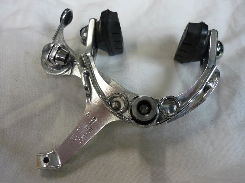

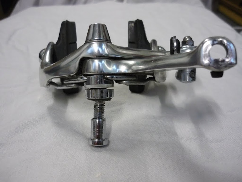

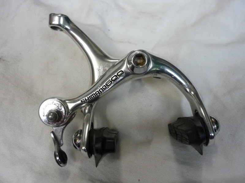

Rear brake caliper below. Look to be in pretty good condition, but as can be seen in the second photo the pivot bolt is slightly bent. Not sure if this is going to cause any issues?

On the calliper I can say that you could disassemble it and try to carefully bend it back. Or source another (donor) calliper. They are not that hard to find.
I did disassemble it the other day to clean everything, but didn't try and straighten it. I may mount it and see what it looks like before taking apart again.

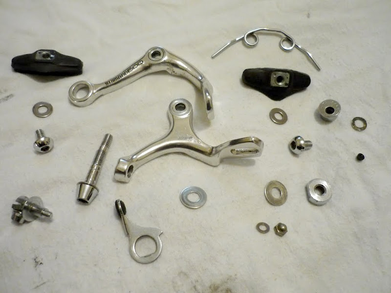

The caliper fully disassembled:

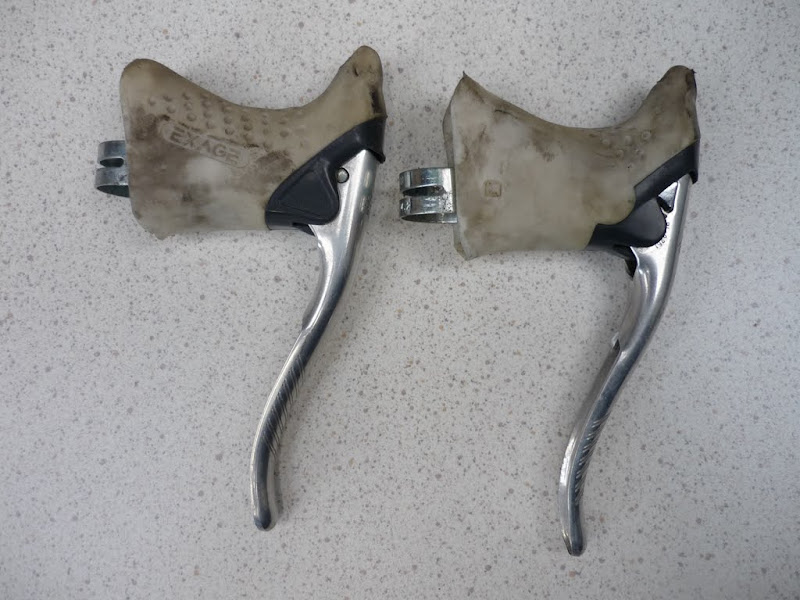

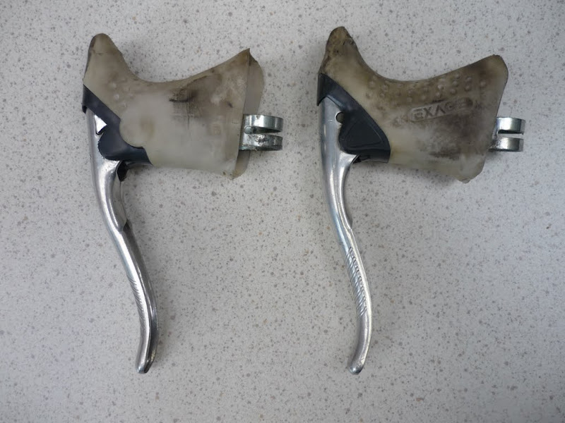

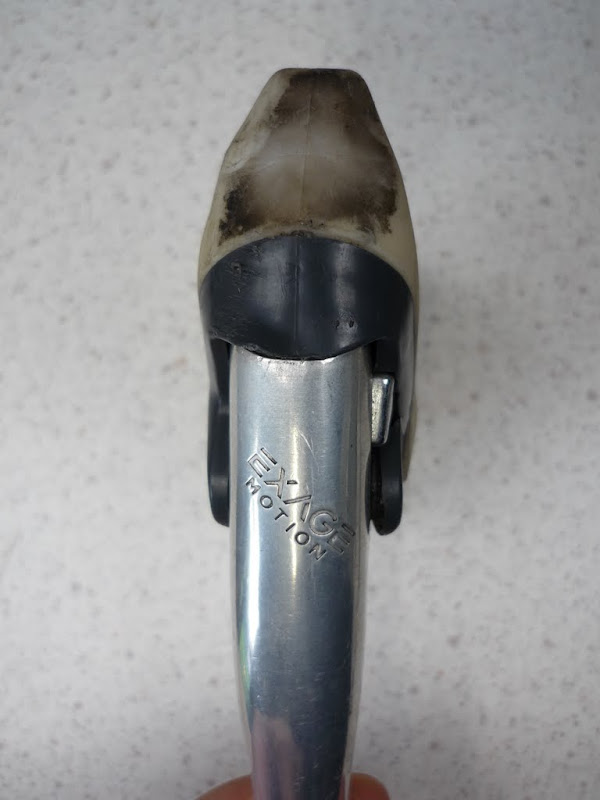

Here are the Shimano Exage Motion levers that came along with the parts. Hoods both need a good clean but the levers seems to be in good shape.

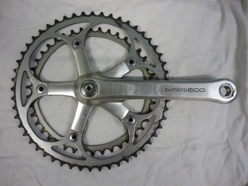

Have a question on the bottom bracket size for this frame. I am presuming it is English BS68 but an not sure on what spindle length I should be looking for? I am planning on putting on a Shimano 600 double crankset as pictured below. I have been looking at the Shimano UN54 Tapered Axle bottom brackets, but am unsure how to determine the spindle length.
I think 116mm
Very kind from the previous owner to donate the Exage levers, but why not try to find NR panto'ed levers to match with the shifters? :D Are you intending to set the Gazelle up as rider, showbike or a bit of both?
