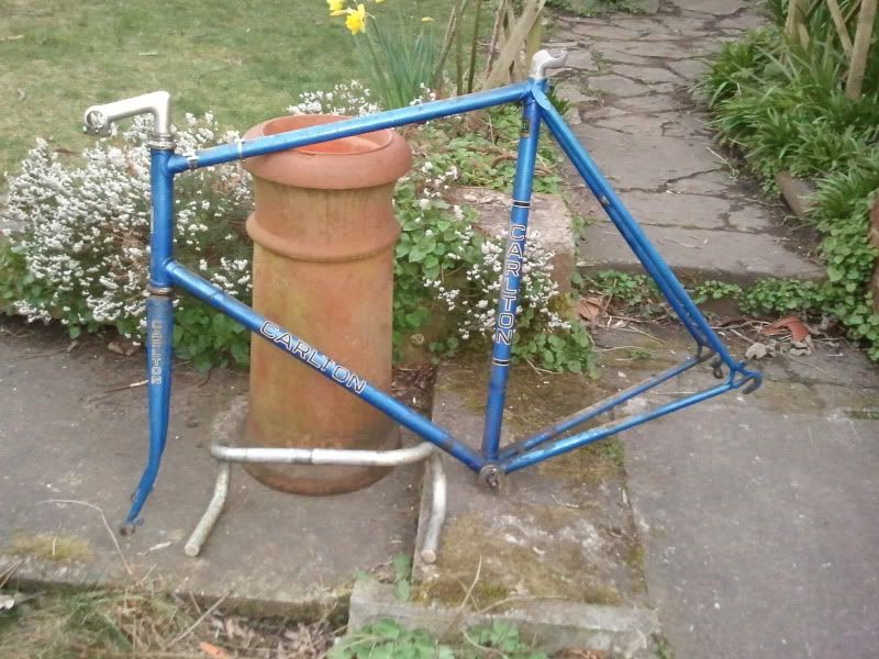

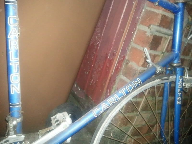

I found this in the deepest darkest corner of my shed and after quizzing my landlord about it - it turns out it's his. I've been looking for a new project for a while now so this looked like a perfect fixed gear project.
My landlord said I could have it, and so the FG project began...or so it seemed. I stripped the bike of all it's componenets before realising it's measures in at 60cm which is far too big for me. I'm pretty gutted about it to be honest as I was looking forward to riding fixed.
Anyway, since I've already stripped her I decided to just do a restore and pass it back to it's original owner good as new.
Most of the main componenet are now all cleaned up and I've started wire wooling any rust on the frame. Once that's done I'll paint strip her, fill in any pitting caused by the rusting and get her resprayed back to that lovley blue and get some decals made by my Dad (who's a screen printer).

Looks very much like a Carlton Clubman frame as I had a red version of this.
Good luck on the renovation

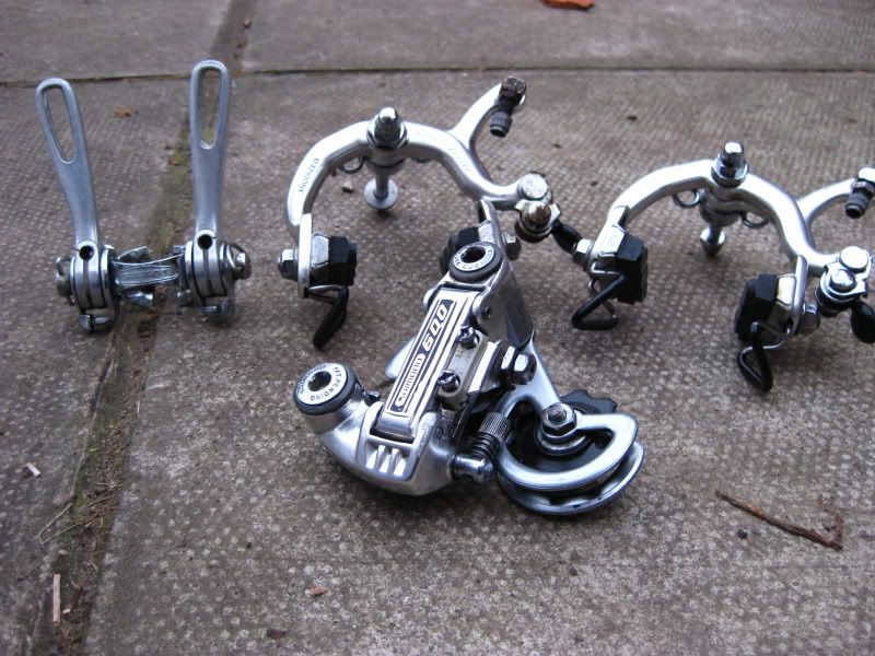

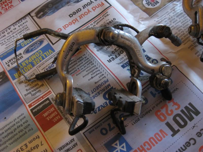

You've done a good job on getting the brakes and gears back to condition. They looked a bit far gone initially but it's surprising what can be achieved with a bit of work and elbow grease.
Did you say 'decals made' and 'Dad' in the same sentence? Interesting.

Ha ha! Yes you did a good job there! Glad you did not go fixie route. Far too much of that about! There is only a limited fixie fixation before you get banished to another well known site!!

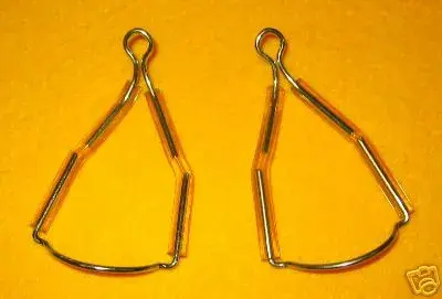

Hi,did i spot a flint catcher?,don,t see them now very often
Look again, in the uncleaned photos above :wink:
I've cleaned them separately.
Finally got the stem out, took a bit of gentle persuasion that included a block of wood, a lump hammer and loads of WD40.
Next I need to somehow get the seat post out, which is dug in there good! It's going to have to be a blow lamp job as I can't get the leverage to twist the post. I just need to find out whether Steel or Alu' expands first. If it's the Alu seatpost, then I have no idea what I'm going to do.
I'd be very much interested in knowing just how I might achieve the same results; how did you clean them up so effectively ?
Autosol ? . . . . . . . and elbow grease ?
