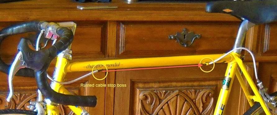

jCymbal wrote:
Here's a close up:
I do not recall seeing these guides before. Not typical for that era. On top tt was standard. I have seen braze ons left under tt on later models, but those braze ons look slightly different. I must say it is imo the superior way to route a cable in case of aero levers. Maybe it was a specific custom request, but I also think I can not eliminate the assumption that it has been refinished at some later point.
Btw I would think that you could get that 1st braze on tidy again. Dremel rust away with steel brush, a good base and than yellow - should look good in the end if done properly.

Well, apart from the serial (1986) and the reynolds decals (1981-1985) everything else looks from 1989. The Gazelle catalogue from that year shows (2nd page) a yellow gazelle with with those cable stops exactly.

Yes, I noticed. I thought on your pic the stops/guides looked slightly different. Moreover the catalogue bike has a later aero inspired crown.
