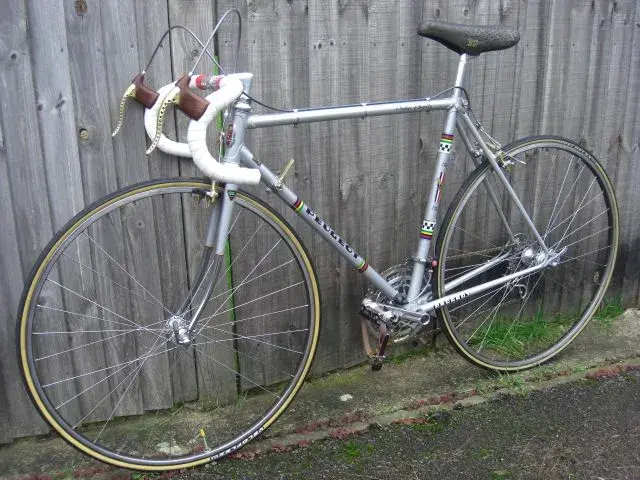

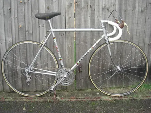

Well I have finished the Peugeot PR10 off.
The bike was burgundy red but had it blasted, now has a bit of a 'Thavenet' theme, well nod to - going on, silver with a few gold accents.
The original forks were crude, I had a nicer set around that fitted which was lucky.
Had to change a few bits to get it where I wanted.
Velo orange french threaded sealed bottom bracket was a good spend.
Used most of a velo orange headset aswell, but had to use a different locking nut.
Cinelli 66-42 bars
Campag shifters replaced the simplex criterium which were mank.
I went for a 3ttt saddle, could not find a reasonably priced ideale 2001 but this fits the bill exactly. I have also reconditioned the original Ideale saddle and keep swapping it over can't make up my mind which looks better.
Stronglight 49D crank cleaned up well....

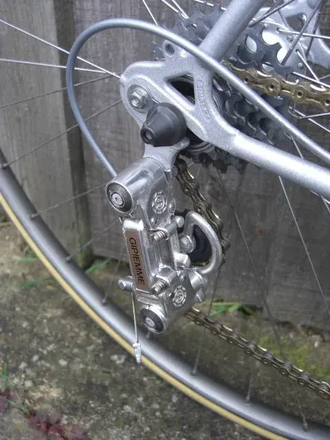

Rear deraillieur is a gipiemme badged Simplex super LJ...works lovely.
Lovely little bike. Turns in fast, enjoyable to ride....already came off though, slipping on wet leaves ha! ha! numpty.Funny how you get connected to these damn bikes
PEUGEOT PR10 - Makeover
Frame: Reynolds 531 - 21"
Fork: Reynolds 531 (replaced the originals)
Headset: Velo Orange
Stem: Unknown
Handlebar: Cinelli 66- 42
Bar Tape: Pro Digital-Carbon (White)
Brake Levers/Brifters: Mafac Competition drilled anodised gold
Brake Calipers: Mafac Racer centrepull with some bits of Mafac 2000
Brake Pads: Generic
Brake Cables: Shimano Dura Ace
Shifters: Campagnolo Record
Front Derailleur: Simplex Criterium
Rear Derailleur: Simplex Super LJ badged Gipiemme
Derailleur Cables: Shimano Dura Ace
Cassette: Suntour Winner 13-23
Chain: KMC 9 speed SL
Cranks: Stronglight 49D
Chainrings: Stronglight 52-42
Bottom Bracket: Velo Orange Gran Cru sealed French Thread
Pedals: Spidel Quill pedals - black cages
Rims: Ascenti
Hubs: Miche sealed
Hub Skewers: Miche
Nipples:
Spokes:
Tyres: Veloflex 20mm
Tubes: Continental - light ones
Saddle: 3ttt SL
Seatpost: San Marco micro adjust - no fluting
Seatpost Binder: n/a
Bottle Cage: None
Extras:
Weight: haven't weighed but reckon 22lbs approx.
Get some well received comments from people, seemed have definitely tapped a nostalgia vein with this bike!!
See what you think for yourselves.

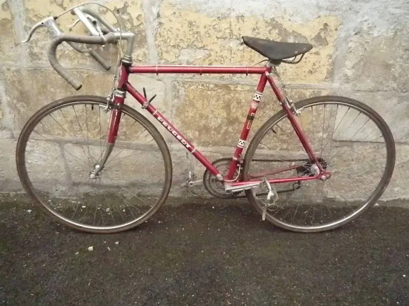

Thought I would put a few more photos up.
It is one of those bikes that looks even better in the metal.
There is a charm about it that I can't quite put my finger on, but then I am biased.
I think it bridges the gap between PR 10 and a PX10....... maybe a PRX 10 ha! ha!

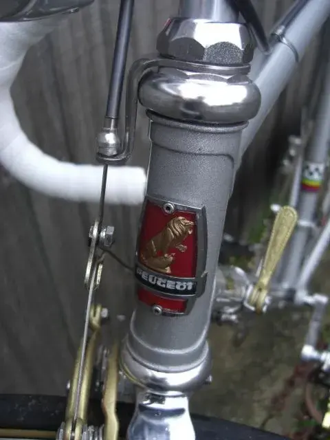

3ttt Seat works well visually, ties in well with the overall appearance. Snatched it a laughable price.
Put some Campag down shifters on, really wanted some simplex ones but could not source any. I have a set of Shimano Arabesque which I toyed with putting on but didn't in the end as I thought I would keep it all European - (In truth the shimano bits are better made though.)
Kept the Criterium front Mech, which works suprisingly well.
I replaced the bottom bracket with a very tidy Velo Orange Grand Cru French threaded item which I am well pleased with.
French Threads are a pain in the arsenal...

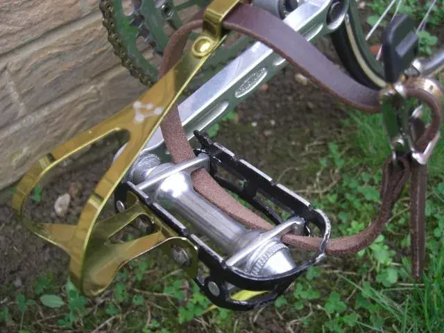

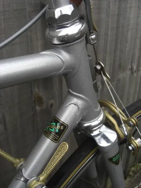

Thanks for the compliments much appreciated....
apologies about the spelling.. Thevenet.
Got her powdercoated in Hackney - Armourtex.
The guy just told me best silver!!! - Think they did a good job.
I had frame and two forks done. masked and clear lacquered for less than £100.
I'll take on board the moans about the saddle!!
Toomski
