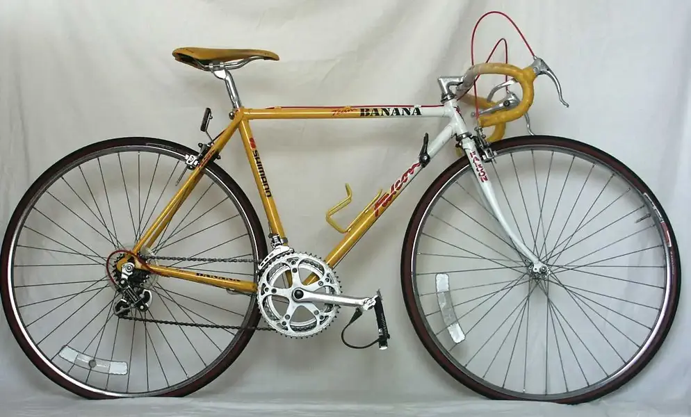

Details below picture.

This is my Falcon Team Banana which I brought a few years ago to get to work when petrol hit £1.25p for the first time. One day the pump attendent said to me that he'd never expected to see the day when it cost 20 quid just to fill a motorbike! It got me thinking about cycling to work to save money. I tried it once a week for a few weeks by mountain bike and liked it but I wanted to be able to get there faster than one and a half hours I realized I needed a road bike. I remembered drooling over "Team Banana Falcon's" in my mums catalogue when I was a spotty child. There was something about the yellow and white frame that made them look very special.
There were a lot for sale on Ebay most were too big and made outlandish claims about Reynolds tubing. All I could see on them was the British Standards sticker... Surprisingly quickly a 17" one came up near me. What clinched it was that it was the only one I'd seen with the original handle bar tape.
I picked it up from the seller in Booths supermarket carpark in Clitheroe and pedalled home. I remember doing a quick sum and realising that if I rode once a fortnight to work during British Summer Time then It'd have paid for itself in about a year. That plan quickly got quashed because my office relocated to almost next to the railway station so motorbike and Team Banana got retired to weekend duties.

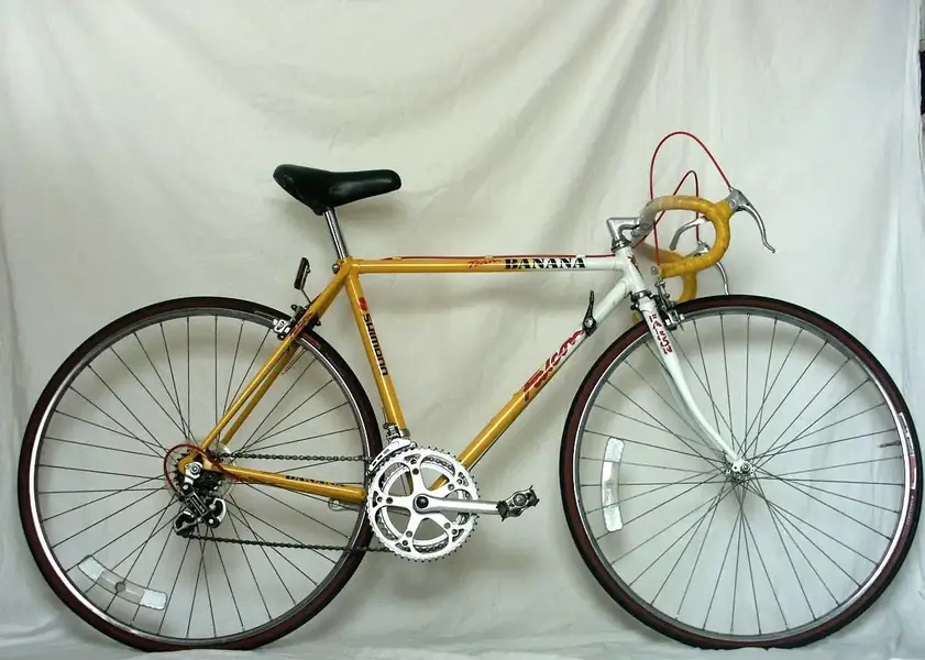

As brought.
Note the clumsy steel pedals and chromed seat pillar. Selle Italia saddle is not original- I think they had a hard yellow saddle- and has been replaced by a yellow gel one.

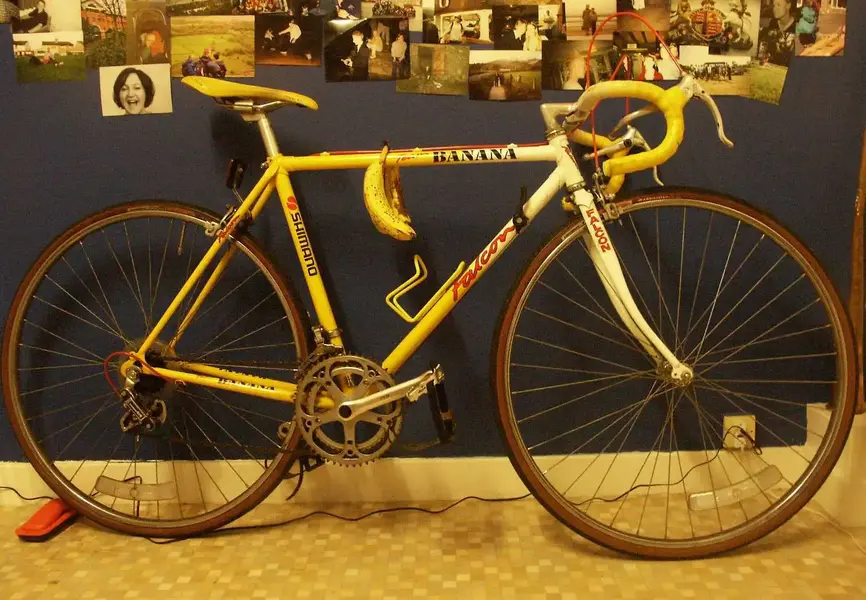

Specs, square brackets show original equipment that has been replaced.
Frame: 1020 guage (Plain) steel 1" diameter dog leg rear dropouts.
Fork: 1020 steel, flat crown, external lugs
Headset: Threaded, unknown provenence
Stem: Sakae
Handlebar: Sakae Road Champion
Bar Tape: Original fitment graded yellow into white
Brake Levers: [Weinmann] now perforated Weinmann
Brake Calipers: [Weinmann centre pivot cast calipers] now Campagnolo Mirage at back.
Brake Pads: Unknown
Brake Cables: Unknown but with original orange/ red sheathing.
Shifters: [Shimano S.I.S thumbshifters on the down tube], ugh! replaced with Ofmega Master's.
Front Derailleur: [Shimano F.E] Gipiemme LJ
Rear Derailleur: [Shimano S.I.S] Ofmega Master
Derailleur Cables: Unknown but with original orange/ red sheathing.
Cassette: [Shimano 6 speed] Shimano 7 speed now.
Chain: [Unknown] SRAM
Cranks: [Alloy, unknown] Campagnolo alloy
Chainrings: [Alloy, unknown] Campagnolo Centaur ATB 48t, Ofmega oval 38t
Bottom Bracket: Adjustable
Pedals: [Unknown, horrid] Welgo with Zefal Mt Christoph toe-clips, now Ofmega Sintesi with white Zefal Mt Christophe toe-clips.
Rims: [Rigida Superchromix stippled plated steel] Rigida Excel 70's
Hubs: [Sachs Maillard] Campagnolo
Hub Skewers: [Bolts] Zefal security skewers
Nipples:
Spokes: 36
Tyres: Specialized Nimbus 700 28c
Tubes: Specialized 700, presta fitting 700 28C
Saddle: Selle Italia SLR Gelflow perforated yellow leather, vanox (chrome vanadium?) rails.
Seatpost: Campagnolo Aero Chorus aluminium 1" micro adjustable,
[NS 1" Chromed seat post and separate bracket]
Seatpost Binder: [Chrome bolt] Zefal security skewer
Bottle Cage: Nimrod tubular steel, yellow
Extras:
Weight:
Part way through upgrade:

That brings back some memories Rich, I got one of those for Xmas from my Mums catalogue years ago.
Loved it to bits and rode it everywhere.
Nice to see it all so nice and original right down to the bar tape :D
