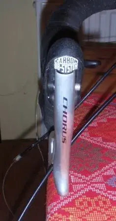

pigman wrote:
chorus groups were for both types - I know I had em.
The destinction is something like (and I'm not sure for defo, so please check) - if the right hand ergo tells you the no. of speeds on the lever housing at the top, its a new-gen, post 2000 lever. If it tells you the gruppo, ie it says chorus there, its pre 2000. But please check.
Thanks for the info but what does it make this one do you think :? ?
PostPosted: Mon Dec 07, 2009 10:01 pm
Joined: Wed Jun 20, 2007 11:19 pm
Posts: 7006
Location: Odense, Denmark
Hard to see from pics but providing the trigger under the brake lever has no hole in it, then it's first gen of the "new" type ergo levers which makes it 97/98.
