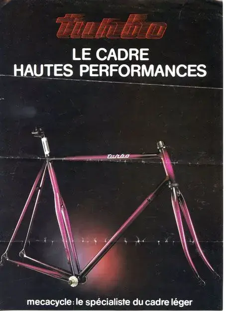

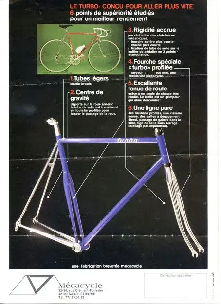

PostPosted: Sun Jun 06, 2010 11:30 am
rider | rBoTM Winner
Joined: Fri Jan 25, 2008 1:42 pm
Posts: 5277
Location: West Yorkshire
You've spurred me into action! Here are the copies of the brochure. Is yours like this?

PostPosted: Sun Jun 06, 2010 11:54 am
Old School Hero
Joined: Wed Jun 02, 2010 10:31 pm
Posts: 194
Location: Suffolk
That's my frame! The second photo is most like mine as it has chrome forks and rear triangle. The main difference is that on mine the whole of the rear triangle including the seat tube(s) and bottom bracket shell are chromed but someone has had it resprayed and they rubbed down the seat tube and bb shell so the chrome is damaged. I've stripped the frame ready to get it powder coated and I also have a set of original transfers coming to go on it.
