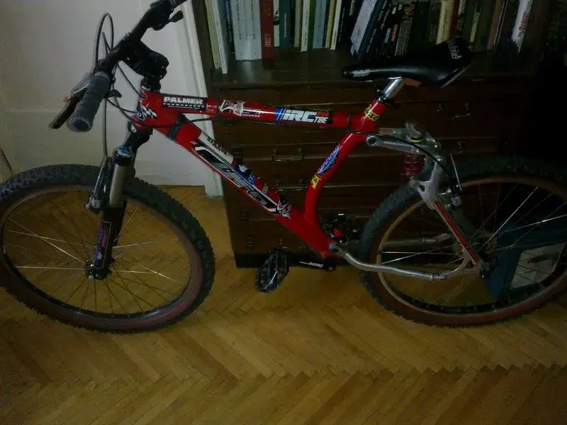

I got this frame long ago from my friend. I rebuilt a bike like 5 years ago with deore and XT but always wanted to have it restored/repainted/polished and with modern set of components.
Now I collected a full set of HONE group and a pair of Sun rims SOS rims and I'm ready to do an in depth overhaul of bike with rebuilding it's suspension. I'm geting my wheels built now, but I have lot's of problems/questions with rear suspension and rear disc brake mount.

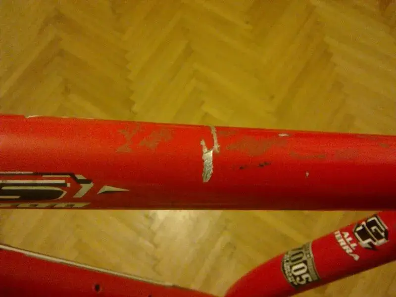

Paint:
I have some questions about paintjob on the frame. It has one big scratch over top tube and some minor scratches over all the frame.
If I'm going to powdercoat the frame - how can I prepare it with this big scratch? Which filler I can use which will not be destroyed during baking of powder paint? Or if I have a really big scratch it's easier to give it to car painters and make them repair the surface prime paint and cover it with laquer?

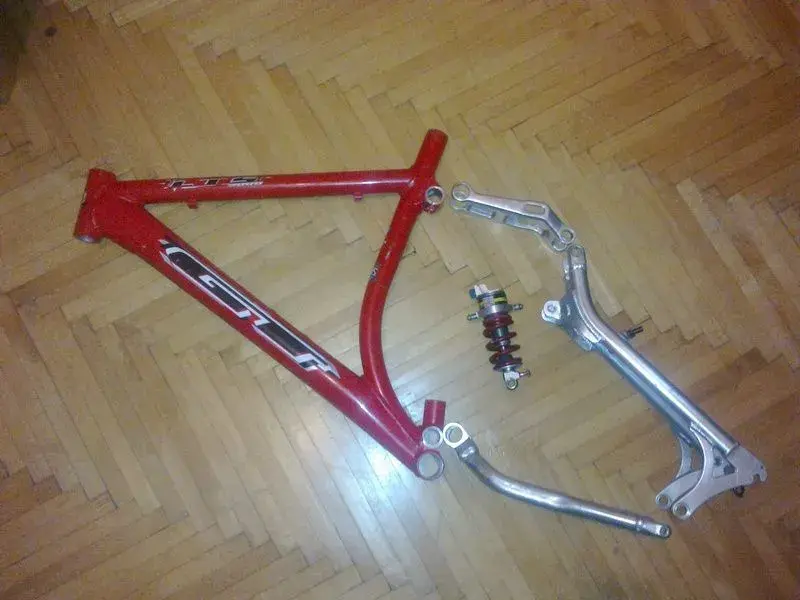

As I mentioned Frame is fully disassembled. I removed all the non-factory decals and cleaned and degreased the frame.
And here are bits and pieces.

And here comes an evil scratch...
