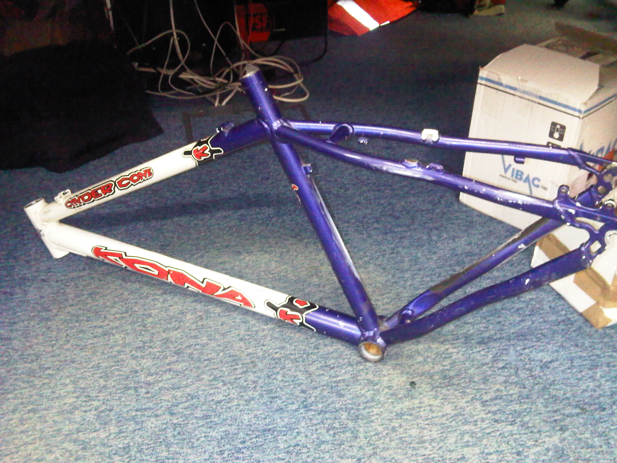

OK, received frame today in the post......

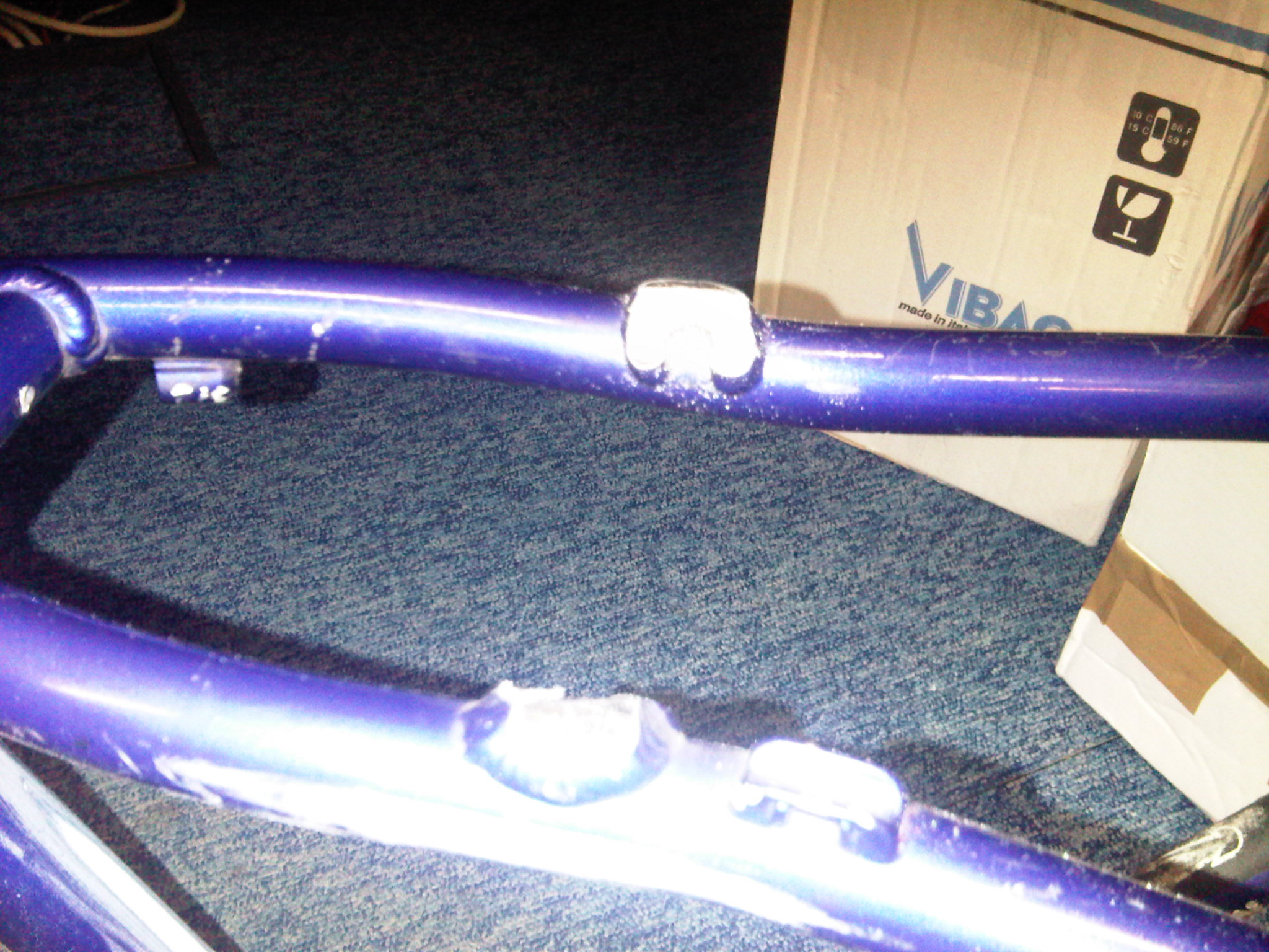

Time to hacksaw off the canti' bosses, these will (very carefully) be linished flush later and I'll fit some Crud Guard bosses to the downtube......
Then the frame will be dipped (to strip the paint) and powder coated gloss white, whith repro black Kona decals applied to the correct design.

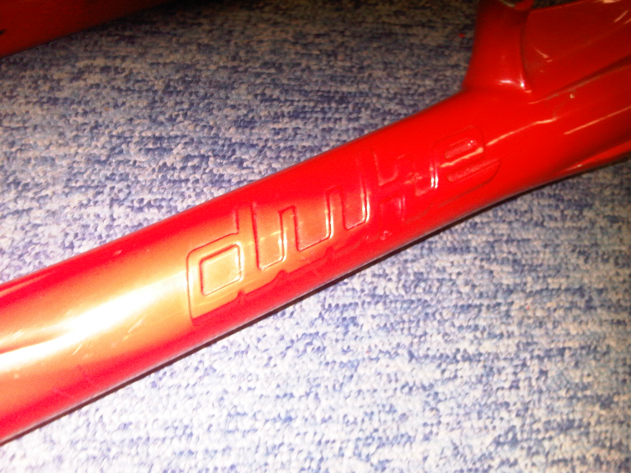

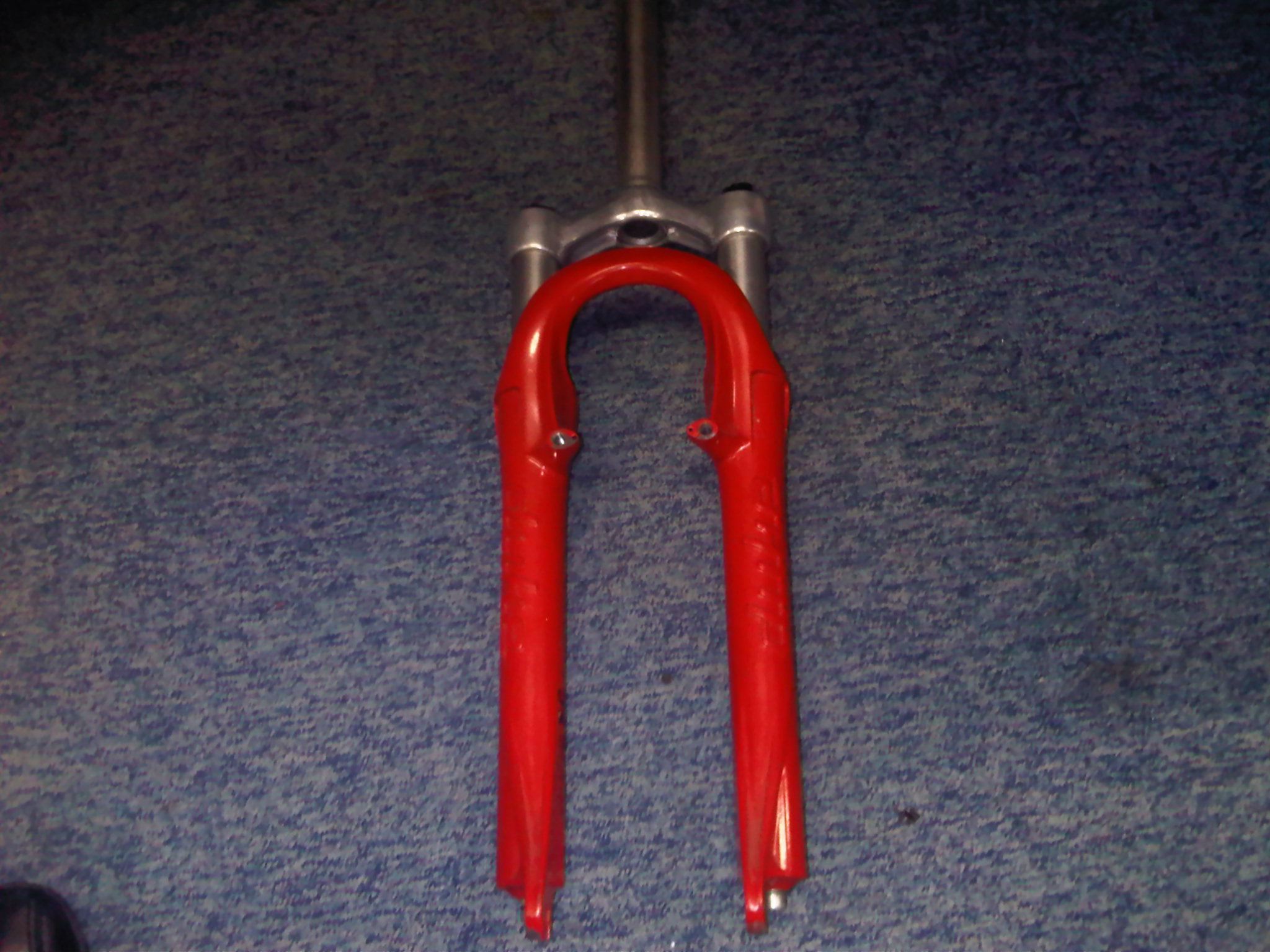

The forks also arrived, these will be off to the spray booth once I've hand stripped the paint to be painted gloss black.......
Gotta love the embosed lettering, pure class.

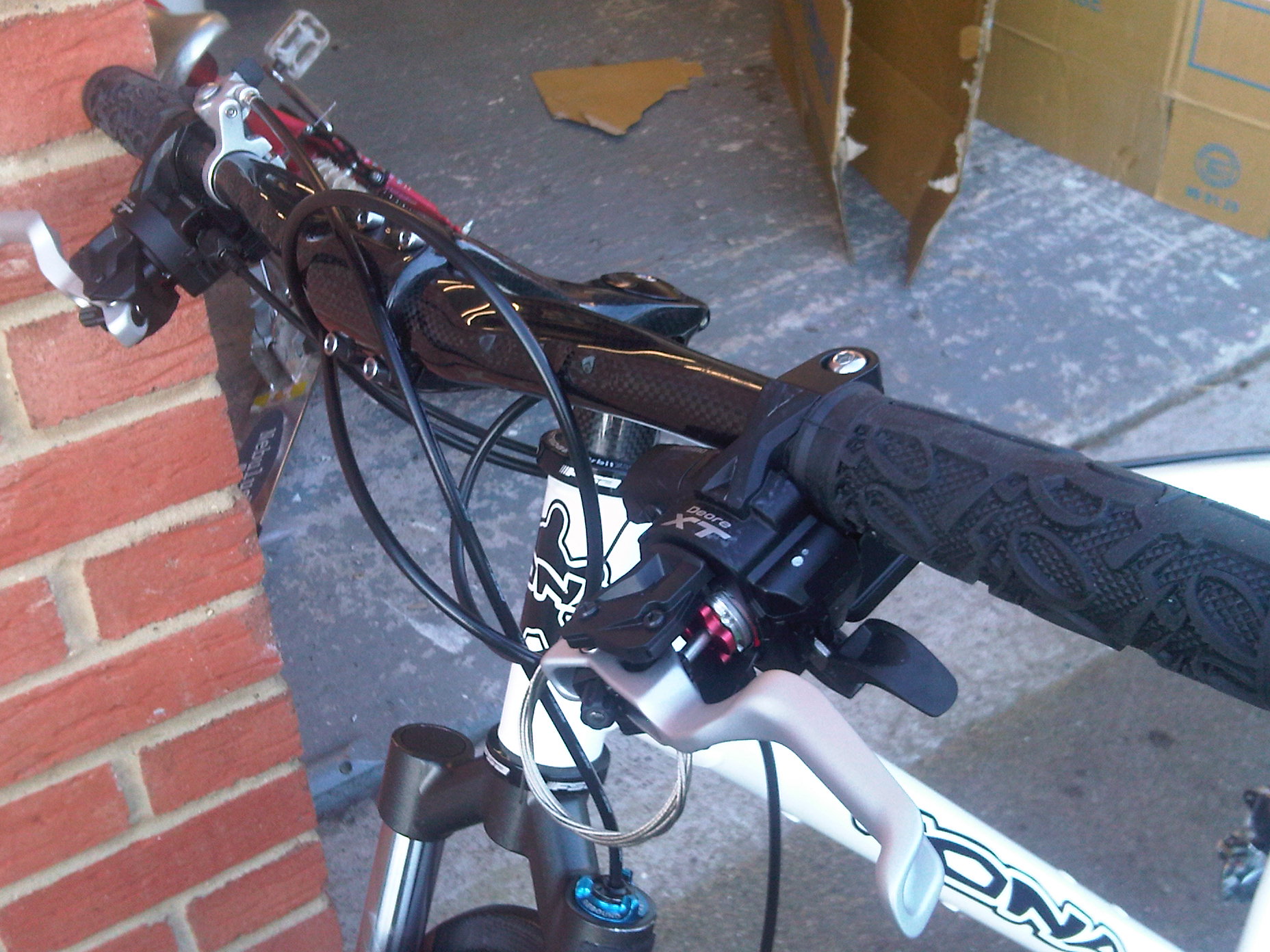

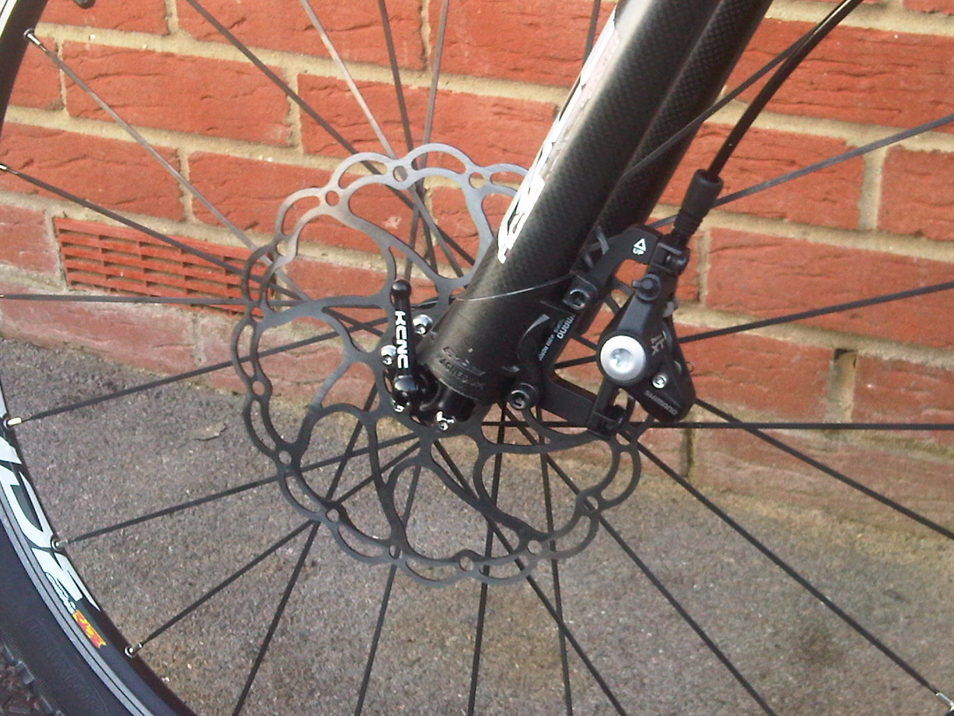

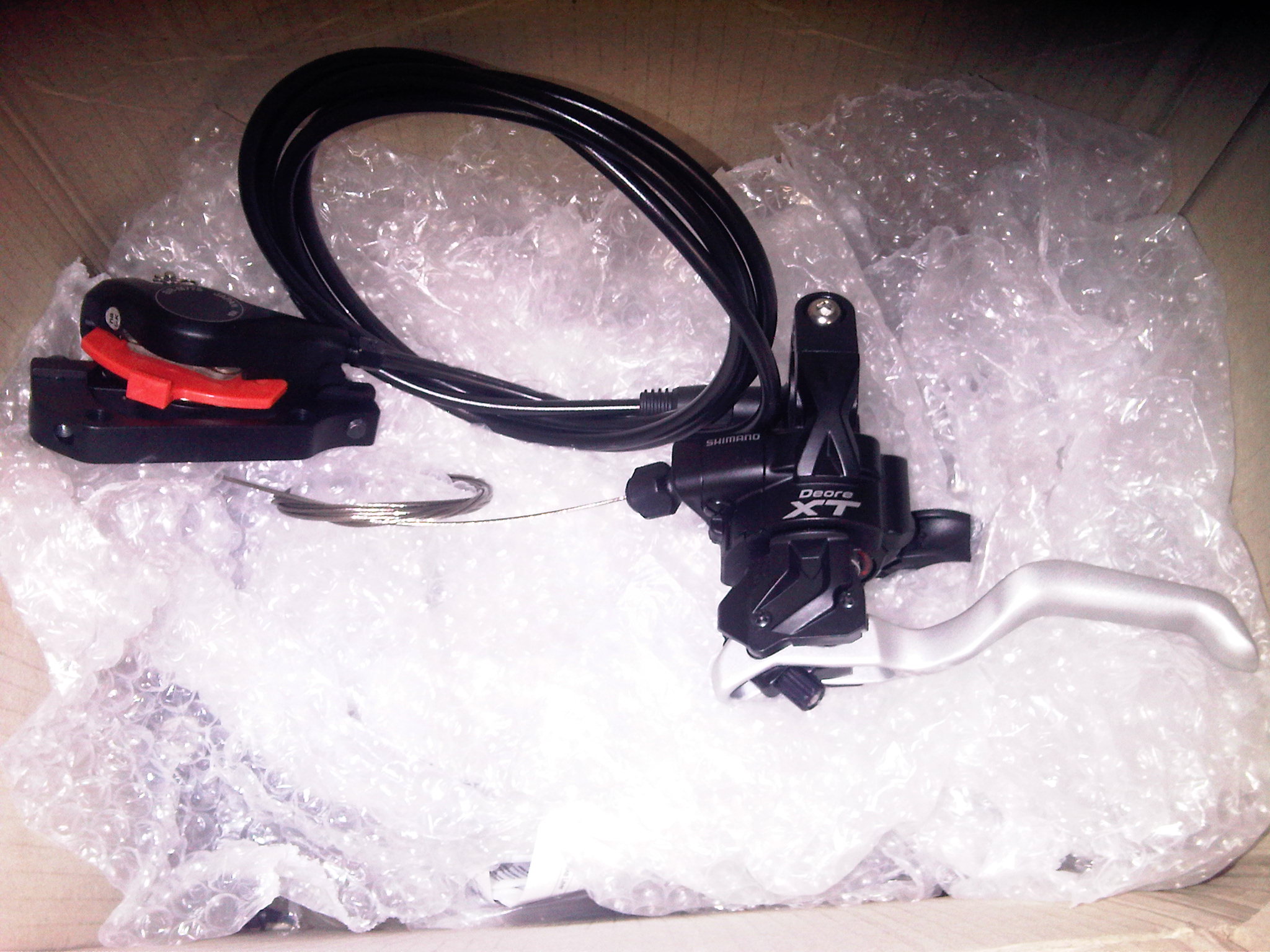

The brakes arrived today too, XT Dual Control F+R acting on 203mm & 180mm Aries discs.....

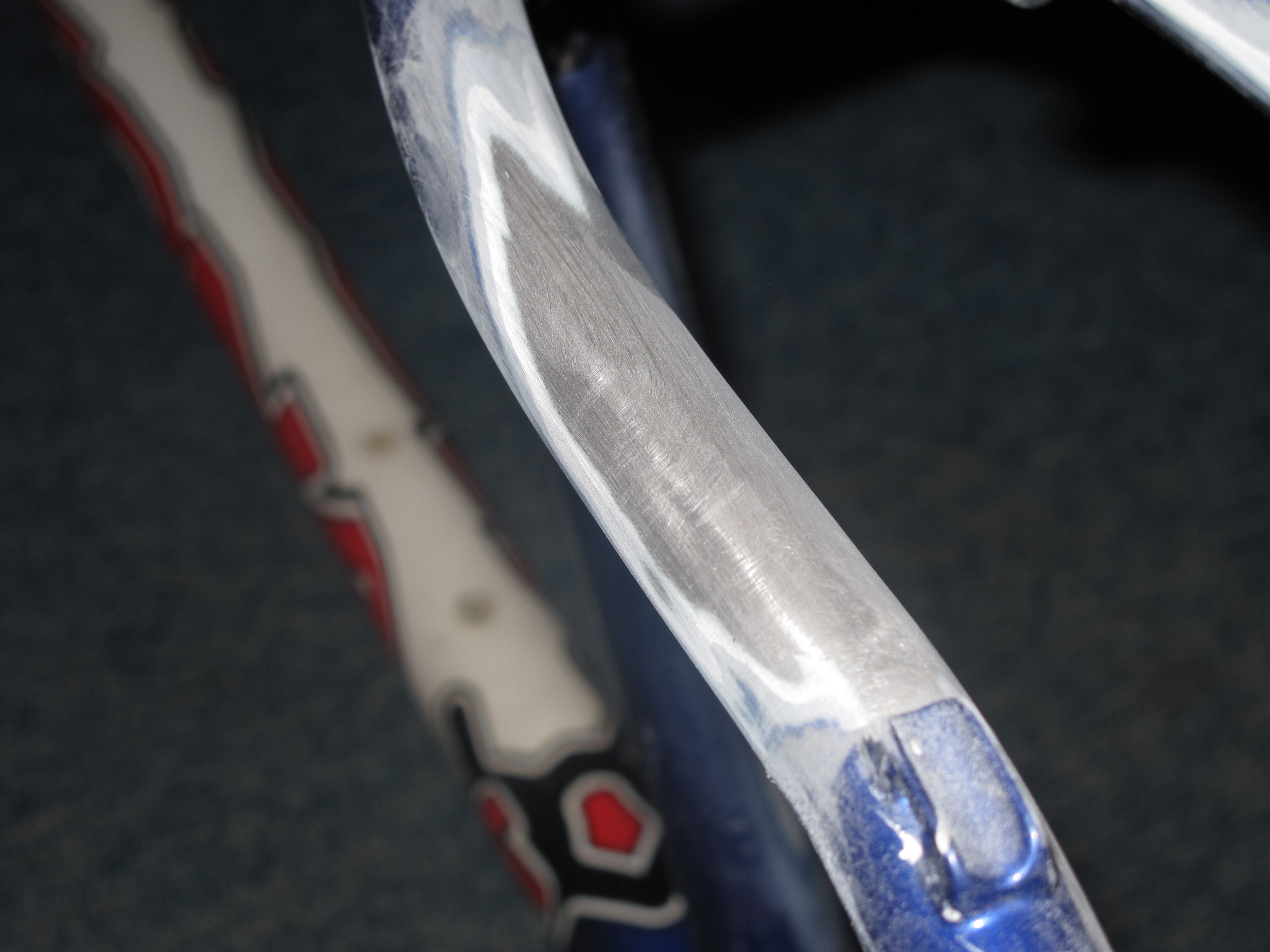

Last night I got busy with the angle grinder & a 3.5" flappy wheel. Then this lunchtime some fine emery cloth & ultra sonic measurements take to make sure the thickness is still OK..........

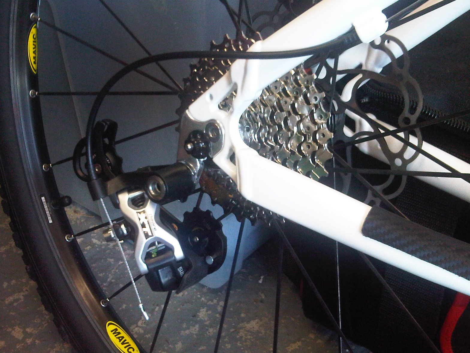

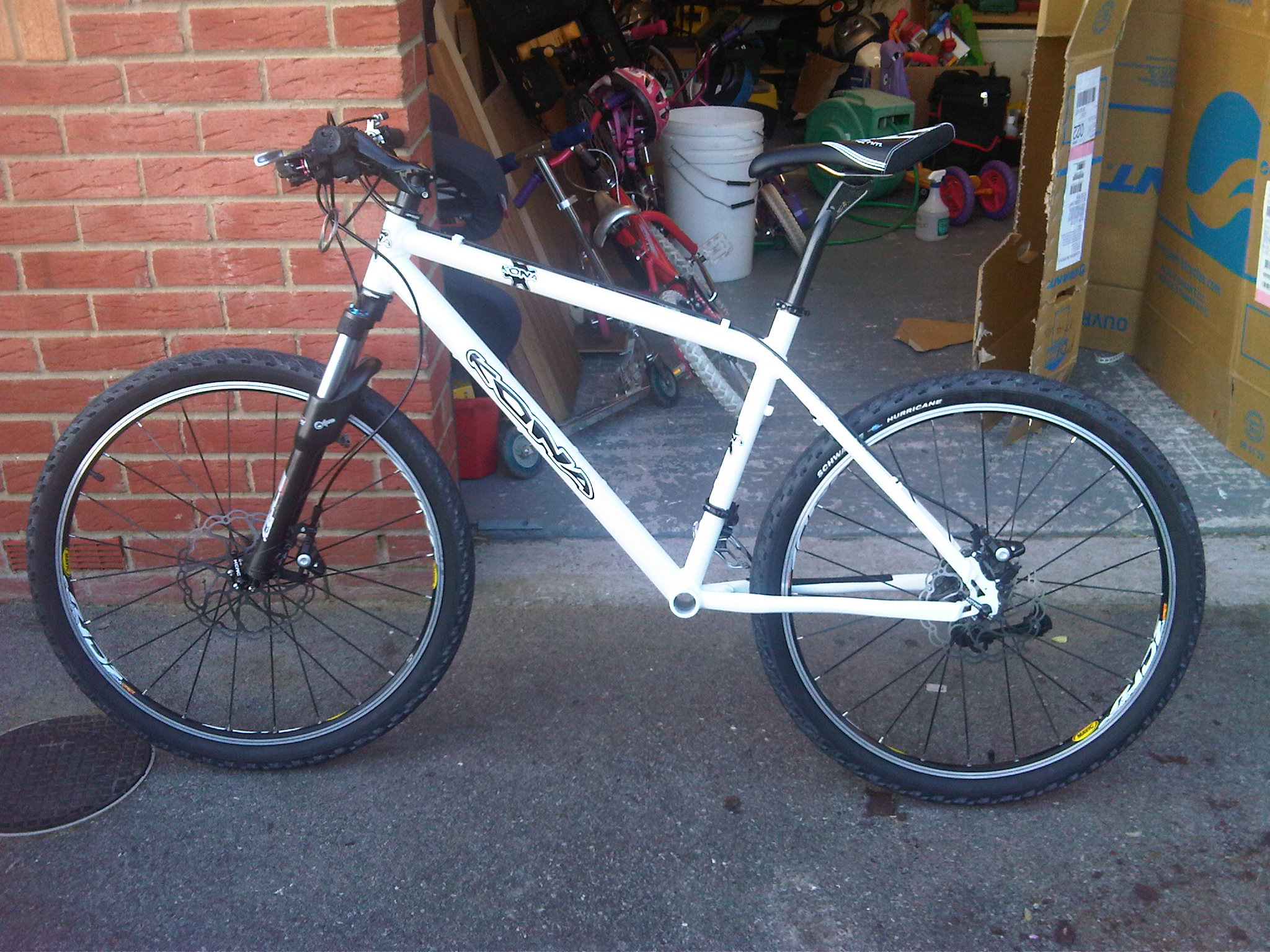

Well from the skanky, manky mess that the frame was, to this........ started the build last night having received the fram back from the powder coaters yesterday afternoon.
PostPosted: Tue Apr 27, 2010 8:16 am
Joined: Mon Jun 25, 2007 8:37 am
Posts: 3190
Location: Whiskey bent & hellbound!
That's looking good :D
