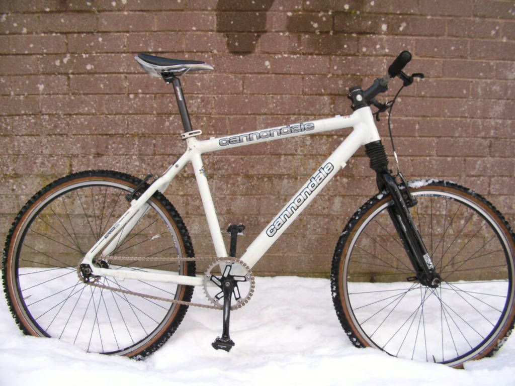

Hi guys,
Built this up as another 'something to do project' whilst off the bike,
I aiming currently aiming for 20-30 builds this year of various types, only some will stay, most will go :)
Since being ill I have really taken a shine to sourcing and building bikes , reminds me of days in the trade.. :)
What do ya think guys.. :)
Watch out for the next build coming soon :) :)

Looks nice.
What size chainring and cog are you using?
Looking to turn my old Fisher into a single speed and was wondering what ratios most people use - have built a SS roadie, but not a MTB.
PostPosted: Mon Jan 11, 2010 10:34 am
BANNED USER
BANNED USER
Joined: Tue Jan 09, 2007 8:41 pm
Posts: 10013

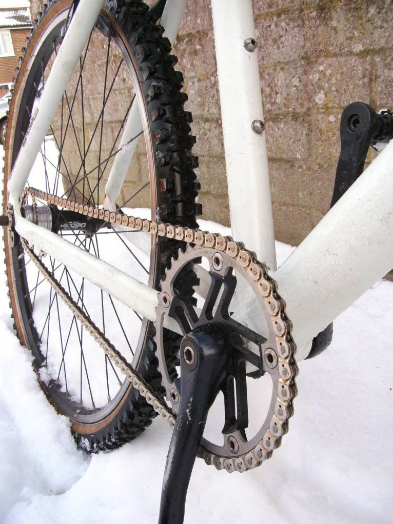

The ring sizes are 39 at the front and 21 at the rear :) , worked spot on this using a full half link chain, meaning I did not have to fit a unsightly tensioner, which is one thing that I hate on a singlespeed bike.. :)
Now sold and going to a better home, where it will be loved and cared for :)

Ho sithlord. Just about to purchase a caad2 frame for the very same purpose as this lovely build.
Could you detail the specifics of the SS parts so I can consider sourcing and replicating? What did this one ride like?
Never heard of a half link chain before - how does it fix chain tension? Does it require special cogs/teeth?
