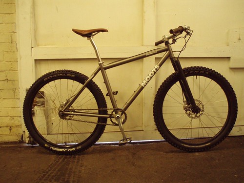

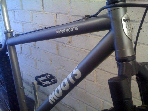

Almost ready to hit the trails. Just trying out different length stems from the spares box before taking the plunge and ordering a Moots stem.
Hope you like?
Frame: Moots Rigormootis 3/2.5 Titanium
Fork: Pace RC31 with ti steerer
Headset: Crank Brothers Cobalt C
Stem: From the junk pile
Handlebar:Jones H-Bar
Grips: Will be Brooks leather bar tape
Brakes: Hope tech2, 160 front, 140 rear
Brake Pads: Sintered Hope
Brake Levers: Hope
Cassette: Boone Ti 17t with VeloSolo spacers
Chain: KCNC BMX
Cranks: Middleburn RS7
Crank Bolts: Middleburn
Chainrings: Middleburn 34t
Chainring bolts: Middleburn
Bottom Bracket: KSA Titanium Pro ISIS
Pedals: NC-17 Magnesium
Hub Skewers: NC-17 Titanium
Rims: Sun Ringle
Hubs: Sun Ringle
Nipples: alloy
Spokes: Sapim
Tyres: Schwalbe Nobby Nic, Kenda Nevegal Tomac
Tubes: Stans Tubeless
Saddle: Charge Spoon (will be changed to Brooks Swallow Ti)
Seatpost: Thompson, custom brushed finish
Seatpost Binder: Moots
Weight: 18.2 lbs
Sorry about the poor pics- can't find a real camera :roll: It really deserves better pictures but will probably be filthy by the time I find it. But we like it like that don't we? :wink:

not too worried about mud clearance then...
The clay soil round here would have that clogged up quicker than a clogged up thing thats clogged...

Its sandy trails around here with big rocks and roots sticking out everywhere. I got tired (no pun intended) of ripping out sidewalls, dinging rims and getting pinch flats- even at light XC speeds that its DH tyres all round from now on. I have another set of 2.25 Nobby Nics to try out but the big 2.4 ones are OK.

I like that .
some real pedals are needed though .

I luuurve those pedals- they have had a year of hard use now and the bearings are still super smooth. They grip well, are low profile enough not to get knocked about too much and weigh just over 360 grams a pair. Highly recommended. I certainly wouldn't use spuds, hate them, I'm just too clumsy :oops:

Good to see your riding rigid 8)

Looking good ! How are you tensioning that chain though?

That's a fancy Dan build right there.
How do you find the niche bars?

I've only riden it to the pub and back. It was fine on the way out, but i found that they seriously lacked control on the way back. :lol: :lol:

Magic gear and a half link in the chain. I have a 16T Surly cog on there in that pic, but the Ti Boone is a 18T which I just take out the half link to run.
