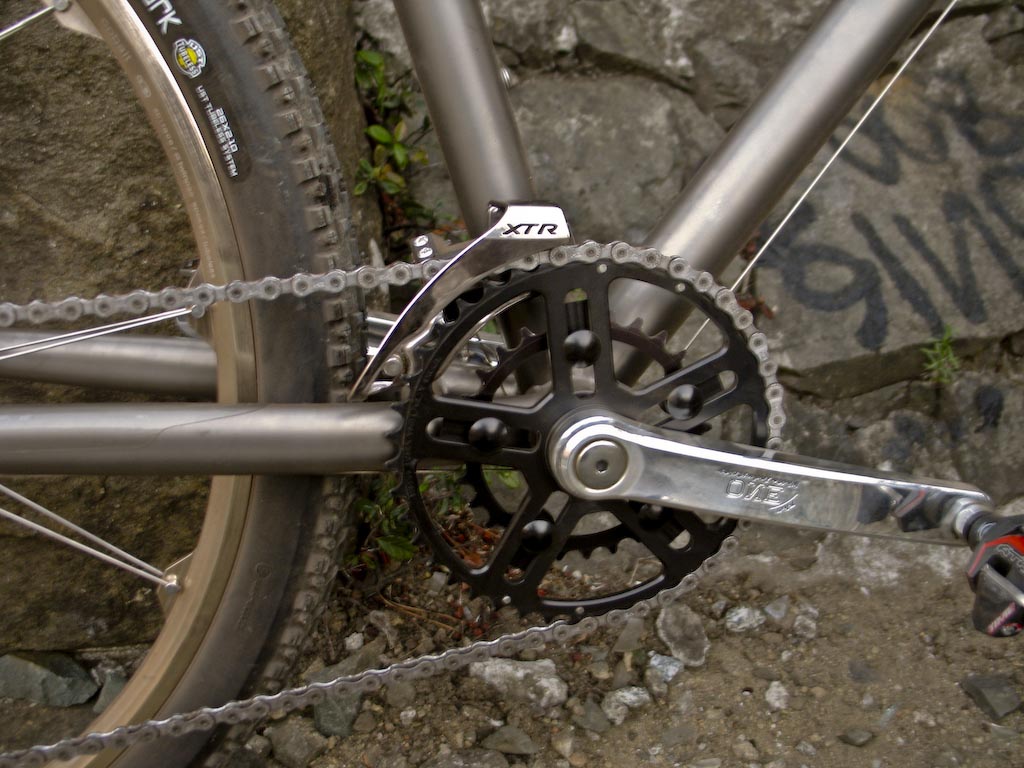

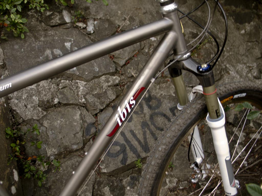

Hi. new member here, im a bike mechanic from san francisco. I recently finished assembling a new Ti Mojo from Ibis. In the build I tried to reflect my love of a more classic aesthetic on bikes while still utilizing high end modern equipment. I wanted to build something that would hold up to the test of time but visually and from a performance aspect. I'm very happy how how it came out, it is a joy to ride.
Thanks to the galleries on here, they were a source of inspiration while assembling the bike.
frame: ibis ti mojo ltd
fork: rockshox world cup sid
wheels: crank bros cobalt
crankset/bb: white industries vbc 42-28
headset: chris king
stem: thomson x4
post: thomson masterpiece
saddle: selle san marco rolls ti
bars: syntace vector 12 degree
shifters: xtr
brakes: formula oro bianco
derailleurs: xtr
cassette: xt 11-32
pedals: time atac carbon
23lbs w/ pedals
Thanks for looking

Very nice looking bike you have there. How smoothly does the front mech make the transition from 28 to 42 and back?

thanks! The front shifting seems to be working pretty well. I just dialed the outer limit all the way in just to prevent myself from forgetting and over shifting. I may replace the outer limit screw with a longer one to be a little more precise but so far I haven't had any issues. its a hair rougher than XTR or a standard set up, but I'm not too concerned as front shifting isnt something I find myself doing as much as I would with a triple and the rapid fire of the XTR shifters makes shifting front rings and dropping down in the cassette simultaneously very nice. im just happy to have cranks with a narrower q factor.
