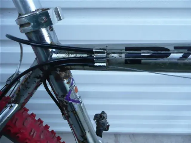

Hi,
Could some one help me out and let me know what the sizes are for the seatpost and headtube for an Orange P7.
Could, maybe, someone give an idea about the frame age. I'm considering a retro build.
Thanks for your time.

That will probably have a 1" heattube/headset
seatpost - they were 29.6 shimmed to 26.4 for some of the nickel frames, pull the seatpost out and it will say on it.
My 3 P7s are all 29.6 seattubes, I use use thermoplastic shims to take them to 27.2
PostPosted: Mon Jun 22, 2009 10:16 pm
Joined: Sat Mar 28, 2009 6:10 pm
Posts: 921
Location: Hampshire
Post 98 they are definitely 29.6 shimmed to 27.2.
Before '98 seems unknown on the orange website:
http://www.orangebikes.co.uk/main/techfaqs.php#table
My 95/96 model seems to take a 27.0. I did try 27.2 which is more normal and it was not happening.
