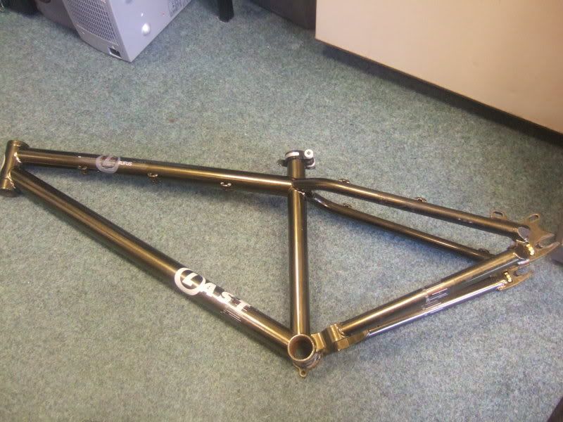

I spotted summat else... Its heavier (than the Identiti 5.8lbs :? ) at 6.5lbs , its got good geometry like the 4.2lbs Commencal, its Cromo, its got a lower BB at 13", and its only a 13" frame! :lol: But worth a shot.
There was an incident with Paypal and co but after a month waiting I'm ready to start the build

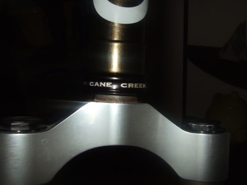

With the Cane Creek S8 in the frame I can try the forks for size...
Looking good!
still need to seat the fork race rest on the fork somehow and cut down the steerer finally, one for that garage this weekend...
made a mess getting the old one off. :(

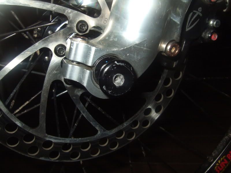

And getting an engineering mate to find me summat to replace this from the forks
a combo of supersoft alloy and possible bad tools on occasion. :?

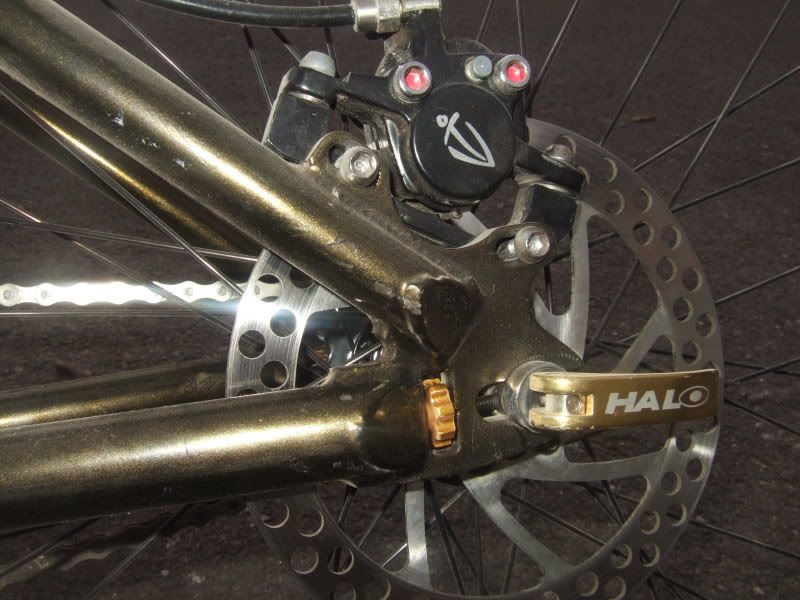

thats a reet tight rear end . thatl launch from the line nice and quick
neat chain tensioners too
a primo crank bolt or a bmx top cap might work in the axle
ill give ya £20 for the gussets :lol:

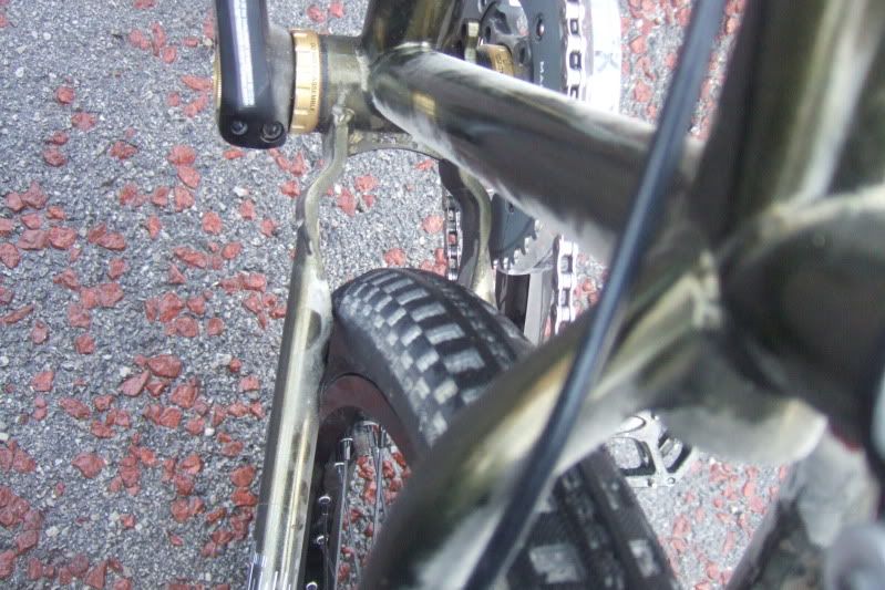

Yeah its super short, looking forward to grasping manuals on it and stuff the ID was really long by the time I'd added chain slack so losing about 30mm off the chain stays, and 18mm off the top tube. And of course a bit lower to the ground. should be sweet for mixing up local available terrain. Exciting. :D

That bolt in the forks is 10mm IIRC, thanks for the tip.

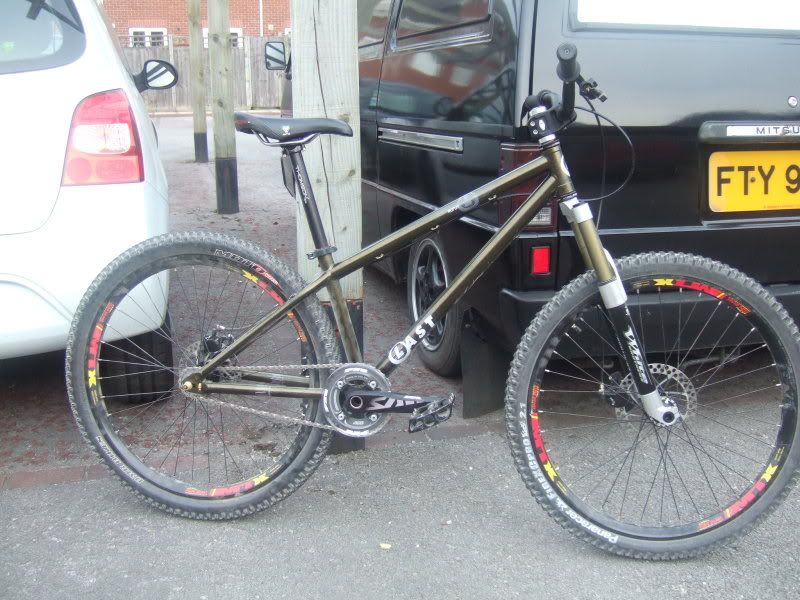

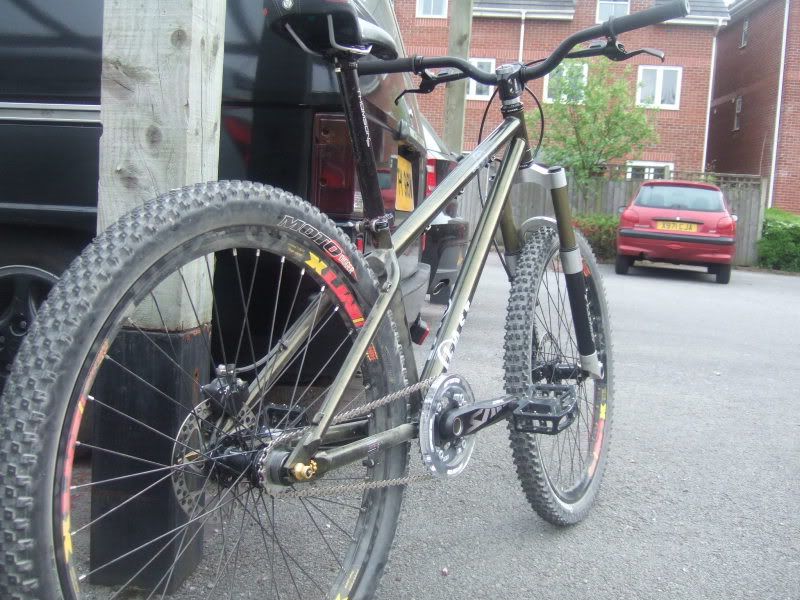

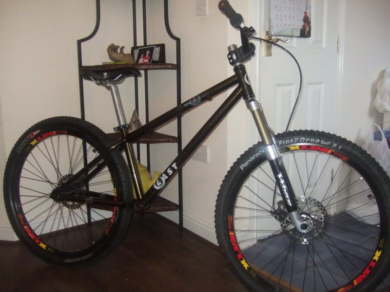

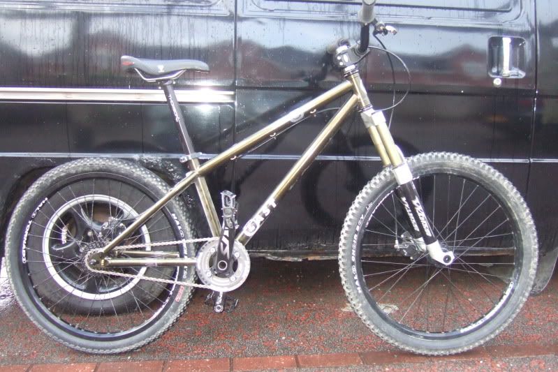

Well like busses, these completions come at once, or might be just the way I work paralell across too many projects! 8)
A seed was planted for a new bike last year and the new beastie is done.
A couple of minor niggles getting it built up, most ironed out now I think.
Not sure about German (Jap) precision engineering, the Thomson post didn't go in so easily despite being the correct size. I filed any obscurities in the seat tube, but in the end the bottom of the post copped it too. Dare not push it much lower, tis the ideal versatile height anyway at mo, since I'm 6ft 2!

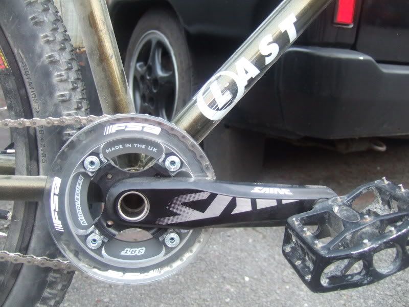

Custom and all new crank/ring/BB set up, its real smooth and less than a 1000g looks nice too. pricey combo but worth it. :)
Moved accross wheels and brakes and borrowed a gold skewer off the Muddy Fox build!
Best test it on terrain rather than round the block, its clearly built as an all rounder, so got down to the local BMX track last night on me bill, youth club were training but the nice chap let me on the section they were not using. I must say first impressions are woah! getting used to the short rear end is weird, I had to remember to keep some weight over the front. After a hour I was getting more confident on the lumps and bumps and happy chucking the bike about. It feels really nice, much prefer it to the Identiti. its chunky and sturdy but the CroMo is really soft and forgiving compared, the BB height is down to 12.5 inch which is nice, all in all very nice, best of a grown up BMX/kids MTB I like. I droppeed two teeth on the new gearing (38-16) and its a nice gear in a comfortable postion on the bike.
The BMX club turned up, and I decided to not join the club with minimal pads on and no lite alloy race BMX and a bit tired/thirsty. The offer was nice. Knees and muscles a little stiff today! :D
So there ya go, awesome its complete and was worth the effort, the only major thing I might do is lower the forks some, they work, but with that short end it might work better. Still undecided on tyres at mo, somthing light less than 2.2 and not over knobbly.

you might like the kenda small block 8
how is the dmr moto ? been thinking of trying one of those
might be worth seeing if a shop near you will hone the seattube

Good recommendation, seen a few tyres dotted around, MBUK, and forums/sites. I have the old Moto Its quite an old tired one and still a tad weighty for what it is but been a good tyre for mucking about and commuting. This knobbly one has been general rear tyre since I bough those wheels seems alright actually only let me down in silly wet mud which was more comical than painful! :lol: So yeah its good, big n squishy and rolls nice on all surfaces. The front I bought for retro XC bike, replaced the Minon DH I had on in a temporary bid to save weight, both great knobblies.
Maybe i should ask around the shops about the tube, didn't think of that. Doh!
The Thommy is super long at 410mm but not cutting it yet, it gained a scratch at the bottom, so some light filing under the Minimum insert line helped. will have to take it out and see what its like.

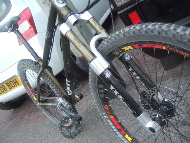

Well Here I am on from the day at Dalby looking like a Timmy!
Cheers P20 for the pic. http://www.flickr.com/photos/66452821@N ... 704904877/
I rocked it with a 38 - 16 gearing! Which I figured would be good for the BMX track near home and the flat roads. At the trail centre though some torque munching up hills to actually get up, and a confortable gear getting back down and across. Obviously sitting down wasn't that easy and the stiff frame transmitted some vibes! TBH doing 20 miles on this (100 miles from home) and with 5hrs sleep seriously knackerd me out, but its a great ride, on the short side but lovely manualing off and over stuff, I really like it, got to know it well on this trip which is why I took it. A 5 mile blast yes i'd take it again. 20 mile? only for another daft challenge or if I had nowt else to take. :D
P20 noticed the forks were not giving on the trail, so did my arms, it was like riding a retro apart from the stance. I'm not sure If I have cocked up these forks in teh past. I need to either find someone cheap and cheerful to lower them a tad and service them for me, or attempt it myself somewhere clean. Or of course, buy some pimp rigids (not cheap with 20mm) or other sus forks.
