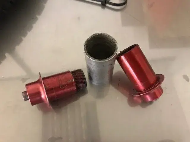

In that case, how do I get the bearings out? I’ve not looked closely at it yet.
PostPosted: Mon Apr 08, 2019 1:43 pm
Joined: Mon Apr 16, 2007 12:37 pm
Posts: 1005
Location: Kenilworth
The end caps aren't so much caps, they screw into each other.
The bearings will normally either stay in the hub and can be knocked out, or will stay on the end caps.
Just took a pic of one of mine.
For ref. the 20mm adapters just push in.
PostPosted: Mon Apr 08, 2019 7:24 pm
Joined: Sun Dec 12, 2010 10:50 pm
Posts: 761
Ah thanks, so just a soft grip needed to undo them.
