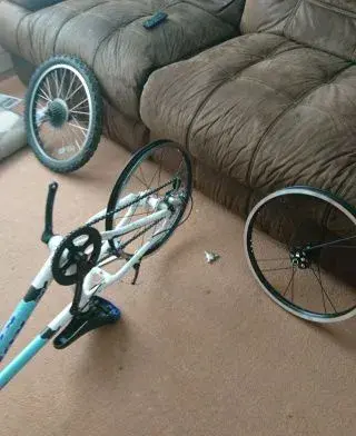

So having got a bit carried away with the bike for my daughter for when she gets to about 7 (she’s currently 3) I thought it time to take a step or two back. She’s just about starting on a 16” wheel Islabike which is fine straight out of the box. I bought it used and in good condition and I am at peace with that.
But AFTER that, when she’s grown out of the Islabike (age somewhere about 4-6 I guess) the next in line is the 20” wheel Kona Makena that was lightly tweaked (mech and shifter) for the boy a few years ago but is now in danger of letting the side down. I could splash on another Islabike, they are £150-200 used, more like £400 new. But where’s the fun in that? We already have the Kona and a bulging parts bin.
So, modding the Makena.
Using some of the learnings from my Caygill project, I’ll be looking at lightening the load, on a budget of course, but assuming that taking out the heavy steel parts and replacing with lighter is the order of the day. I’ll be getting a lighter crankset and BB to replace the (presumably heavy) steel units, only needs single ring so that should be easy. Wheels, I have spare hubs a-plenty, 20” rims are not expensive. It has suspension forks that could be improved and replacing the (presumably heavy) steel stem, headset, bars, seatpost etc which should be simple enough.
Plan is to reduce the weight where possible, give reliable drive and brake systems, and keep it looking smart.
I already have some ideas in mind and have gathered a few parts in anticipation, but plan is to get this one completed by the end of this year (don’t laugh, its going to be tough).

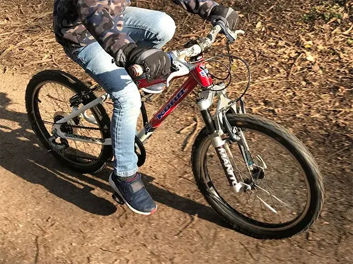

This will be a great little project.
I bought one for my lad and they are pretty heavy in stock form.
I've done the following, pretty much all from old spares lying around so on a very tight budget:
lighter BB (kept the stock cranks)
pedal upgrade
lighter seatpost and seat (started off with a super short BMX race post and seat but have a longer alu on in now)
Replaced front hub internals with a lighter more useable QR setup
Repaced rear hub with a nos LX one, relaced on the standard spokes/rim
Has an M739 rear mech with sti shifter
50mm alu stem
Cut down alu riser bars
Chris King headset
Better Vbrakes and levers
Forks were the biggest weight saving though, he's got some mini manitou threes on there now. Although if I'd have been rebuilding the front wheel (or had a bigger budget) I'd have shortened some rigid carbon forks and run a disk; couldn't find any decent 20" rigid forks when I built it though.
Loves the bike, but it's nearly time to size up so I'm collecting parts for a tiny 26" wheel bike at the moment!

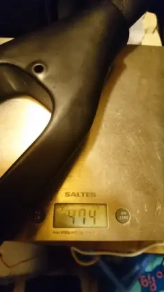

Carbon forks should save about a kilo against the existing steel suspension jobbies

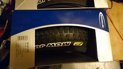

Splashed out on some tyres too, good balance of lightweight and chunky.

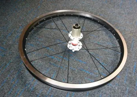

Lightweight novatec hubs pilfered from the Caygil parts box, some cheapy 20" single wall alloy rims, and one lunchtime alone in the office, and we start to make progress.
Spokes are short and I'm building with 16 spokes in 32H hubs and rims, so it's going to be 1 cross pattern. I tried to interlace but there's just not enough give in the system. I'll see how it sits when everything is tensioned up.
Only finger tight for now (no tools) but happy enough to test the concept in my head.

Got some peace over the weekend to finish off those wheels. Not perfect but they'll do for now, within a mm I'd say of true and round. Happily my spoke length calculations (guesses) were not far off although there is a bit of thread showing on some.

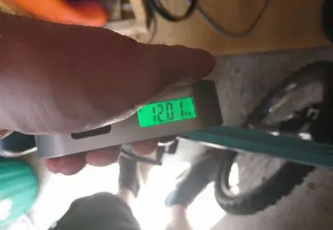

Also while I had it out of the shed, for reference as the starting point the bike as-is comes in at 12 kg.It feels heavier than I remembered.
