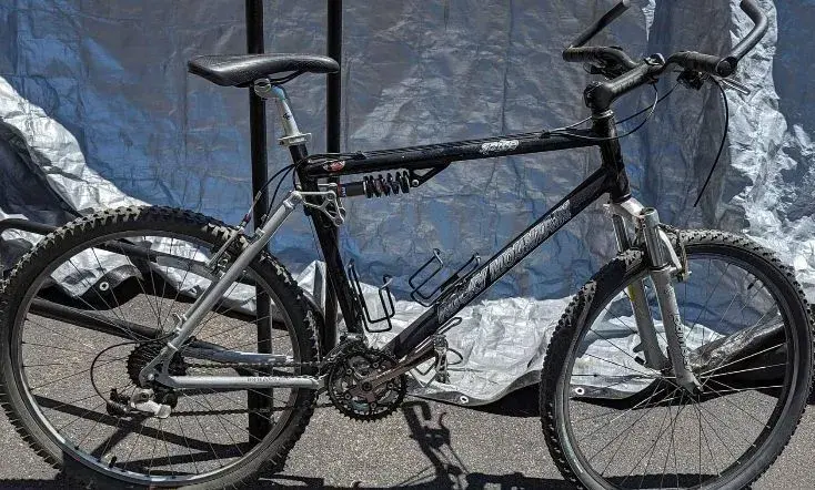

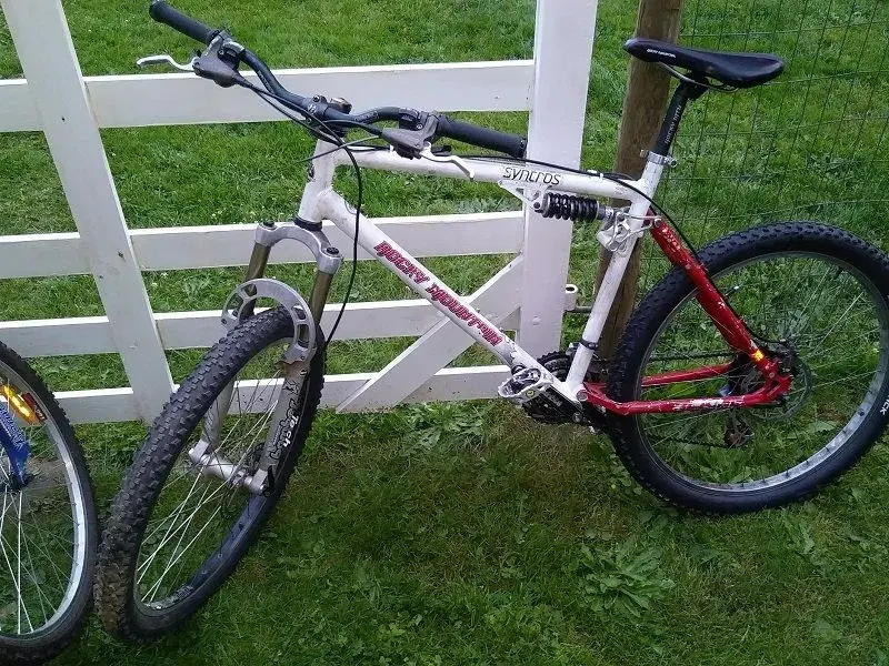

Well, after having to miss the show at Toxik due to a last minute request for help unloading my project car and getting it safely stowed for another summer of late nights, I decided I should post my Spice restomod. It's partially correct, partially period correct, with a few modern twists and one distinct retro feature.
I originally picked up this frame last spring to replace my AMS Boss Rock II as a trainer to help me lose some weight, and didn't get too far. I sourced a 2000 Marzocchi Z1 QR20 front end with an eNVy arch, a Deore LX M570/571 derailleur combo and ran into a 6 month block of overtime, car problems, and other fun stuff. Now it's in the home stretch, waiting on a few small pieces before a full summer of fitness.
Here's the quick and dirty spec sheet. Blanks haven't been purchased yet or I'm not sure what they are.
Frame: 2001 Rocky Mountain Spice 20.5
Fork:  2000 Marzocchi Z1 QR20 with eNVy fork brace and aluminum stem
Headset:  Raceface sealed threadless headset
Stem: Bontrager Stem
Handlebar: Race Face Air Alloy Riser
Grips:
Barends:
Brakes: Hayes Mag G1 front with Hayes adpater/Magura HS22 Raceline rear with what appears to be a homemade brake booster
Brake Pads:  Brake Authority front/Magura trials rear
Brake Cables: Hayes/ Magura
Cantilever cable hangers:
Brake Levers: Hayes G1 flip flop/ Magura HS22 Raceline HD
Shifters: Shimano Deore LX trigger shifters (M570/M570)
Front Derailleur: Shimano Deore LX FD-M571
Rear Derailleur: Shimano Deore LX FD-M570
Derailleur Cables:Shimano
Cassette: Shimano 11-32 cassette
Chain: Shimano
Cranks:  Race Face Turbine
Crank Bolts:  Rock Bros titanium
Chainrings: Race Face 44/32/22
Chainring bolts:  Race Face
Bottom Bracket: Shimano UN55 73x113
Pedals:  Shimano M545
Hub Skewers: Cheapo ebay front with custom QR20 ends/ Shimano Deore XT rear
Rims: Pro Wheel/Sun Rim Rhyno Lite XL
Hubs:  King Kong KD-H2 QR20/ Shimano Deore XT
Nipples:
Spokes:
Tyres:
Tubes:
Saddle:
Seatpost:  RMB 26.8
Seatpost Binder: Stock RMB
Weight:
32169742_10156101294150211_9182009723677835264_n.jpg [ 395.55 KiB | Viewed 1268 times ]

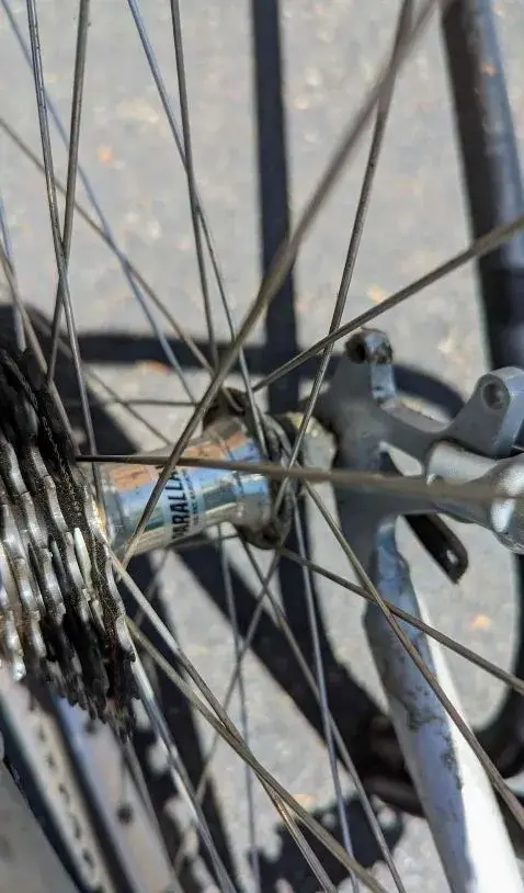

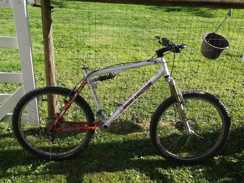

Well I did some more work, undid some and made a couple changes.

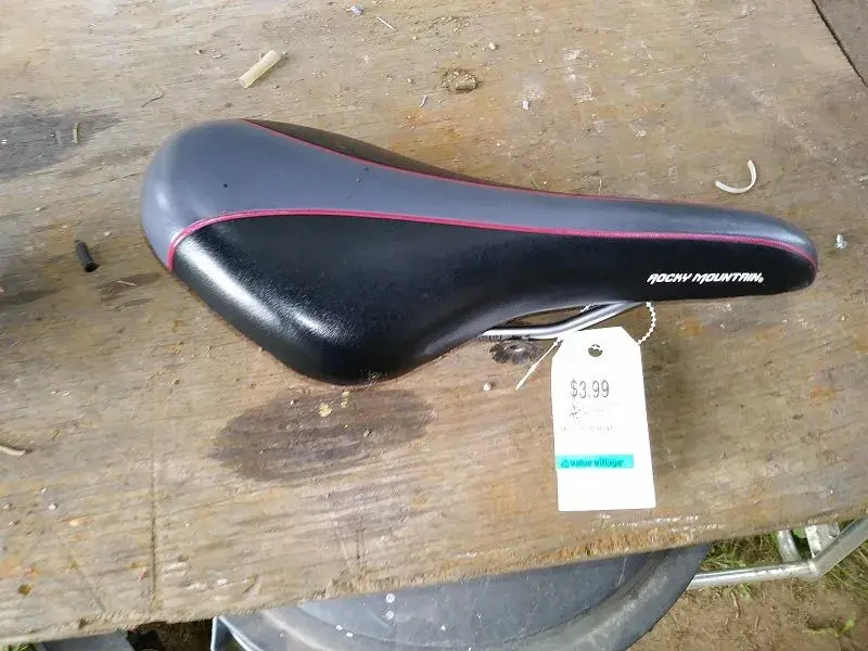

I found another Hayes G1, so swapped out my Magura rears for a disc, using a Magura Storm SL rotor, matched my seat post to a Value Village find RMB seat ($4!) and installed my crankset using the titanium crank bolts. Other small changes are Race Face Love Handle lock on grips, a change from a heavily worn 9 speed cassette to a lower model 8 speed and the tires being swapped out for Schwable Black Jacks.

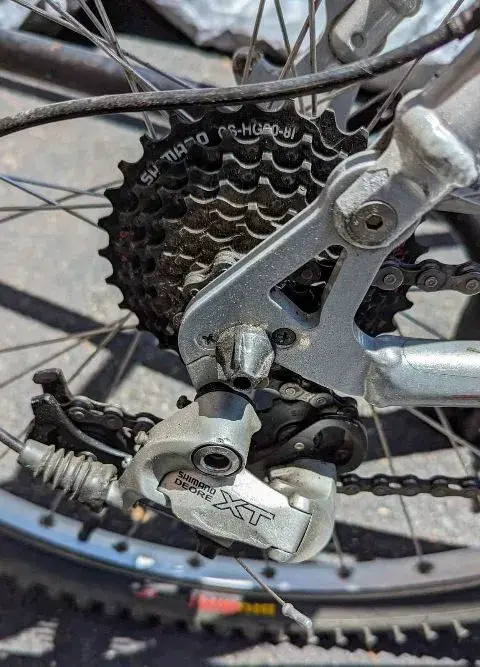

I started the tuning process and discovered a bent rear derailleur hanger (Which RM still sells!), so further tuning is delayed until it comes in. I also discovered that I had acquired a proper Rocky Mountain QR20 front hub laced by Wheel Tech with a recent Kona parts bike purchase, so score! Mean time, some work is being done to both Konas and a proper rebleeding of the wife's Magura HS22s.
