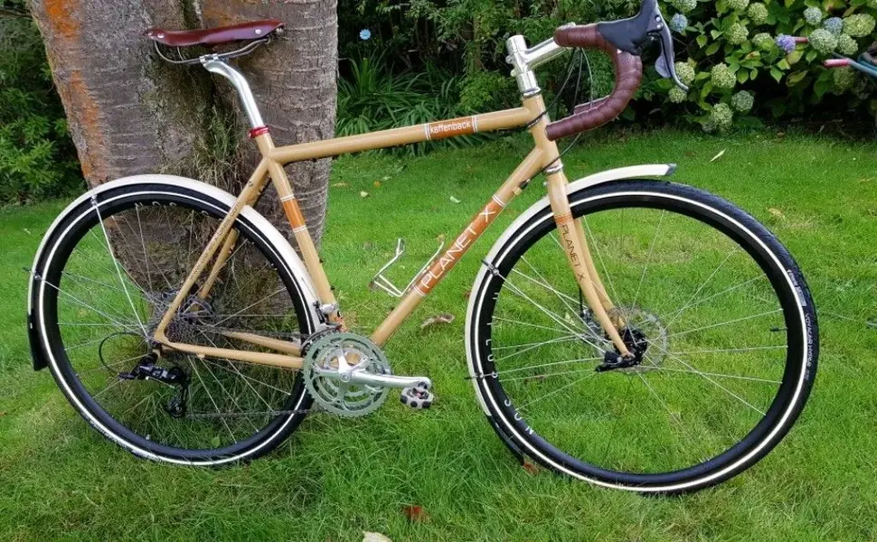

A few weeks ago I did a three day trip on a 1980s pro race frame with a 10 speed triple setup. Whilst it was perfectly comfortable it did make me realise that I don't have anything in the fleet that could realistically do a lengthy tour.
I'd put a PX Kaffenback together last year as a hybrid for getting to work on icy days, but it sat in readiness shod with it's marathon winters all the way through the cold weather without leaving the shed.
Nowt wrong with a Kaffenback for touring, so off came the flat bar/full hydraulic/SRAM Apex... And of course the tungsten-carbide spiked tyres.
Now, all my fun bikes are Campag equipped and I wanted something with a low gearing for touring... preferably a triple... and didnt want to buy any new drivetrain and so the story begins...
The challenge was to get Campag on to disc brake hubs... easy... buy a Shimano splined cassette with Campag spacing. Ambrosio have made them for years I said to myself...Unfortunately, nobody seems to be making these any more.
Next option, buy a new, Campag-friendly hub and rebuild the rear wheel. Costed up, that was going to be nearly £200, so that fell by the wayside too.
And then came the breakthrough. Mr Zinn, who reckoned that Campag 10 speed ergos will interface with a SRAM 10 speed rear mech and Shimano cassette... so it got quickly set up to test... and it does work. Perfectly!

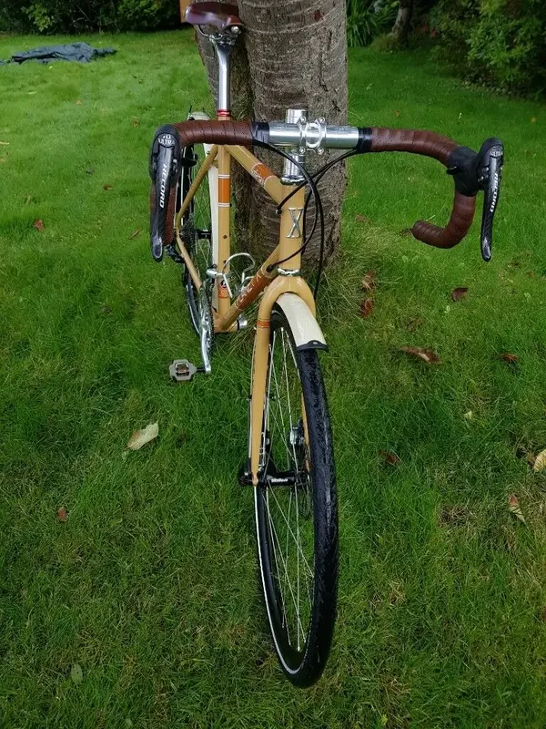

Went for a 40 mile spin over some lumps and loved it. It's got a completely different feel with drop bars. Really responsive, great road feel and it holds very well at speed.

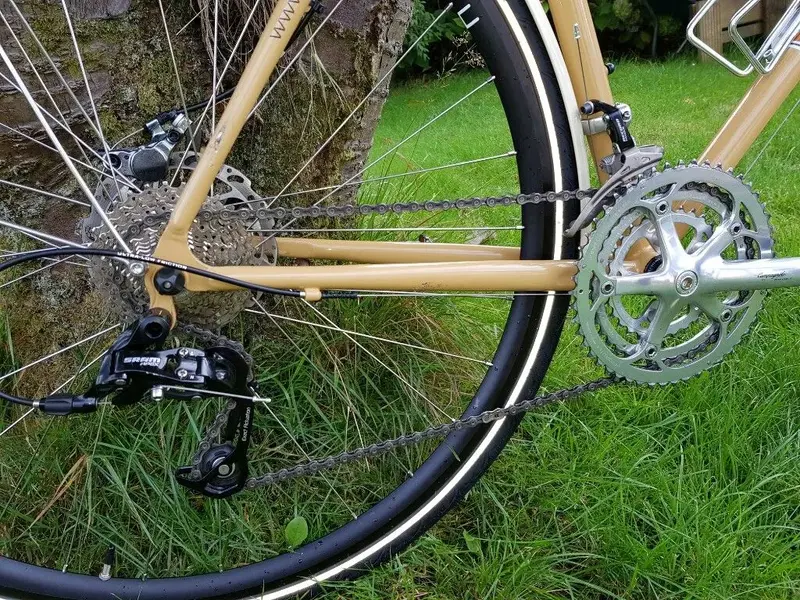

The SRAMpagnolo drivetrain works almost as well as good old 10 speed Record in its pure form. There's the occasional under or over shift needing a trim and try again but I'd say over 98% of rear shifts were flawless.
With the best will in the world this is a heavy bike at 11.5kg, but as it's been built primarily as a tourer weight is immaterial.
So... The build:
Frame: Planet X Kaffenback 2 Disc frame and fork - Maxwall double butted Cromoly gaspipe.
Headset: PX/Holdsworth Gran Sport Threadless
Stem: PX/Holdsworth Gran Sport
Handlebar: PX/Holdsworth Gran Sport
Bar Tape: Ritchey fake leather
Brake Levers/Brifters: Campagnolo Record 10 speed
Brake Calipers: Acor/Juin Tech R1 disc
Brake Pads: Acor
Brake Cables: Lifeline Performance
Front Derailleur: Campagnolo Record Triple
Rear Derailleur: SRAM Apex 10 Speed
Derailleur Cables: Campagnolo ultra shift
Cassette: Shimano Tiagra 12-32
Chain: Shimano Ultegra 6701
Cranks: Campagnolo Racing T
Chainrings: TA Vento 50/40/30
Bottom Bracket: Campagnolo Centaur 111mm
Pedals: 1st Generation Crank Bros. Candy
Rims: H Plus Son Archetype 24F/28R
Hubs: Vision Metron 40 Disc (undoubtedly Novatec)
These are only on for zipping around. I have some Pacenti SL25's to build onto 32h Hope hubs for actual load carrying duty.
Tyres: Vittoria Voyager hyper
Saddle: SPA Cycles Aire Ti
Seatpost: PX/Holdsworth Gran Sport
Mudguards: SKS Longboard Latte Macchiato
Weight: 11.5kg
