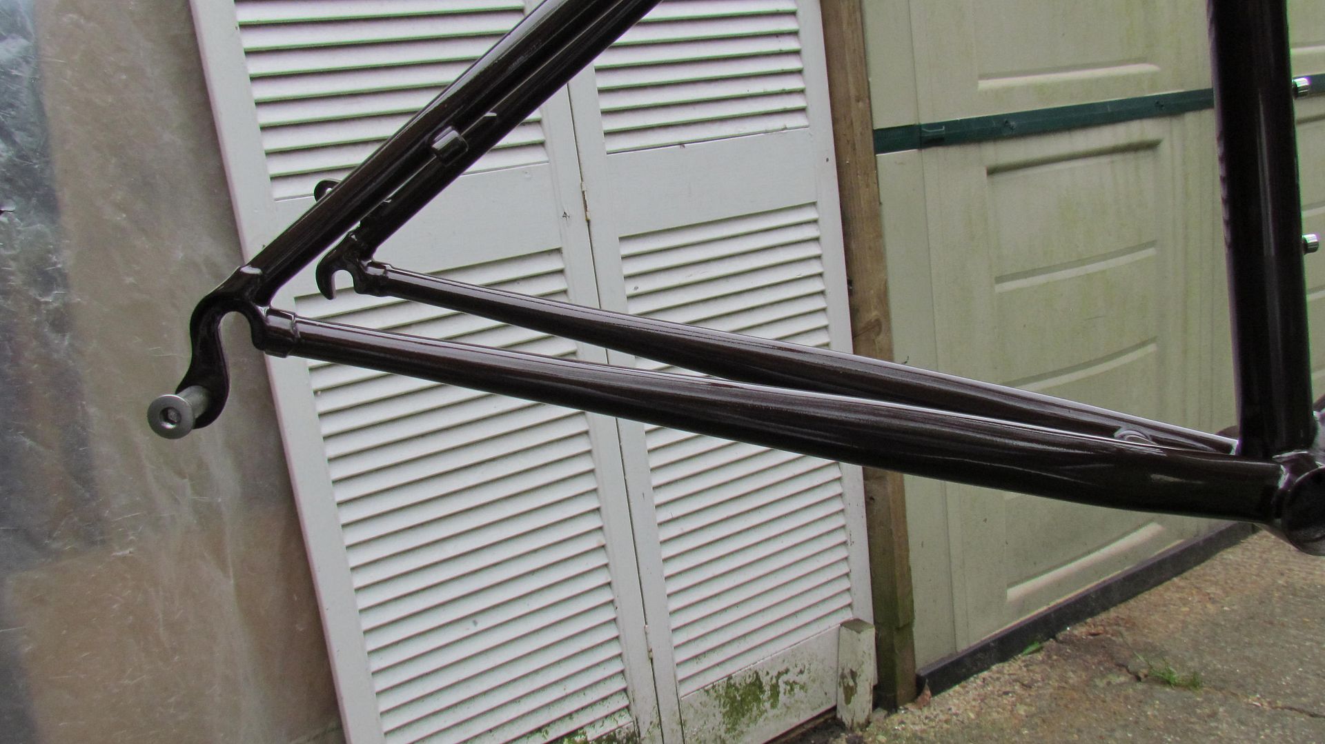

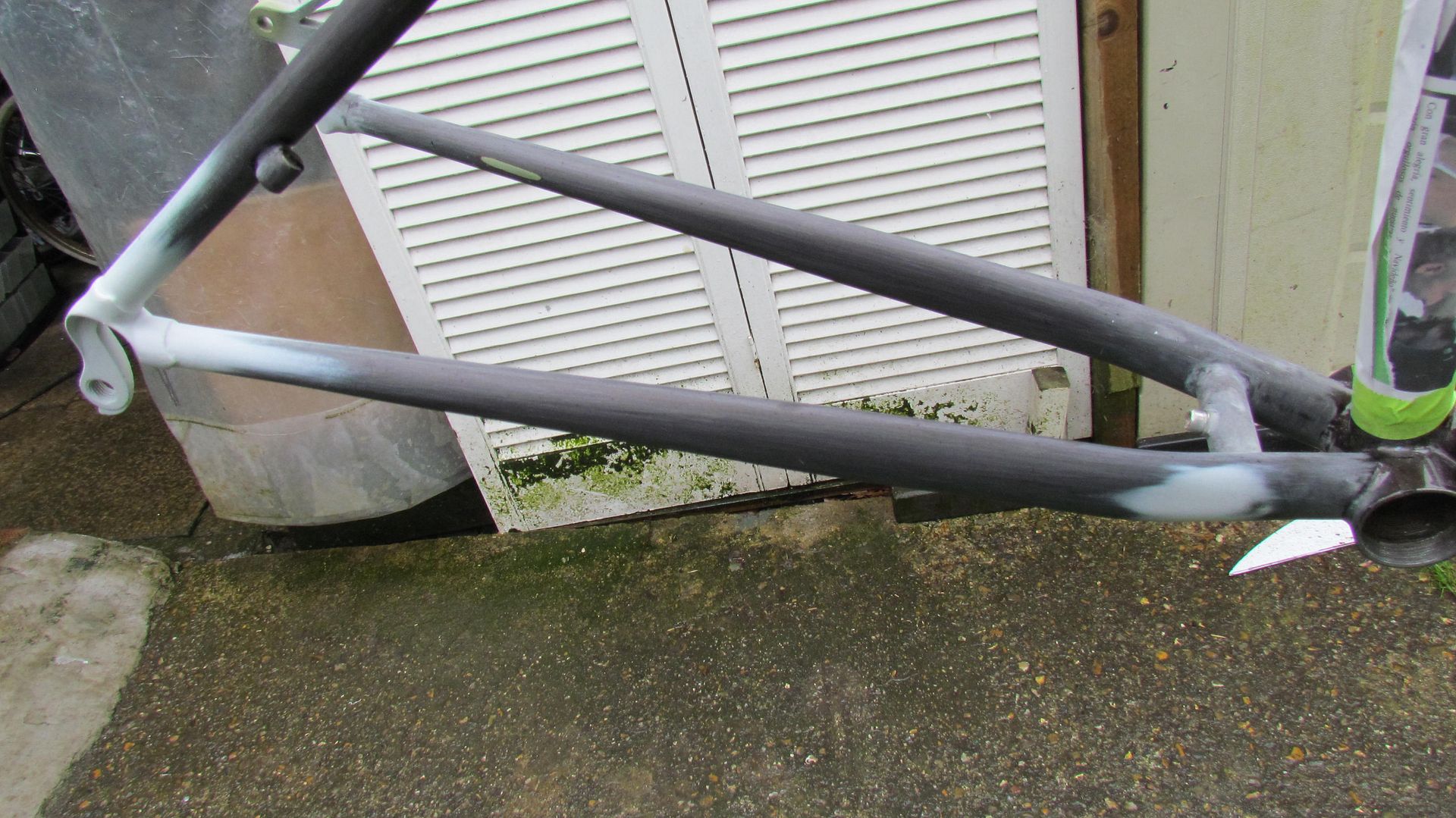

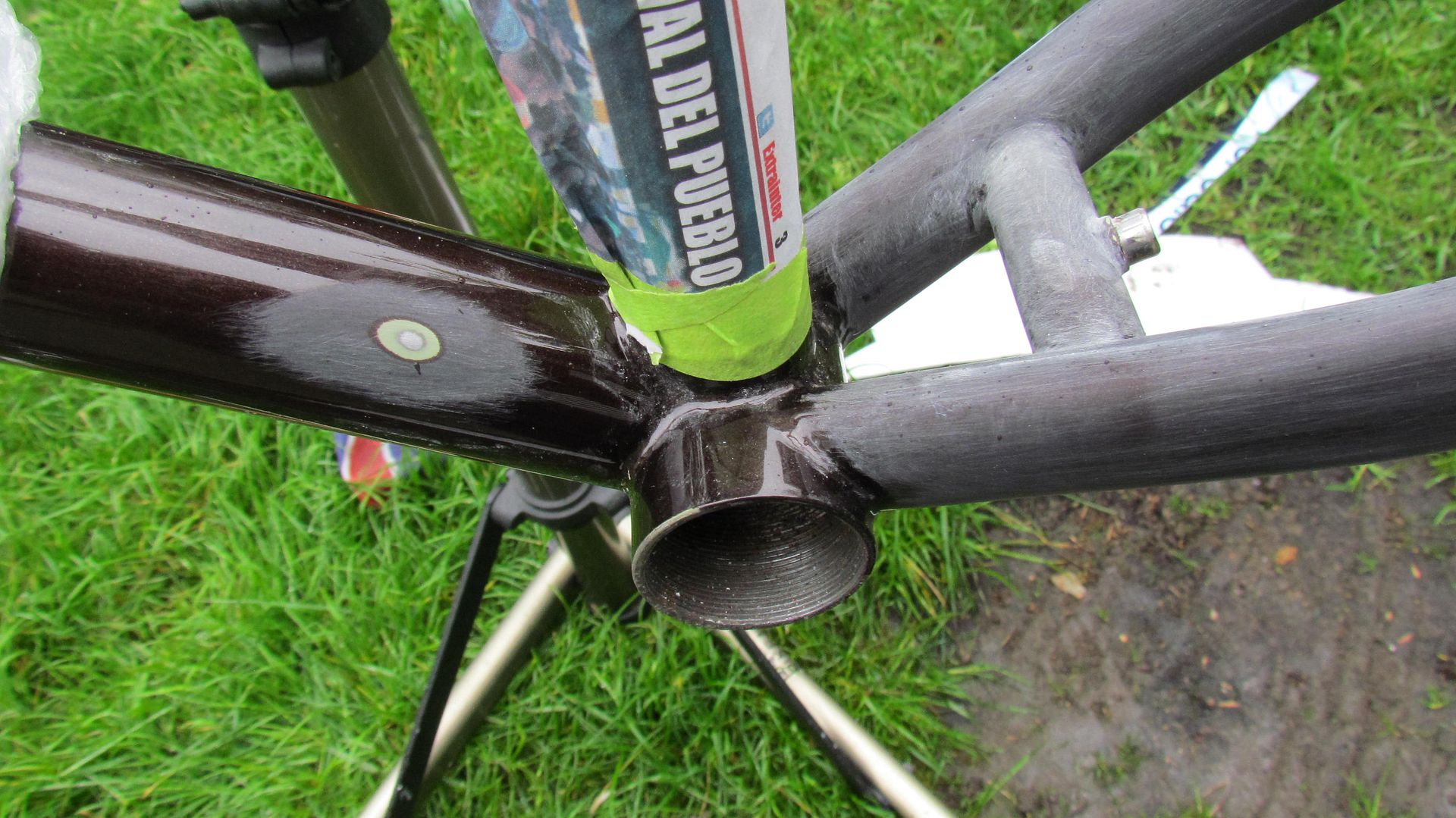

A week or so later Roly gives me a shout with the bad news - the drop outs are not repairable even with the application of a bit of gentle heat - its replacement time. Fortunately the Richtey hooded drop outs are still relatively easily available and Christian reckons it will be a fairly straight forward task with the caveat that its gonna damage that lovely Guinness Brown paint work. :( Nothing for it but to get it done.
So a little while passes, Im not in a hurry and this is being done on mates rates, Roly moves jobs and Christian's workshop roof falls in :shock: fortunately not on the Dekerf then after a flurry of mails some pictures arrive and the frame is ready for collection :
And Christian even repainted a chip :)
Maybe Christian should just take up painting full time?
End result is that I've lost nothing but a decal on the LHS seat stay, some time, and beautiful frame is back in business, and its impossible to tell where the old pain ends and the new paint begins.
Roly tells me Christian managed a similar job on a Roberts of his....
Life is good.
