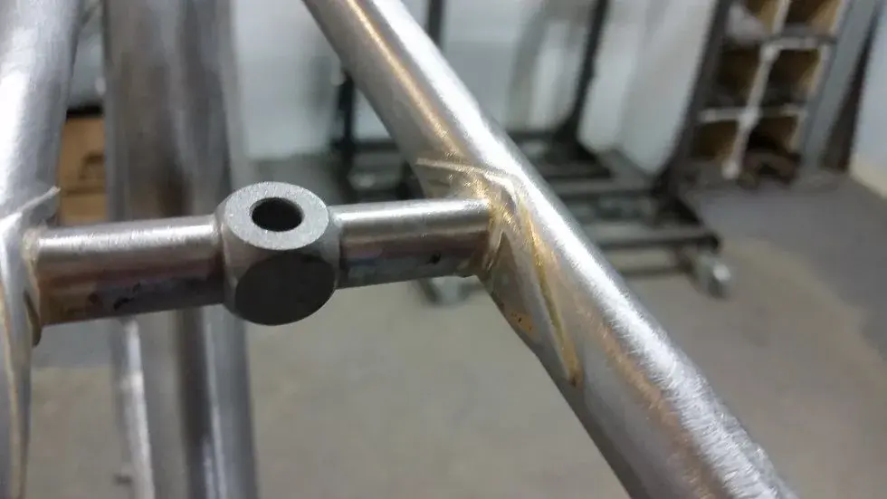

Firstly, despite assurances from myself that I'd be bugging them daily with questions and requirements, I couldn't make up my mind on what to make. Indeed, sitting there with a tea in hand on 10th November, there was almost an air of incredulity when I said 'I erm, dunno' after being asked what I wanted to build. No matter, we'd figure something! After a number of searching questions 'Do you want a Mountain bike' 'Erm, probably not' etc, we arrived at a Road bike, classic looks, horizontal top tube. This isn't actually true, as we ended up with a compact frame with all the right bits in the right place, but it was only at the jig where it hit me that the headtube angle was going to be a little slack at 72 degrees. The tutor agreed, so we altered it there and then and put that top tube horizontal, 73 degrees parallel.
File comment: Ignore the slight scorching...

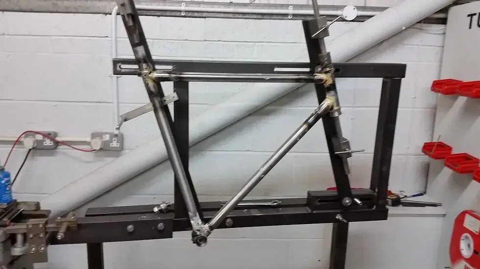

Having set up the Jig, safety breifing, having a factory tour, we were handed a set of Columbus Zona oversized tubing and some quite nice cast lugs. Unfortunately, no one had considered filing these to shape as this was 'our first job'. I only mention this as my skills with a hacksaw could hardly be described as 1337 (little IT joke there). My father, had always said I was worse than useless with any saw so this was all going to be a lot of fun, for others, at my expense probably.

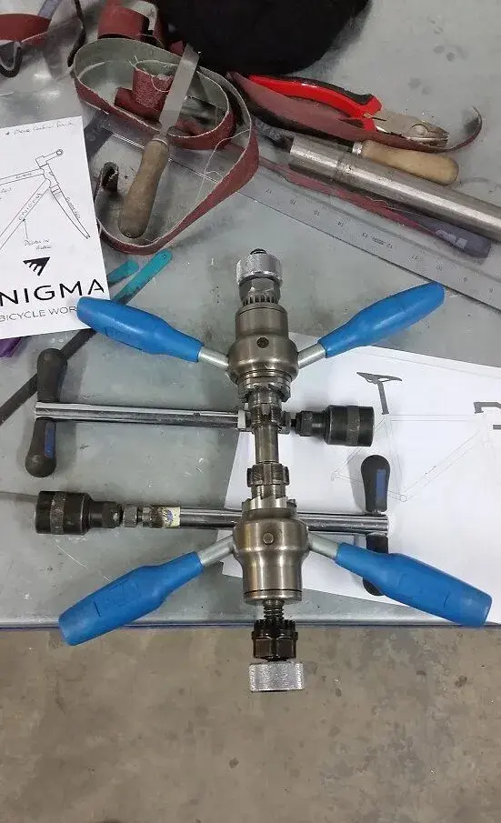

Day two consisted of more filing and brazing. Its fair to say it was a pretty uneventful day, albeit I really enjoyed just carrying on creating a frame. At the end of day two, the front triangle was in place and the bottom bracket tacked to all the tubes (BB would be brazed last) and I'd cut and started on the rear stays. Saving a lot of time, and to ensure the weld at the seatlug was OK, the frame was shotblasted on that lug. We also spent a bit more time tracking the frame, making sure things were straight as we went along. Thus at the end of that day, things were still on schedule.

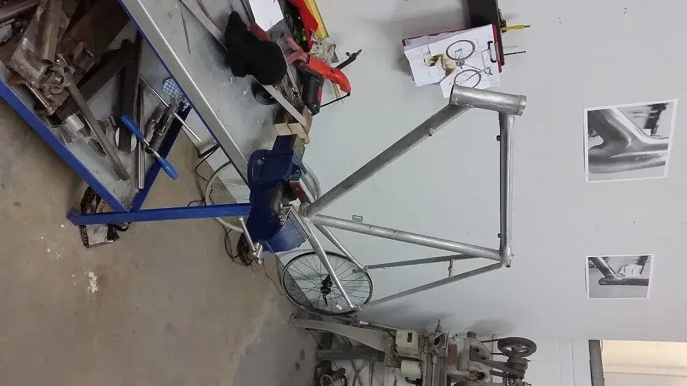

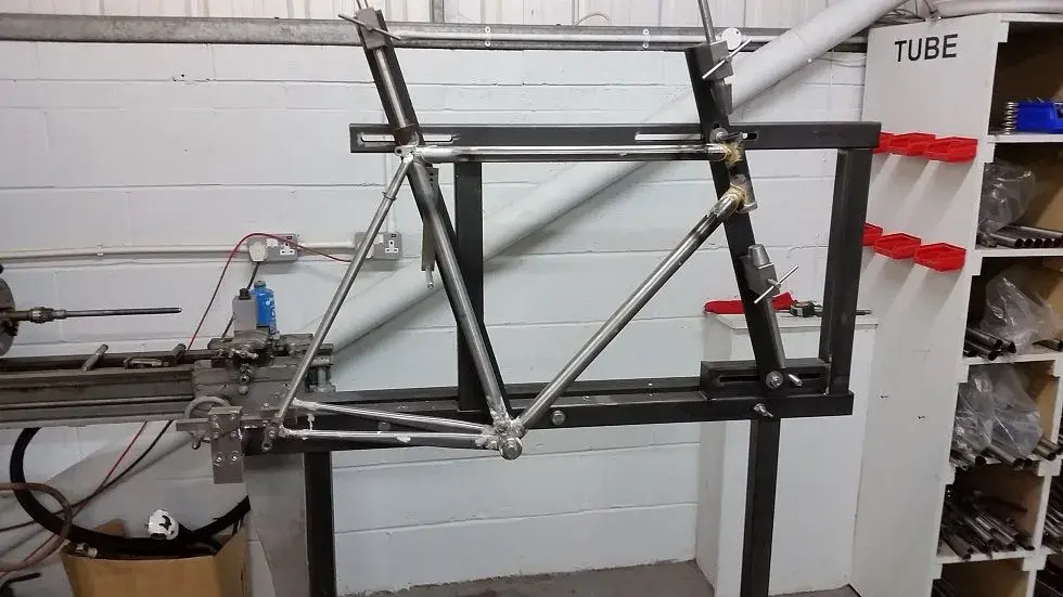

On day three, the rear stays were tacked in place, as were the dropouts. We proceeded to braze all that up (well most of it, a few wheel checks happened before everything was set in place) and again we tracked and brazed and repeated. Finally, we brazed the bottom bracket, which is one continuous task that takesa bout 15 minutes. Watching and feeling the BB heating up and staying warm was one thing, trying to repeatedly flow and chase Brass into it in 3d while trying to not wreck a tube was quite difficult. However, having done this, I had the basis of a frame and I still had a few hours to kill for that day as I was now ahead. This meant I could get on with some filing. Luckily, filing was helped by their being not too much excess braze on the frame and also the sandblaster made light work of flux and other mess. That said, we did filing with a big 'F'. Towards the end of day three, somehow, I was silver soldering frame add-ons, things were moving really quickly.

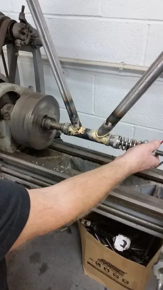

Day Four. Not a great day. I phoned in, reluctantly, apologising because I was really not feeling very well. I went back to bed feeling poorly and also feeling like I was missing out and had things to do. I took a few things to try and sort out my malade, tried to get some sleep and finally crawled up to my workbench around 2.30pm feeling a little better to do some more filing.
File comment: This is not my arm!
3 hours later, unbelievably, we were facing the Bottom Bracket, doing final tracking and we had a bike frame. In fact we were pretty much done with a day to spare. I had a finished article. As we approached the tracking bench for the final time, it was with some trepidation that we started measuring and levering the frame into its final shape. A bad weld, rippled tube, all sorts of things could potentially go wrong at this point. Luckily it didn't.

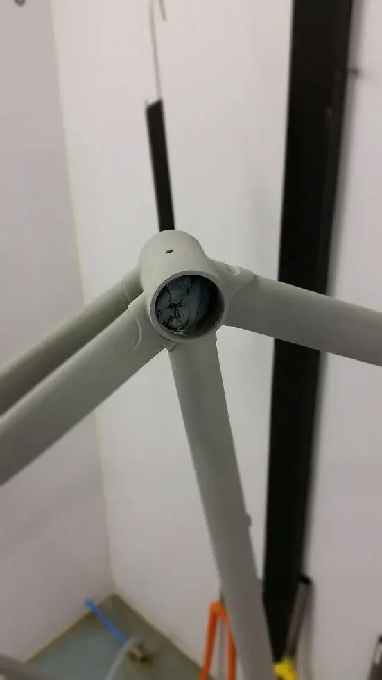

On the final day, we were invited to do a small bit of preperation in the paint room, which then saw us in the spray booth, putting the base layer of primer on the frames. Unexpected and not normally part of the course, it was a nice end to the week which made us feel that we'd contributed a bit more to our bikes.
So other than the downtube, nothing really went wrong. Also, its not that things go wrong, its not that they cannot be resolved, its just that you have a week on this sort of course and if it goes wrong later in that week, you have a lot of remedial work and re-doing things. There were of course the anecdotes of 40 years framebuilding, so you know that things can and do go wrong, but can usually be sorted. They also claim they aren't letting you go home without a frame, which is a reassuring touch.

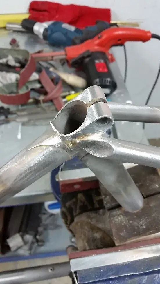

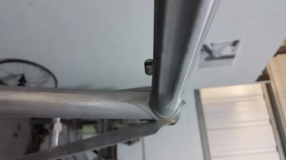

And finally, the frame. Its a Columbus Zona tubed frame, 73 degrees parallel tubes, horizontal top tube. The top tube is Columbus SL but it is a Gilco styled tube. Due to the fact it's in an oversized frame, that tube is actually a downtube. The fittings include downtube shifter bosses, under-tube rear brake cable, Front mech hanger, chain hanger and a lugged brake bridge. Rear dropouts are Ritchey. The forks (not shown) will be oversized as well with a sloping crown.
PLEASE NOTE: The frame pictures are taken at various stages of build, they are largely in sequence, but may be out a bit. Finally, the frame was sanded, smoothed and cleaned prior to paint and after pretty much all these pics were taken. I don't really have a lot of pics of it at that point.
