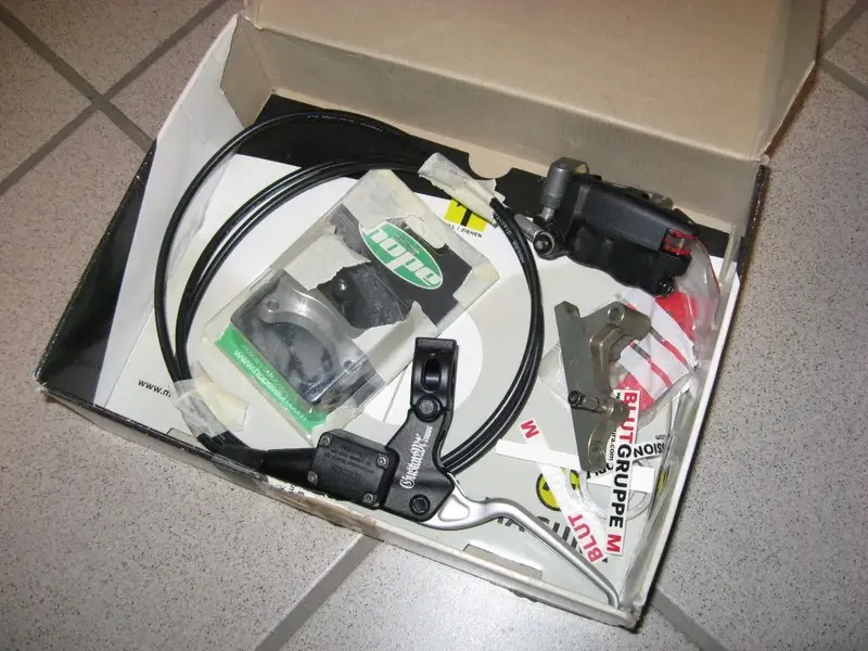

Inside, quite a lot of goodies: a frame, a fork - not, let's say 'THE FORK!', couple of wheels, brakes, and so on.
The journey had just started!

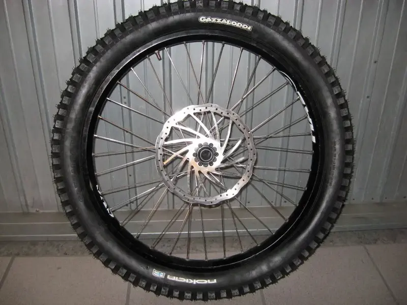

first, a look at all the contents:
File comment: the frame
File comment: the fork
File comment: wheels....

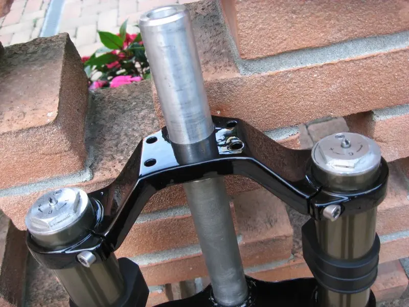

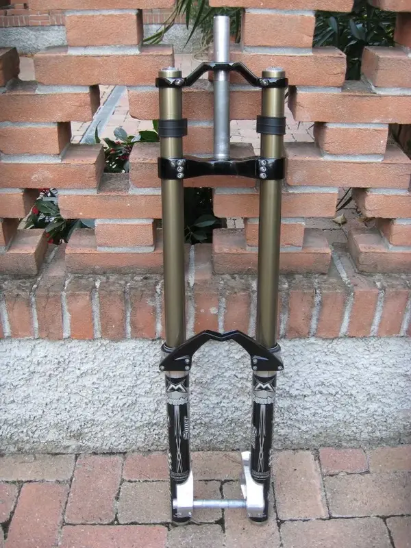

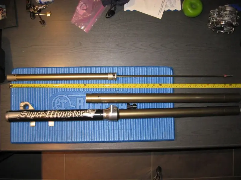

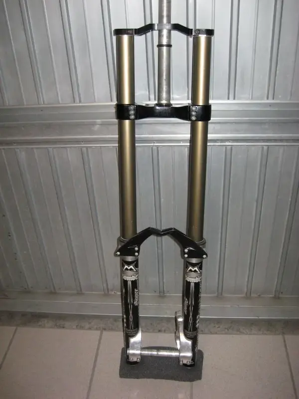

I started from the fork: dissasembled it, cleaned, examined all parts:

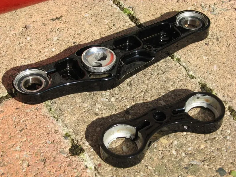

Mechanically it was more than Ok. However, the top crown had been substituted with a previous year one ( pre-2003) and, since it had a little different rake, it was really hard to mount and somehow twisted the structure; moreover it would not permit to mount a direct mount stem. also the lower crown had the steerer elongated by inserting an extension: I would have to see if it was strong enough.
so, for the fork, the plan was: first wrap the sliders in helitape, then reassemble, search for the corrrect upper crown and for the direct mount stem.

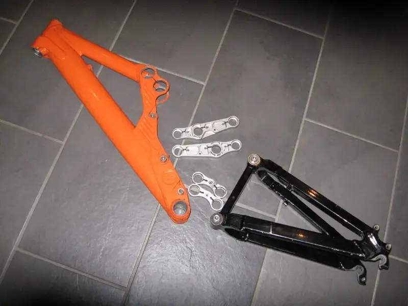

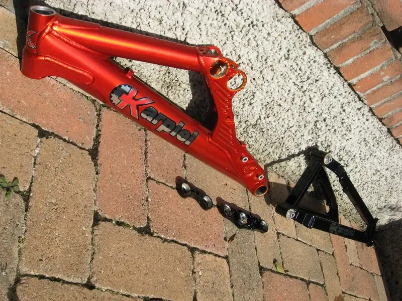

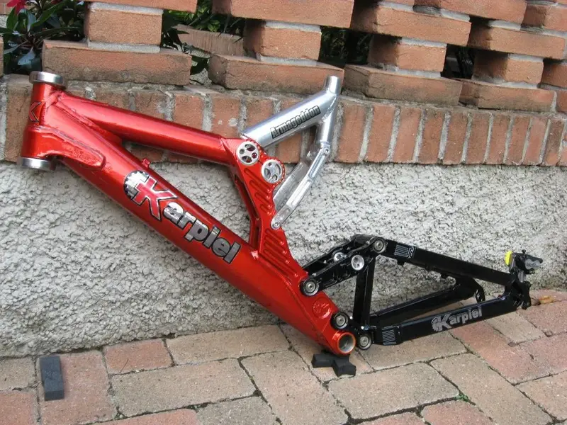

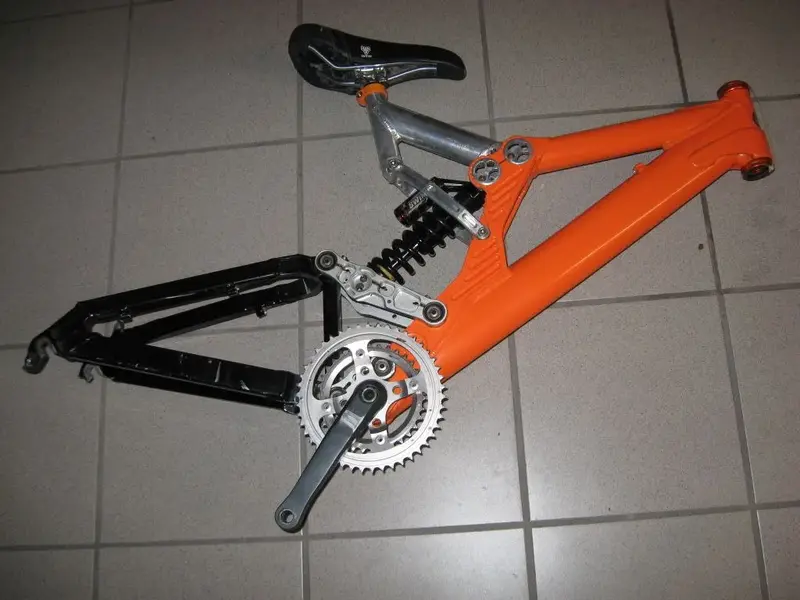

Next, frame analysis came.
File comment: the dissasembled frame

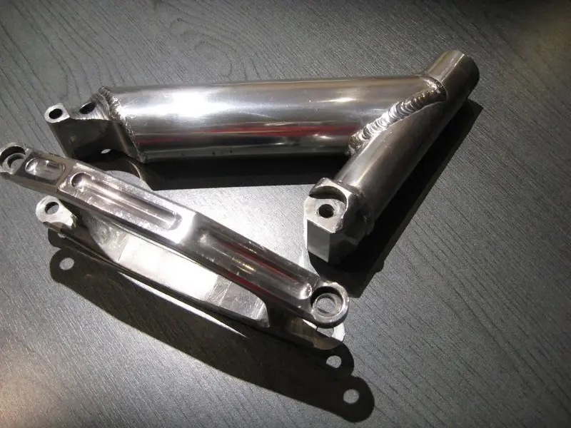

The frame was OK:
no dents or cracks, apart from some minor cracks on one of the linkage plates. It would have to stay that way, until I could be able to source some new plates ( almost impossible these days, even after trying to get in touch with the CNC machinist who carved the original plates).
Even if the original paint job wasn't at all ruined, I decided to have it refreshed with a new deep glitter orange spray, and went with black swingarm and black linkages.

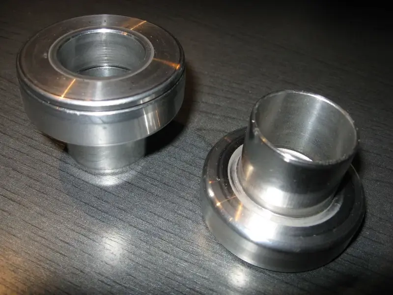

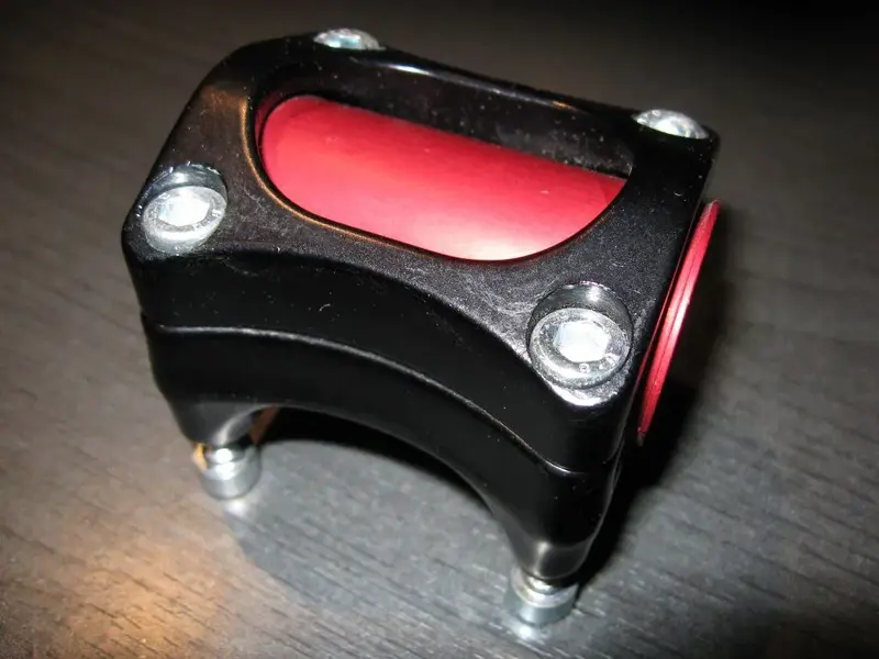

In the meantime, some parts were collecting at my home: direct mount stem,
a new headset ( Nicolai stainless steel FettSet),
File comment: headset
new bearings for the pivot points.

Also, cleaned the linkages:

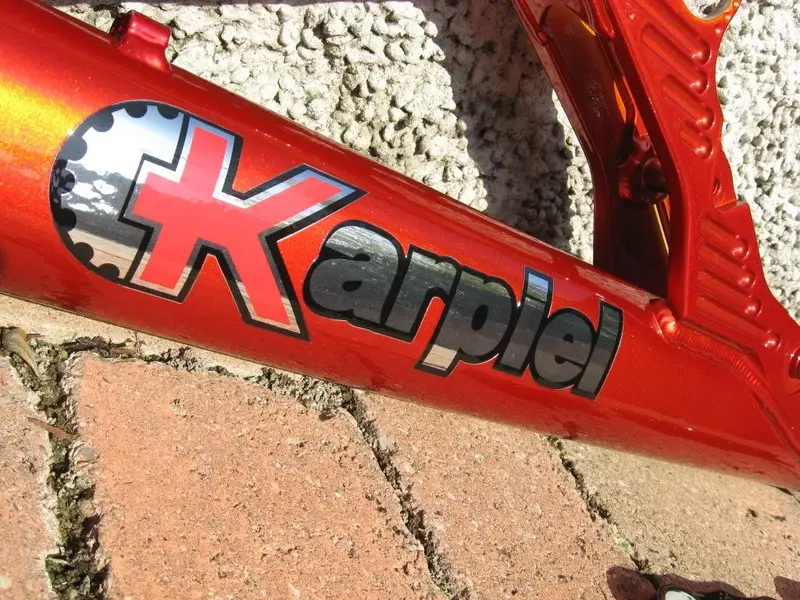

On the 7th, I got the stickers back from the printer ( I got a few sheets done, just in case...):
so I could get the frame to the body shop for painting.

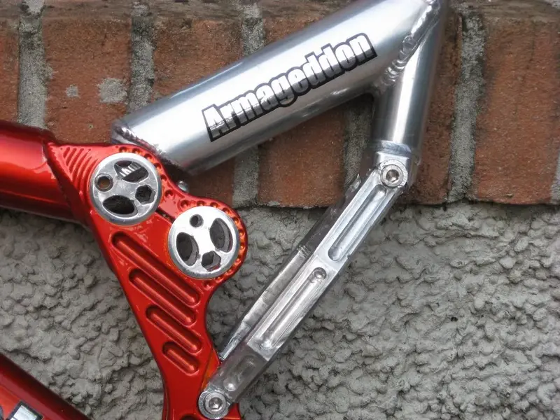

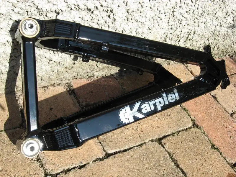

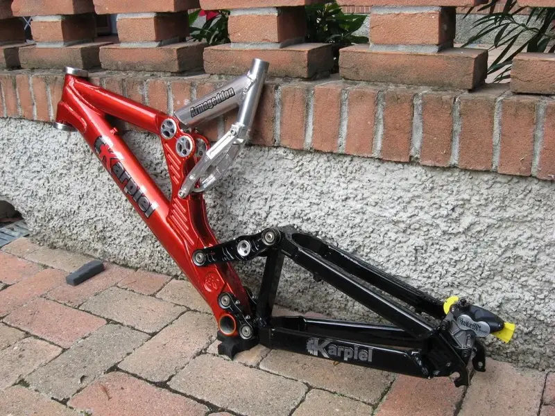

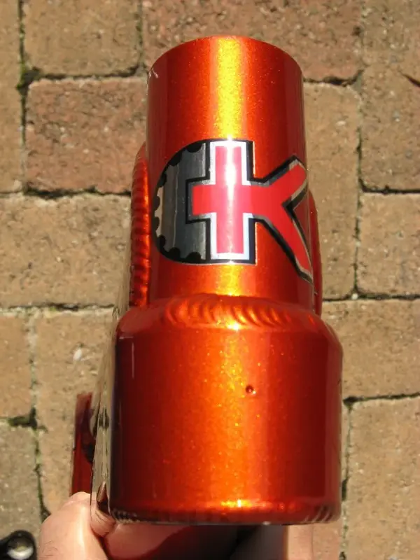

The frame came back on the 12th of October ( the day of my injury):
Decals aren't too bad, IMHO:
The frame colour in person is quite a bit more orange-y than it shows in the photos.

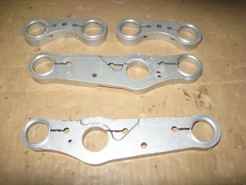

In the meantime, to solve the fork upper crown problem, I located in UK a pre-2003 Monster T that was somehow installed with a post-2003 upper crown. Needless to say that I bought that fork, and swapped crowns. Here it is the SuperMonster T with the correct crown:
The frame back together, headset installed:

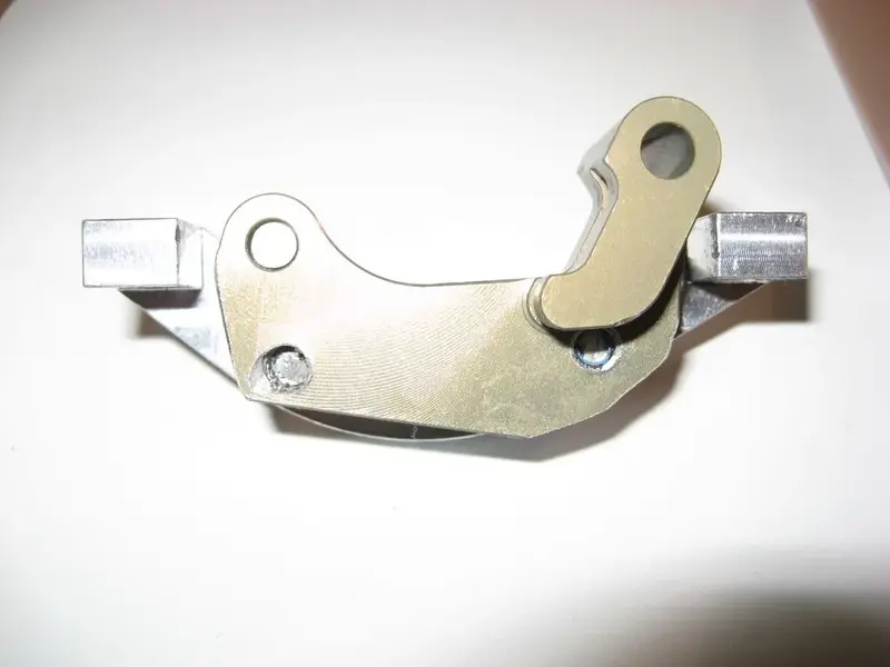

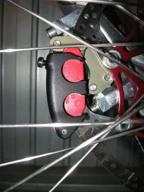

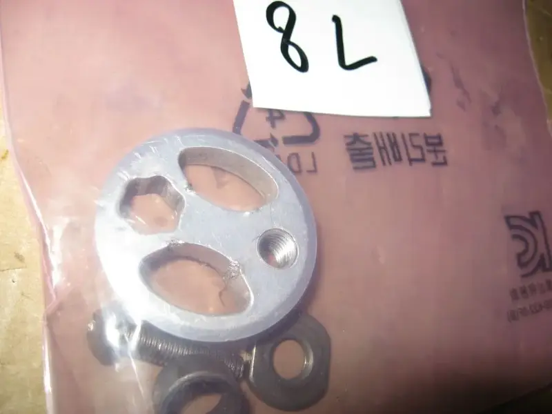

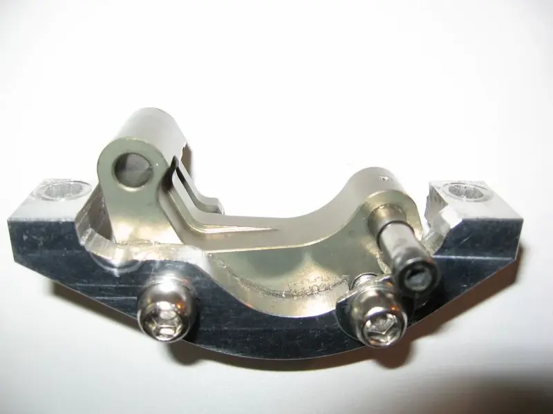

As you can see, rear brake is no problem - I have enogh brake adaptors to use whichever rotor size I wish.
Front brake, is another issue altogether. Magura Gustav don't have IS or PM mounts, instead the caliper 'floats' on a saddle that sports the frame mounts. You choose your rotor size, the type of fork mount ( IS or PM) and order the correct saddle... at the measly sum of 55 GBP upwards!
That is, when Gustavs were the norm on DH sleds. Right now, since they have been discontinued for three years at last, those saddles are rarer than unicorn's horn powder.... not to mention the pounds you have to part from when ( if) you find the correct one. I had one of those PM saddles from Dan28, but it spaced the caliper too far from the disk.
So I had to use a little lateral thinking to mount a Gustav caliper on my SuperMonster T, with a fork mount PM fitting for an 8" rotor, and using instead a 9" disk.... are you puzzled? so was I, until I found in Germany an adaptor that may be of some use.
So, after a few more days of waiting, by combining these:
with a little ingenuity, some swearing, couple of drills and files, I concocted THIS:
that does THIS to the caliper:

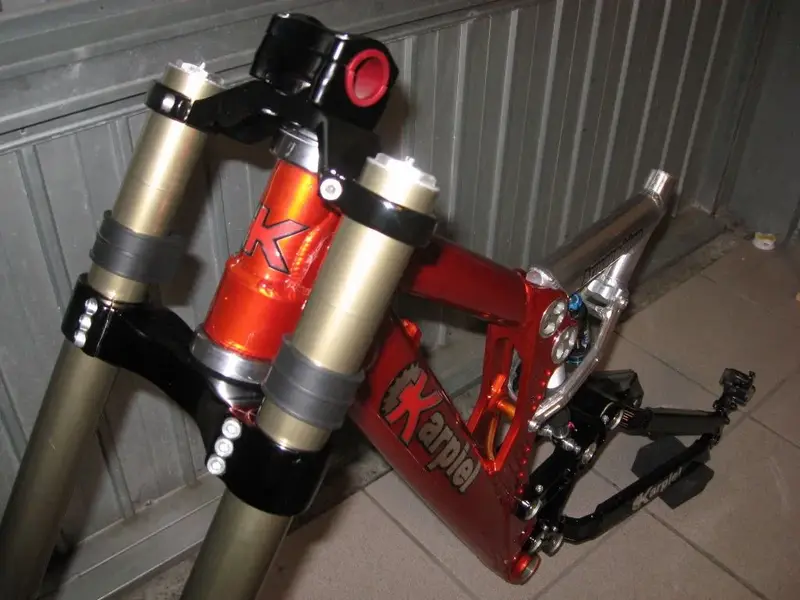

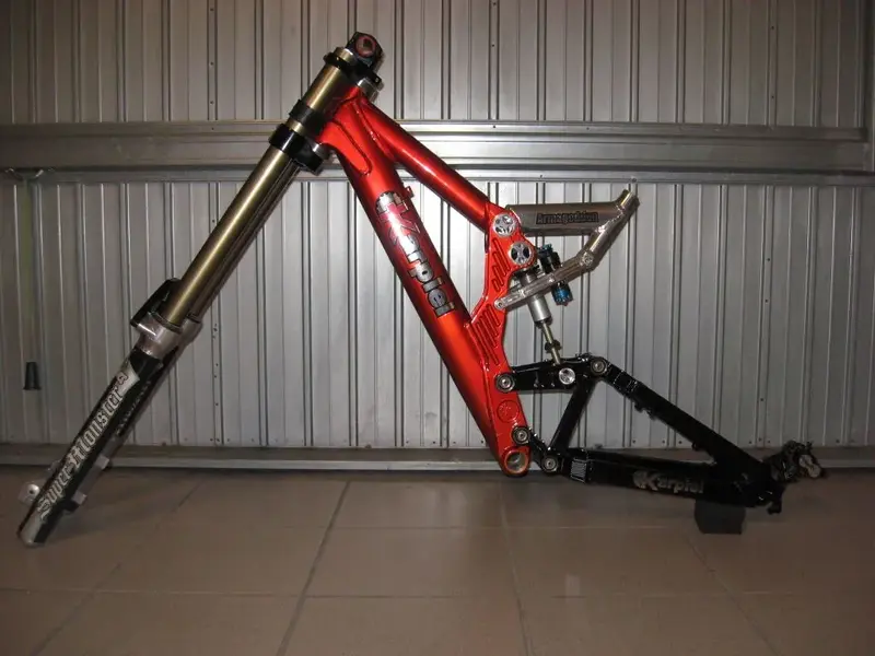

Let's go on......

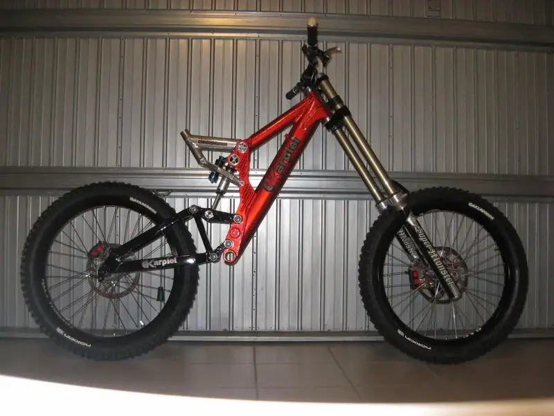

Couple of shots of frame & fork together....

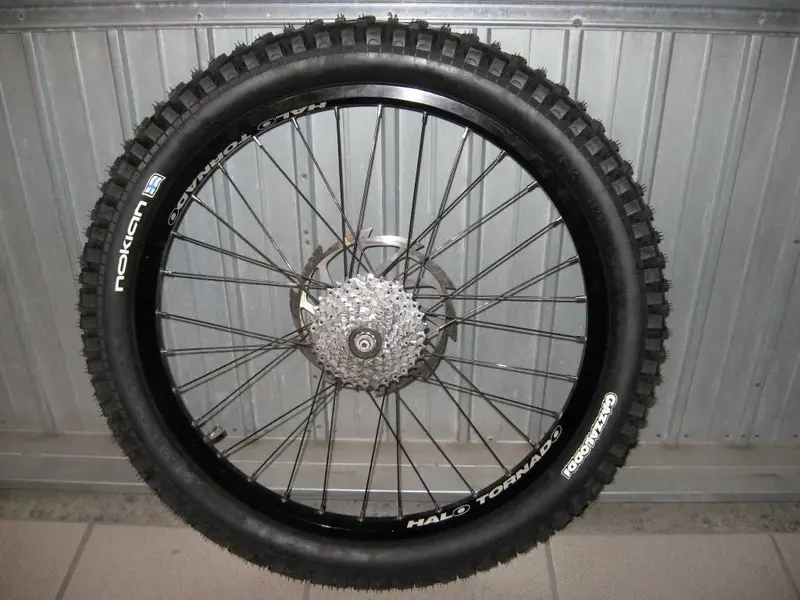

And a quick dry setup with wheels:
For today, it's all, folks!
