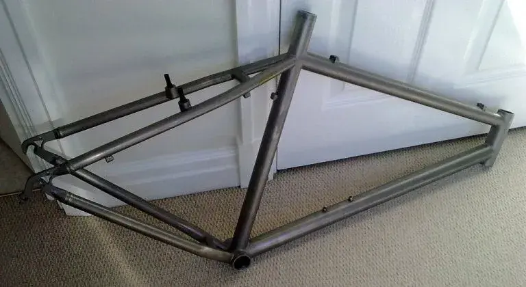

Bought this 19" Kona Hei Hei bare frame a year ago. Living abroad it's taking me a while to source the parts i want and fly them over in my luggage, but i'm determined to get it finished...one day!
Originally owned by a tech at Singletrack Cycles in Gloucester, then sold to it's long term owner who raced it extensively over the years before selling on ebay. I bought the frame from the ebayer who bought it to strip and sell off the parts (shame really...). I learned it's origin by using ebay history to track down the long term owner and find out from him that it's a genuine bike, not stolen. He even had the original laminated owner card and handbook.
The frame is a 1999 but the owner removed the decals and red paint from the headtube when they got tatty, the red overspray residue is still visible inside the headtube, so no doubt about the year.
This Hei Hei will get mostly new parts so it won't be pure retro but it will retain it's classic looks (no discs or modern fork) and hopefully will ride like a new bike :D
Here goes then...

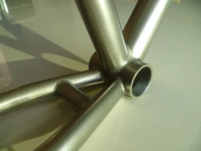

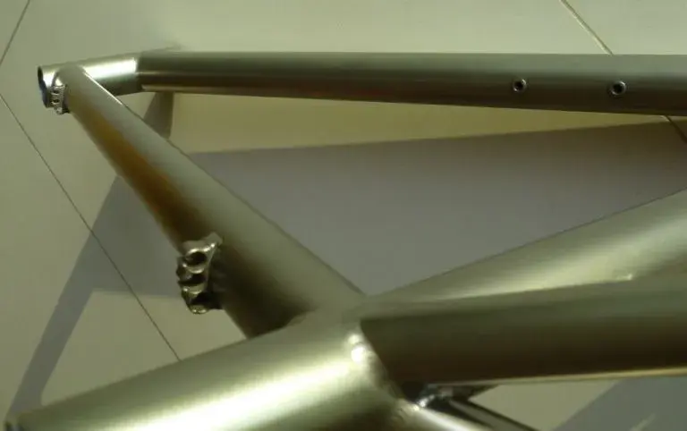

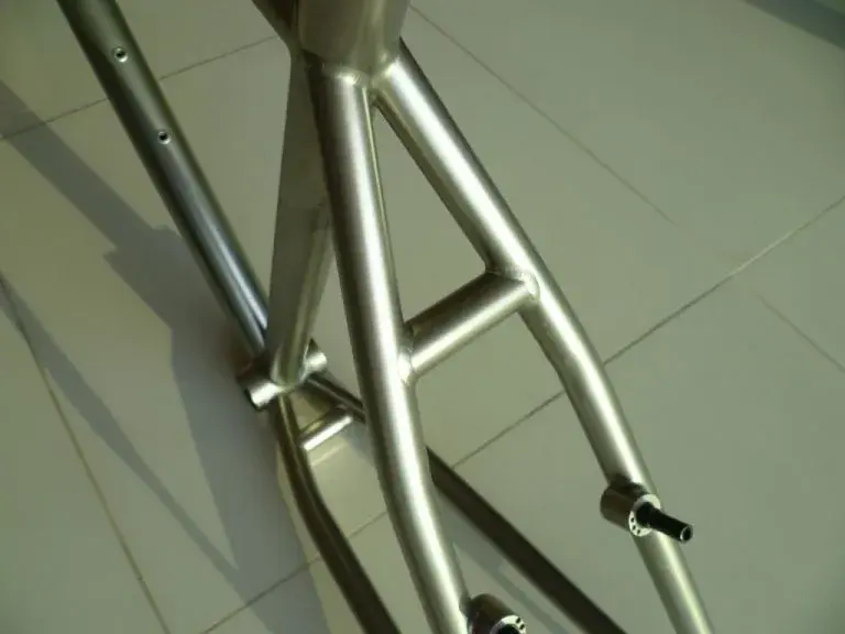

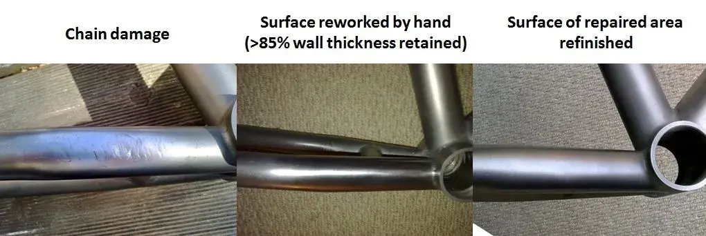

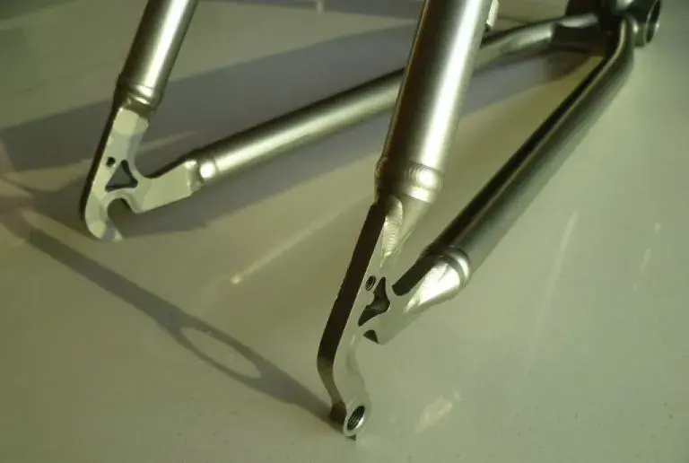

Before kindly delivering the frame to me on a visit my father (a retired RAF jet engine technician and engineering instruction manager) hand worked the chain suck damage to remove potential stress points and restore the surface. To even up the finish of the frame and get rid of old decal discolouration and cable rub i polished the entire frame with autosol. This had the effect of brightening up the original matt shot peened finish to a velvety lustre. I'm happy with the result and the fame is now ready for building up.

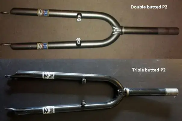

Woz":3jl8bfj3 said:
What forks you thinking of?
Hi Woz. Took a while to settle on a fork. Started with thoughts of disc conversion and modern fork, then went hunting for a quality 1300g air fork with v bosses but couldn't find anything brand new (Floats, SIDs and Durins no longer coming with v bosses for example). Finally decided for unthreaded rigid P2s. Bought a double-butted P2 but was suprised by the notable lower quality and higher weight than the triple-butted version, so finally found a TB P2 with the nice dropouts and enough steerer length. I'll have to build the bike with the DB then swap for TB once i get a chance to reach UK and pick them up. The Hei Hei was built with black rigid fork back in '91 / '92 (see below magazine extract from '91) so my build will pay homage to that earlier layout...unless anyone's got a Ti P2 needing a new home?
Started fiddling with a test build.. i'll post another update when i get some time..

The difference between a CM and TB is really notable isn't it? It's most apparent in the handling differences. The TB is lively and responsive, the CM is dull and uninspiring. It's amazing what a difference to weight and construction can make. Any plans to tidy the fork up a bit?

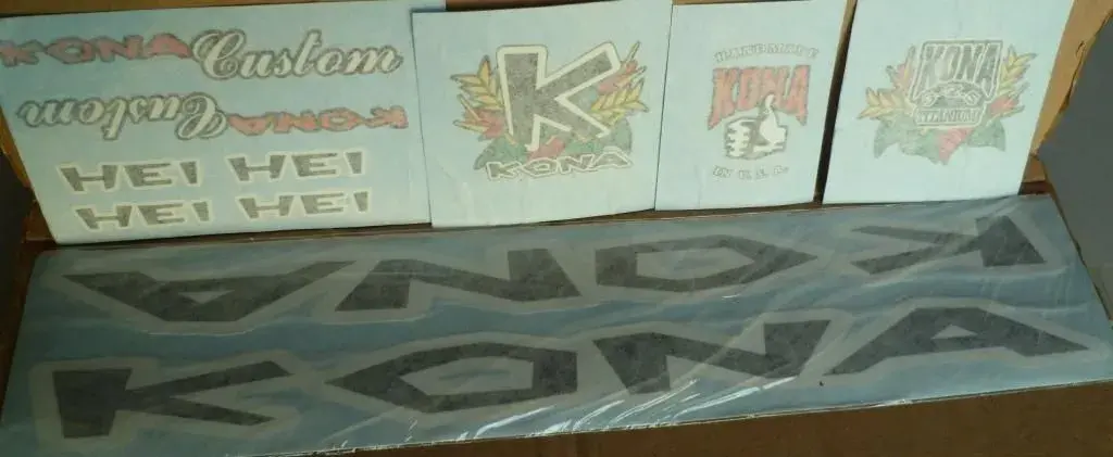

Hi al-o, i'll probably improve the fork in a similar way like the paint on my CinderCone. Yes agreed the '99 colours look good, but i also like the simpler design of the '98 and since the red paint is aready gone i have decided to replicate the '98 design. I already have the decals:

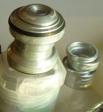

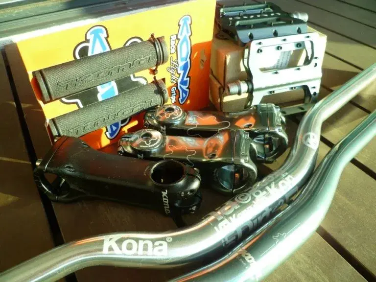

Keeping the Kona feel with the P2 fork but also some Kona cockpit parts. Got a few sizes and colours to play around with and find a nice combination:

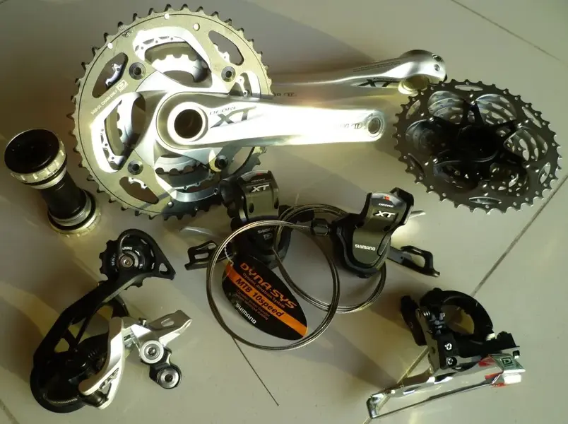

The Hei Hei will get this new Shimano XT 2013 3x10 groupset:

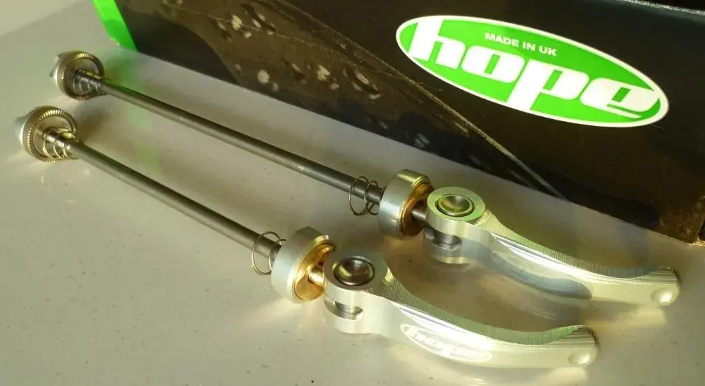

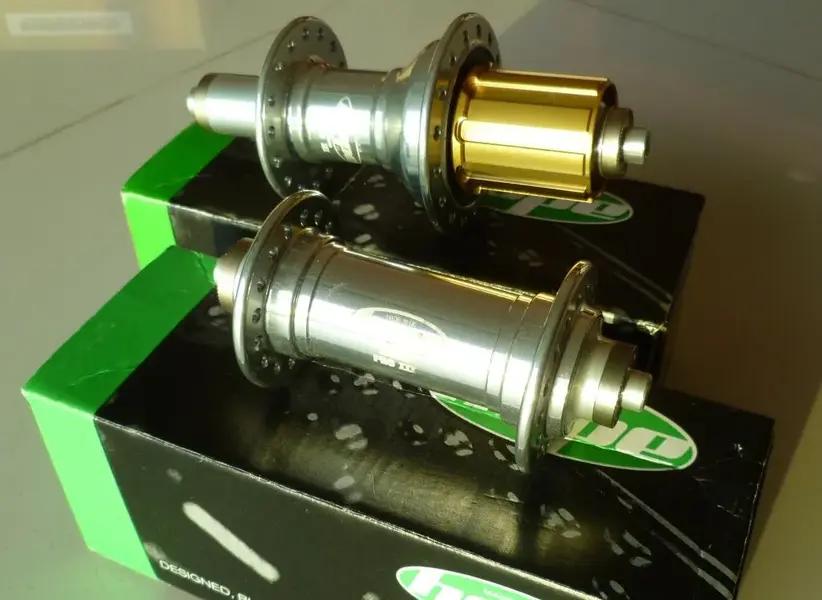

Some nice shiny silver parts from Hope:

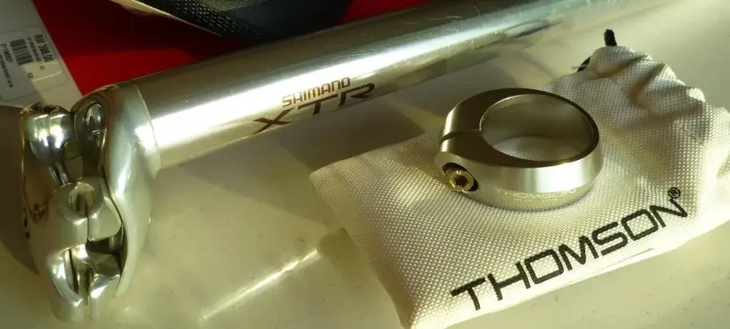

After looking for ages i finally found a nice used Shimano XTR 27.0 post which will be held in place by a Thomson clamp (i didn't like Hope's clamp design much):
Hopefully i did my research well enough that all this stuff fits together.. :eek:
